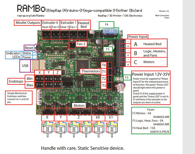

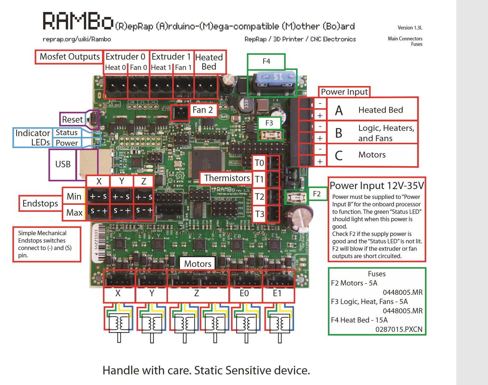

I see the Rambo 1.4 board supports some fans.
There is some warning that most of them are not used here:
(https://www.v1engineering.com/wp-content/uploads/2017/11/Rambo14-DUAL-help-fixed.jpg)
Are they disabled perhaps in the firmware?

The wiki here: Rambo v1.4 - RepRap
is about all I can find nd says only:
“Extruders + fans and logic, 5A 12-35V (fuse can be exchanged for up to 10A capacity)”

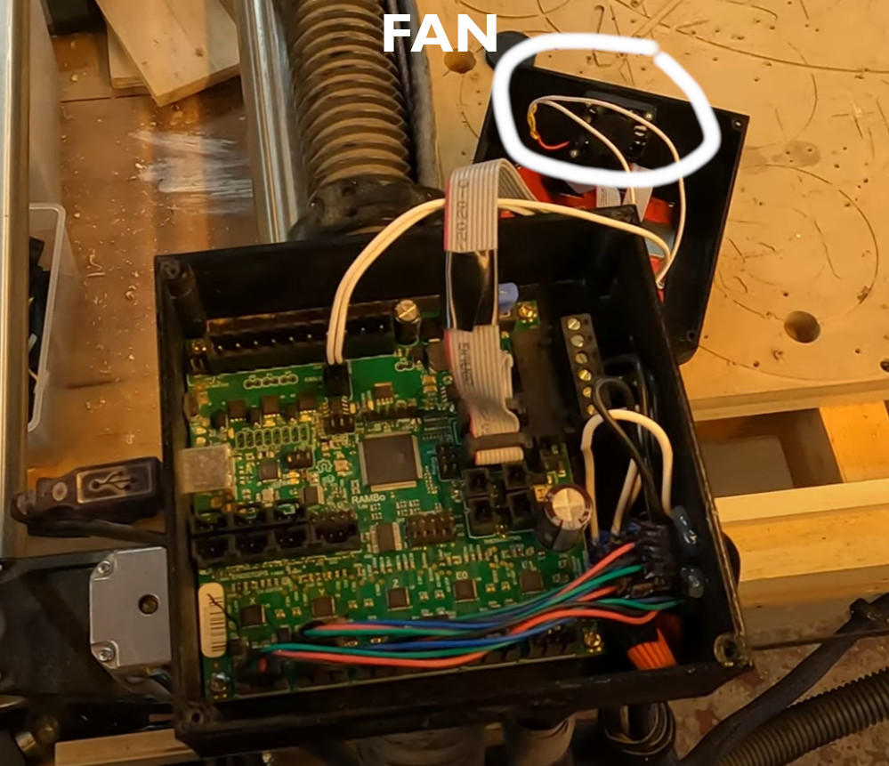

I’d been using the direct-to-power-supply setup for my fan since I first set up my LR2 but finally got up the nerve to do a proper fan setup.
Now my fan turns on when stepper motors are engaged and turns off 1 minute after the stepper motors turn off. It doesn’t change airflow but feels more like the way it’s supposed to work :slight_smile:
I’ve got my fan connected to Fan 2 as seen in the vid here (top/middle white wire pair): Making a CNC Z Probe - YouTube

Good plan. That’s exactly the route I went and given that I turn the machine and steppers on at the beginning and the steppers don’t shut off until I park the machine at the end it’s functionally the same. Part of the exercise was to try some small firmware changes before I moved on to the z-probe stuff.

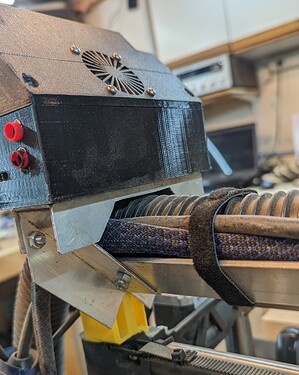

The fan is attached to the top of the enclosure. It’s lying on the spoilboard in this photo:
The enclosure is mounted to the angle iron like this:
If I were starting again I wouldn’t use this enclosure design.
