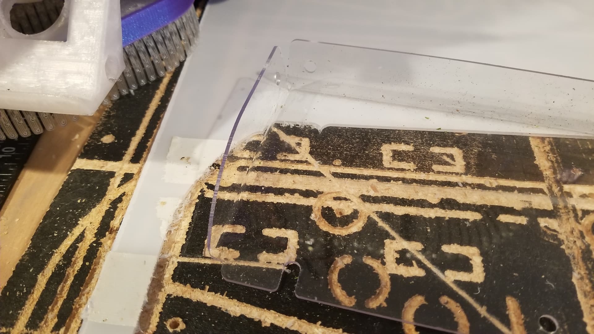

Curious what tips people have for quickly smoothing edges of 1/16" or 1/8" thick CNC cut polycarbonate? Search/AI is suggesting MAPP gas or sanding, but I’d appreciate ideas from people here.
Also, am looking for ideas to cold bend polycarbonate to precisely 90 degree angle (1 degree tolerance ideally)?
Am currently using a $75 harbor freight metal brake limited to 90 degrees, so, since the polycarbonate springs back to less than the brake’s bend capacity… Am currently jankily adding additional jig/wedge to the bend brake so that the plastic gets over bent and will then spring back to (very) roughly 90.
I don’t want to mod the brake with an angle grinder just yet to support over bending…
Am striving for being able to cold bend polycarbonate parts in a few seconds rather than do slow heat softening/forming.

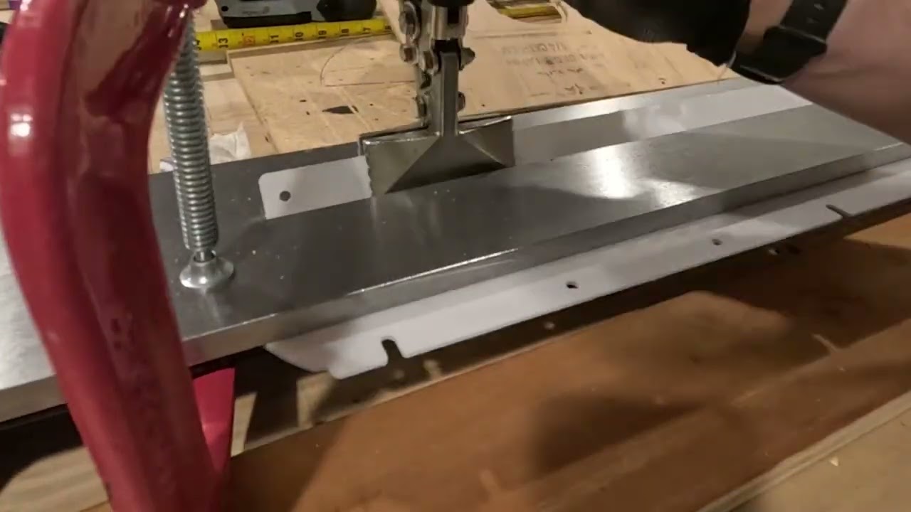

Much faffing in this 10x sped up 1min clip, there’s got to be a better way…

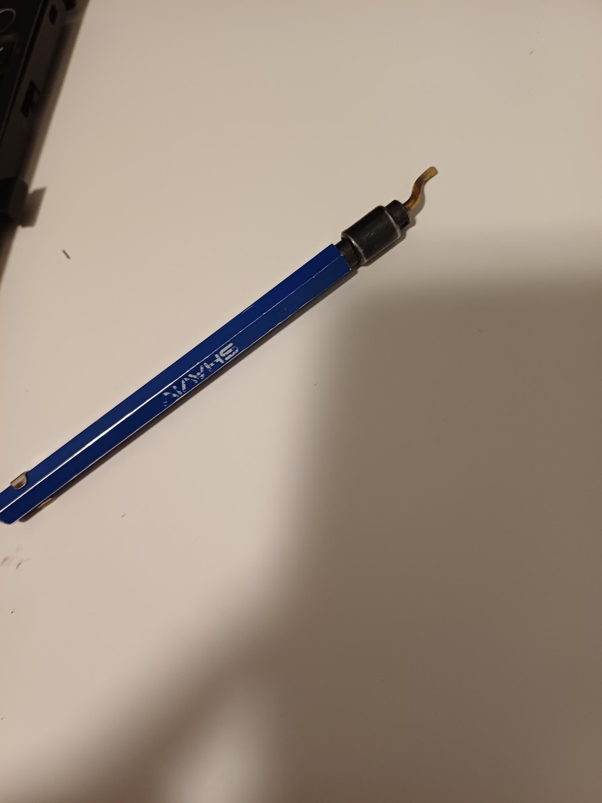

This is tool I use for edge smoothing. (Sorry I don’t know the english name for it) It works for wood , most plastics (3D printed also), aluminium and even s355.
I belive it is called a deburring tool (or deburrer)
I Was thinking those names, but I was not sure :slight_smile:
