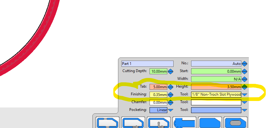

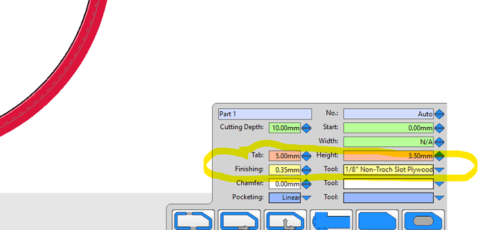

There’s a walkthrough here
That includes
“The next cut will be a pocket taking the whole surface down in 2 steps, a rough and finishing pass.”
Open the cutting parameters box by clicking on the individual path (or on the search icon to the right of the tool details to select all paths using that tool). The path(s) will become red.
Enter a value in the “Finishing” box (usually about 10% of the cutting tool diameter) , then select a tool (usually the same as used for the cut) in the corresponding “Tool” box
The finishing pass behaves slightly different if you forget to specify the tool. But any finishing pass is shown on the tool path. So if you want to undersize or oversize the hole/part you can play with finishing passes. Useful to adjust holes for tabs based on actual stock thickness. If you enter a large value, you’ll be able to see the effect in the Preview.
