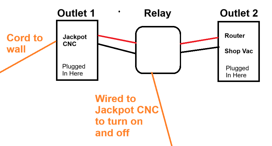

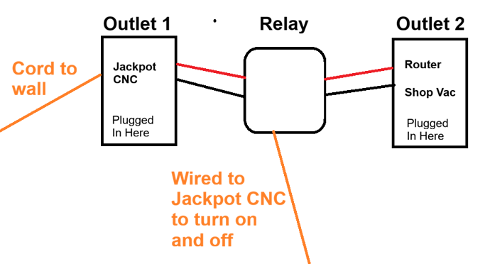

My plan is to have two electrical outlets, wired together with the relay in between. The first outlet will have the Jackpot CNC in it and will always be powered. The second outlet will go to the relay then to the first outlet.
Does this seem sound? Here’s a poorly made diagram in paint if my explanation up top wasn’t good enough.

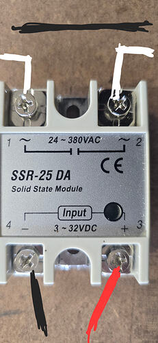

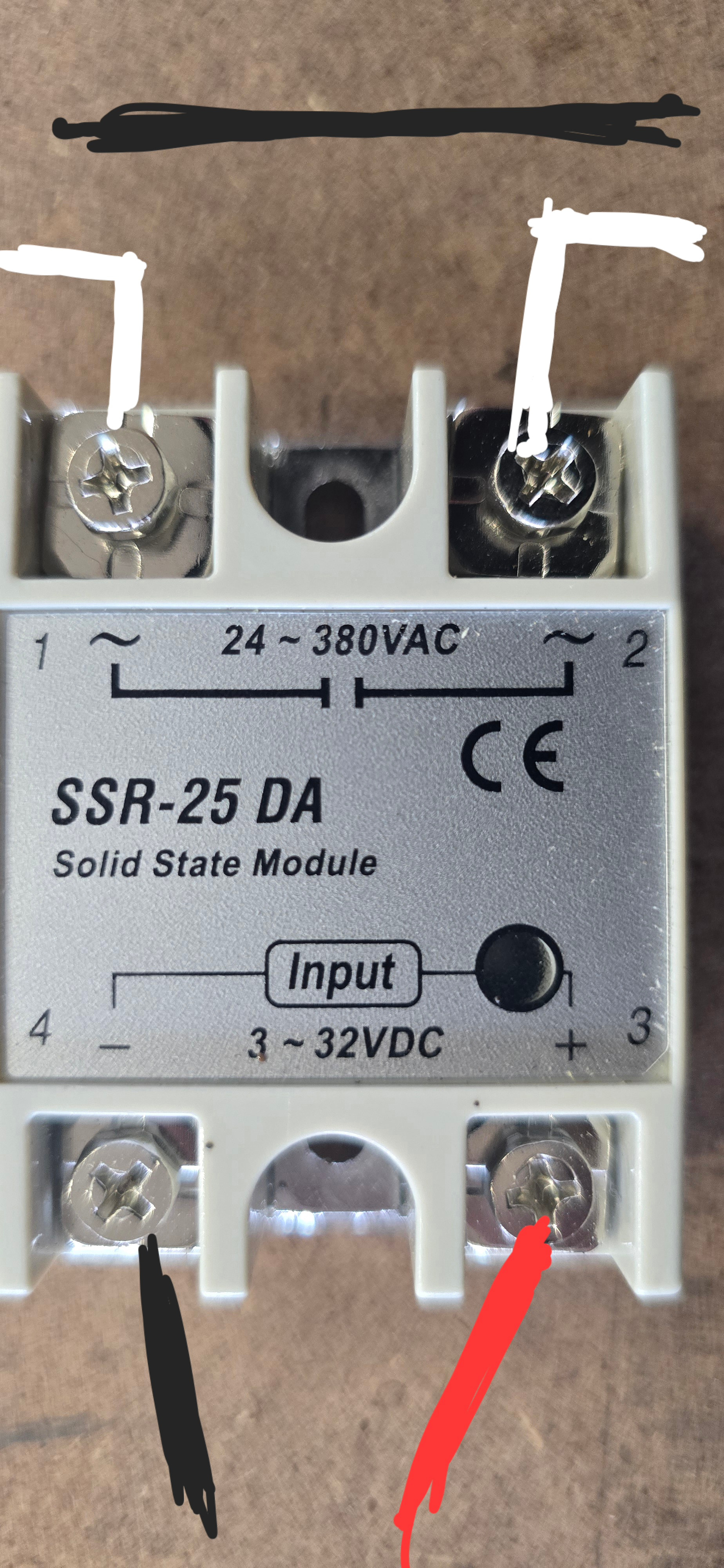

Power comes in from the wall on pin 1 then out to the tool on pin 2. White is the ac wire and the black is bypassing the relay but part of the same ac cord
Red comes from io on the jackpot and black goes to the corresponding - on the jackpot.

@spsully2582 - I respectfully suggest switching the colors you use on the top of the image. Generally (in my experience in the US) the black wire is the hot wire, and the one you want the relay to switch. White is the neutral. While wiring as originally diagrammed will stop and start the device downstream of the relay by preventing returning current on the neutral, there will always be power flowing to the device so terminals in the circuit will be energized and at risk of shorting out or causing shocks. By switching the black/hot wire, that danger is removed..
I agree and that was a good catch. I would also note for anyone trying to do this, that not all wiring in all houses was done to the same code and same level of skill. While both will work because AC, it doesnt mean your black or white is the neutral. With this being in a power cord, then @ttraband would be right 99.99999% of the time.

Isnt the bottom heat sink on on the relay (center bolt hole on both sides) ground?
Yes, ground it to the metal chassis somewhere, but don’t connect it anywhere to the DC side directly. That can create ground loops amongst other things.
When looking specifically at the switch there’s no need for an earth because it’s all isolated. If you’re running the SSR in a non-conductive enclosure, there’s no need to earth anything on the SSR itself, you just need to make sure that the ground is continuous from your input through to the load, in this case the router. If you were controlling something with no earth (like some LED lights or an isolated power supply) then you wouldn’t need to bother with this.
If there’s any metal exposed that may become live in case of a damaged wire or anything like that, that’s what you would earth. Examples of that would be a metal enclosure, an exposed metal heatsink sticking out of a plastic enclosure, etc. It’s good practice to earth everything at a star point such that it’s obvious and easy to test for when the enclosure earth is disconnected. It’s also good practice to retain cables such that a connector or joint failing can’t lead to anything bridging across the isolation of the SSR.
Don’t worry about earth loops, for the most part.
No, it’s an isolated piece of metal. It may need to be earthed if it’s exposed, but it’s not specifically an earth connection.

Just throwing this out there, but I’d recommend putting each load on a separate SSR.
The dust collector may still be pulling dust after the router is turned off. Your gcode could have separate steps for turning the dust collector on at the start of the run, then turning the router on. then turning everything off in a delayed fashion to give the dust collector time to pull the rest of the dust through the pipes.
