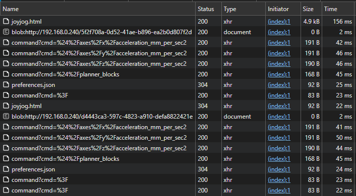

I just updated to the latest WebUI v3 and to FluidNC built from the main branch. I didn’t poke it too much but it seems fine.
I think it’s always done this, but it seems to like to double-load extensions. This is after reloading the extension after an update to it. I don’t think there’s an issue here, just an observation.
All 4 of those are for the same file but it did seem to only download it once. I see that it did the 200 and then went back to the 304. I don’t quite understand what the blobs are for but I assume it has to do with how extensions are implemented.
Yeah.
I think the double request thing came in when Luc added the extension caching or something.
The mechanism it uses, if I remember correctly, is to download it to local storage, then load it from there.
The blob load I think is when it’s pulling it out of local storage.
It’s at least using the cache correctly and not double loading.
Previously you would have seen 2 full downloads from the ESP32 there.
The double load is the next thing I will look at.
I spent a little bit of time before I left last time looking, but ran out of time.
I may just send it to Luc, and see if he’ll look into it first :grin:

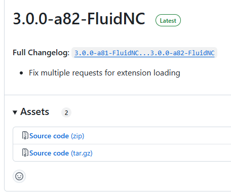

@jeyeager Fixed.
That Release didn’t include the index.html.gz file like the other releases.
Sorry, should be there now.
I had to delete the release and recreate it earlier, so I must have forgot to attach it when I recreated it
It seems like the tag is wrong. It seems to point at a version without the FluidNC changes.
Try again, I had to recreate the tag
Thanks. Looks good.
This is loading an extension, uploading a new version, and re-loading that extension. It’s nice to see that it caches preferences.json as well.
