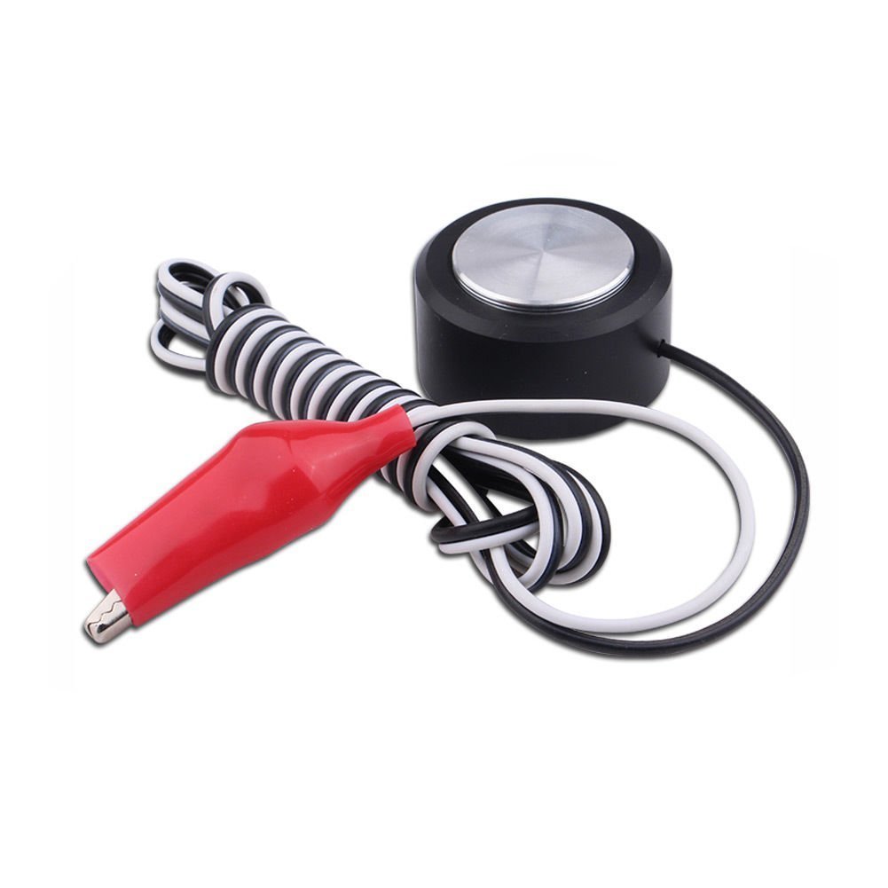

Hardware wise I used MakerBot v1.2 mechanical endstops on Xmin, Ymin and Zmax, wired to the corresponding connectors on the Ramps board.
I used a simple touchplate that looks like this:
wired to the Ramps Zmin endstop connector.
Overall a pretty simple setup - once you get past exactly which bits of the marlin configs are needed, and which aren’t…
