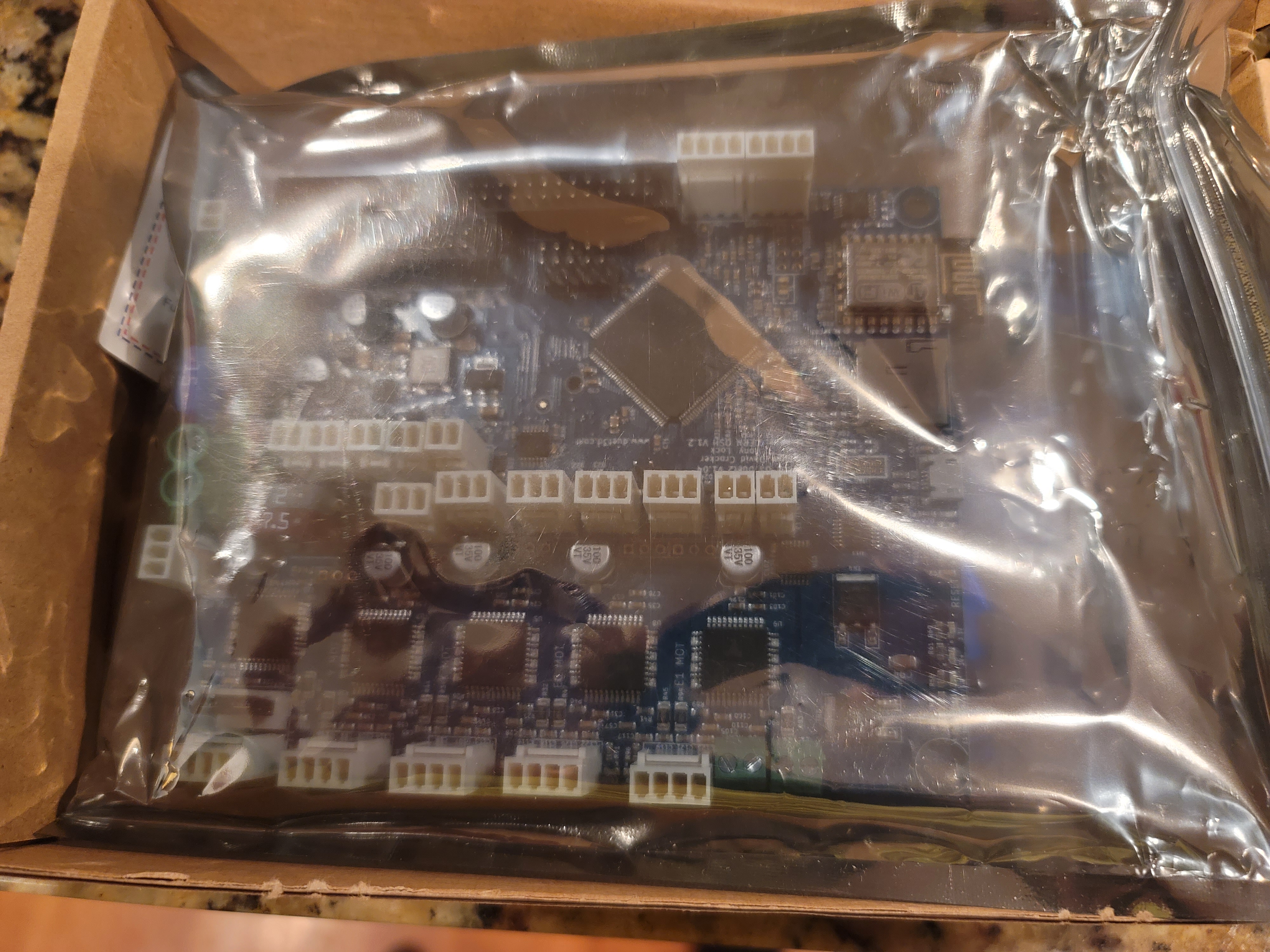

My MPCNC is currently printing. Meanwhile parts are trickling in. I received 3 boards:
  1. Creality v1.1.4 (Ender 5) my friend was kind enough to give it to me for free.
  2. BTT GTR v1.0 32 bit (new from Amazon) with 2208 drivers.
  3. Duet 2 WiFi (clone from Amazon)

All I want to do is to use each board to just spin the motor. This would ensure that boards are good. Can someone please tell me where to start looking or what would be a high level process to achieve this?

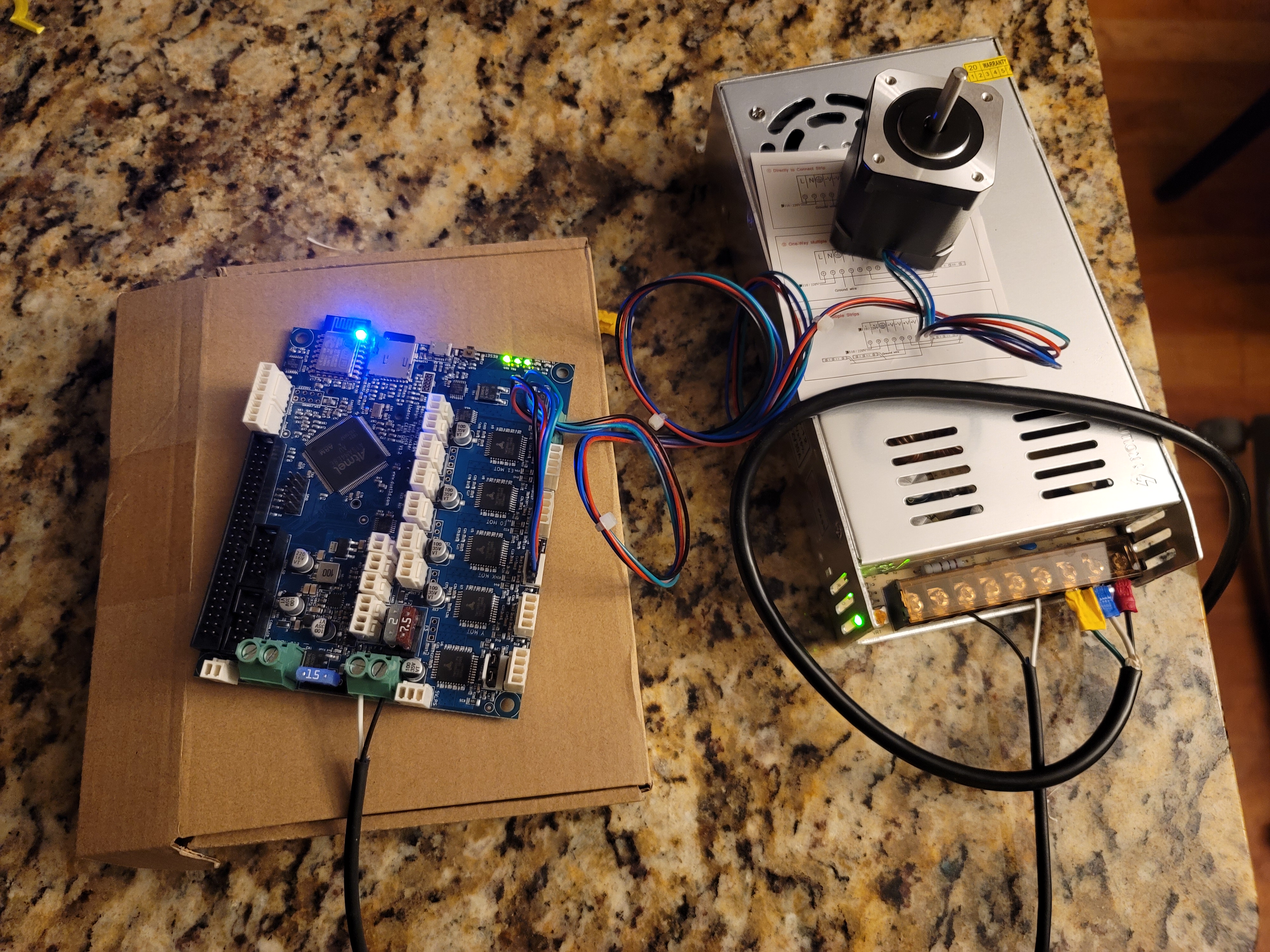

I found out that I can use YAT to connect to DUET board via COM Port. Send command M115 to get the firmware version. Mine is at version 2. I will install latest version 3 and then configure it.
M115
FIRMWARE_NAME: RepRapFirmware for Duet 2 WiFi/Ethernet FIRMWARE_VERSION: 2.0(RTOS) ELECTRONICS: Duet WiFi 1.02 or later FIRMWARE_DATE: 2018-06-05b3

SUCCESS! At least with the duet board.
I erased the firmware, loaded latest 3.1.1 firmware and DWC on to sd card. From online configurator i picked up ender 3 Pro default settings. After connecting to web interface, i was able to get the motor moving.
What’s amazing is that, duet clone, works just like real duet! I used all the original duet files and it booted without any hickups.
