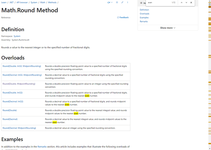

.NET has this BS logic by default too.
Doc for Math.Round(…) variants are long, and full of notes on ‘rounding to even’, and banker’s rounding based behavior.
imo, a long doc full of notes and caveats like this is an unwitting confession that the default behavior is wrong…
  • “Rounding away from zero is the most widely known form of rounding, while rounding to nearest even is the standard in financial and statistical operations. It conforms to IEEE Standard 754, section 4. When used in multiple rounding operations, rounding to nearest even reduces the rounding error that is caused by consistently rounding midpoint values in a single direction. In some cases, this rounding error can be significant.”
They rationalize the default behavior as following https://en.wikipedia.org/wiki/IEEE_754#Roundings_to_nearest
Yeah, that’s great and all, but… The default expectation of most Dev Customers wanting to round to an integer requires them to mindfully remember to use a cumbersome non default overload… e.g.
  • :heavy_check_mark: Math.Round(1.5) and Math.Round(1.5, MidpointRounding.AwayFromZero) both returns 2
  • :heavy_check_mark: Math.Round(2.5, MidpointRounding.AwayFromZero) returns 3
    -:poop:Math.Round(2.5) returns 2
