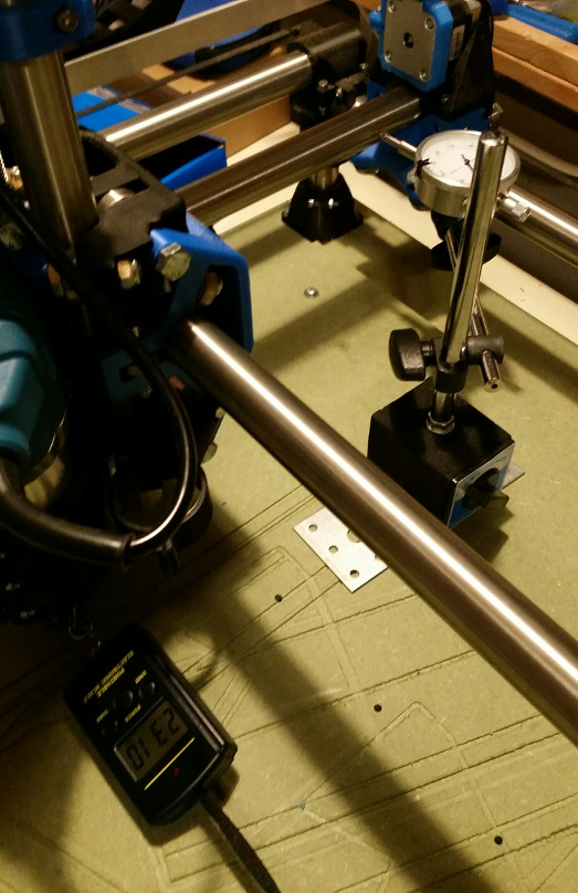

I tried to measure how much the roller moves when there is a load on the end mill, in an effort to measure belt stretch versus my (epoxy) rack and pinion approach. However, I got some very surprising results for the belt stretch measurements.
When the roller is only 25mm from the corner, so effectively with a very short belt, then I measure a movement of the roller of 0.145mm for a 2 kg load. When the roller is 695mm from the corner, I measure 0.175mm for the same 2 kg load, just 0.030mm more!
I put 2 kg load on the end mill, which was placed in the center of the workspace. The effective load on the roller should then be roughly 1 kg. My GT2 belt stretches around 0.320mm per meter per kg, so I should have measured something like 0.300mm+ instead.
Here’s my setup:
I screwed an iron plate to my spoilboard, and put a magnetic holder with a dial indicator on top of it. The dial indicator is placed against the gantry tube close to the roller. I strung a rope to the end mill, and hung a weight on it on the side of the table. The rope goes over a bearing. To be sure how much weight I was really putting on the end mill, I put a scale in between. The value shown by the scale is pretty much the same as the actual weight(s) I used.
Some notes:
  • I repeated the measurements several times with 2 different weights. I measured the movement of the roller at 25, 225, 425, and 695mm from the corner. I get the same results every time.
  • The frame is not racking much. I measured 0.010mm for the 2 kg load.
  • There is some backlash or friction or something in the roller / belt. When you put a load on the end mill, and then remove the load again, the roller does not move all the way back to its starting position. I think the difference is typically about 0.025mm. For my measurements, I first put the weight on the end mill, removed it, zero’d the dial indicator, put the weight again, and only then measured the movement.
I don’t understand why I measured a relatively large movement very close to the corner and such a small belt stretch effect. Does anybody have any idea?

When I was pulling the end mill back and forth with my hands, I could clearly see the belt moving. And then I noticed that the “fixed” zip tie is actually the reason for the movement near the corner!
I think I assembled it according to the instructions. I folded the end of the GT2 belt onto itself, with the teeth meshing, put a ziptie through the corner piece and through the loop, and pulled it tight. The belt is completely inside the thing on the corner. There is no slack in the ziptie itself.
I also put a ziptie around the belt a few mm from the corner, to make sure the teeth would always mesh and stay in place. But when I pull on the end mill, I can clearly see this second ziptie move almost as much as the roller!
I don’t think the ziptie is flexing. It looks like there are two things happening:
  • The radius of the belt loop seems to be slightly larger than the ziptie width, even though it’s pulled into the corner piece. When you pull on the belt, this radius decreases (it becomes flatter), which lengthens the belt.
  • It also seems like the whole loop moves a bit, even though the ziptie holding it is not. Maybe the teeth on the inside of the ziptie are compressing or something.

I also measured how much force was on the roller/belt when I put 2 kg of load on the end mill. It was measured at about 825g. So I wasn’t pulling exactly in the center, but it’s close enough. I also tried putting a 4.5 kg weight on the end mill, and the movement of the roller seems to scale linearly with the weight (I measured 0.360mm movement of the roller with 4.5 kg on the end mill). Makes sense.
I also measured the lowest plastic point of the roller and the top of the stepper motor. Interestingly, the tube deflects more than either of these two points. This also makes sense to me. (The difference was about 0.060mm for a 4.5 kg load on the end mill, so 0.300mm movement of the bottom and top, and 0.360mm of the tube.).
My current hypothesis is that the plastic of the roller itself is stretching or bending. I find it hard to believe, but I’ve run out of other ideas, and I’m slowly going crazy…

Today I learned something new: a 1.8 degree stepper can move 1.8 degrees before skipping a step. That means that it can move 0.160mm before skipping. Intuitively I thought it would only be able to move half that distance (0.080mm) before skipping, but it turned out that was wrong.
When I put 4.5kg of load on the mill, the stepper was very close to skipping (it’s not the strongest stepper). So, I think I was close to 0.160mm movement. That explains a decent chunk of the 0.360mm movement of the roller I measured.
