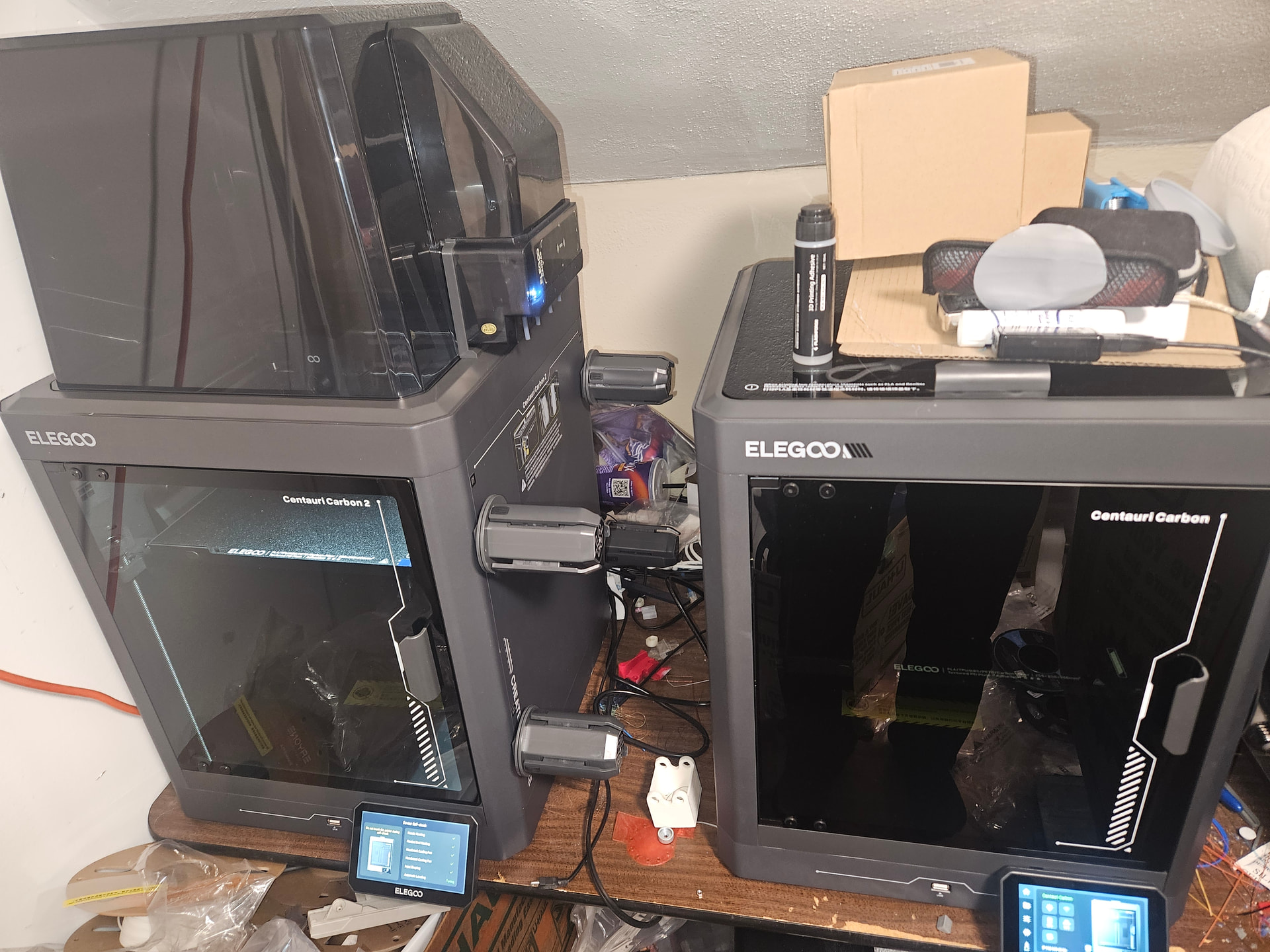

Pulled the trigger on an Elegoo Centauri Carbon II
So I (re)started with commercial 3D printers with the FlashForge A5M after @DougJoseph gave a glowing review to his. I had to admit that it was very convenient and better than the ones I had built. Cheaper, too.
That led to me buying a Centauri Carbon, which was supposed to have a future upgrade to multi-material. Well, that didn’t happen, but I knew that it would not before I actually received it.
So Elegoo.announced that the Carbon II would start.shipping this week, and I dithered over it a couple of days, but pulled the trigger on it, so it will be coming soon.
I’m looking forward to seeing how it all works. I certainly hope that I won’t need yet another slicer though. Im.using Prusa Slicer for my MP3DP printers and my own self-designed, Orca slicer for the FlashForge, and Elegoo slicer for the Carbon. Elegoo slicer is really close to the Orca slicer, maybe I can convince it to talk to the FF. Orca won’t deal with the Elegoo quite right though, so that’s my software tangle, and the main complaint I have with the commercial printers.

its going through self rest, first power on now.
Esit: big mess from unpacking. “Ready to print out of the box” my left foot…

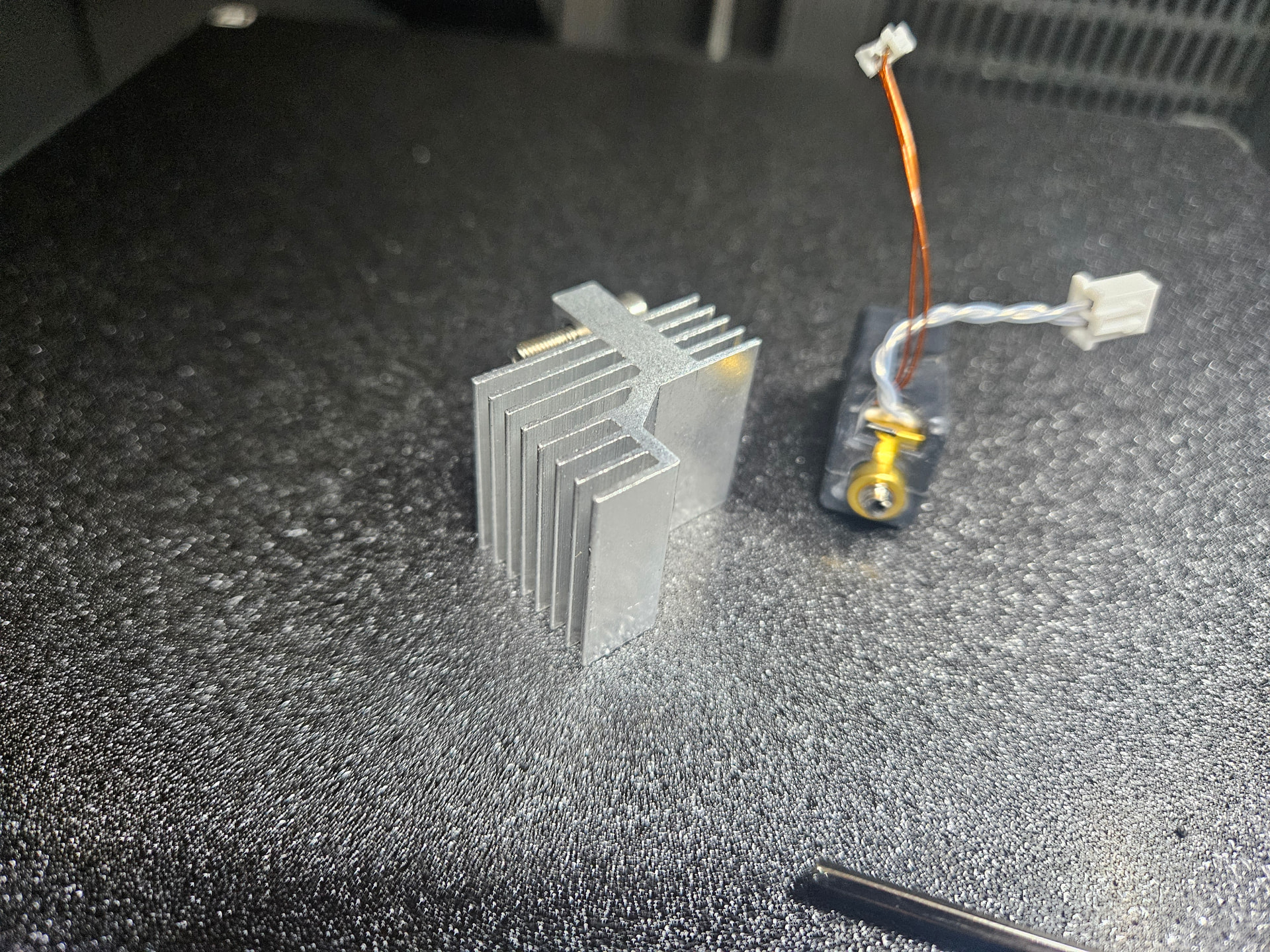

Well, not off to a great start. The hotend is broken.
It started okay, but then it looked like it just popped the fan cover off, but it was more serious.
Support says it probably happened in shipping. The support contact page doesn’t list the Carbon 2 yet. The spec for the Carbon 2 seems different than the Carbon, so I don’t even know if I could just buy the hotend listed, or if it would be different.

So they’re sending me a new hotend, Elegoo support has been quite responsive and helpful. Meanwhile they confirmed that the hotend is identical to the one from the Carbon 1, which I have a spare for, with the exception of the thermistor, which is different (And gives the higher temperature capabilities to the Carbon 2.) Since my thermistor is intact, I’ve implemented repairs by taking the thermistor from my spare hotend, and putting in the one from the broken hotend into it. I’m attempting my 2 colour print again now. So far it looks good. This is a pretty simple print with only 2 layers of white text inlaid into a black body, but I think that will be more than sufficient as a test… And they’re done.

So I have confirmed the difference between the CC1 and CC2 hotends to be just the thermistor. The CC1 is limited to 320°C while the CC2 can reach 350°C (the CC1 gets hot enough for any filament I’ve used so far!) I Amazon Overnighted a hotend for the CC1, grabbed the thermistor from.the broken one and have printed some multicolor parts.

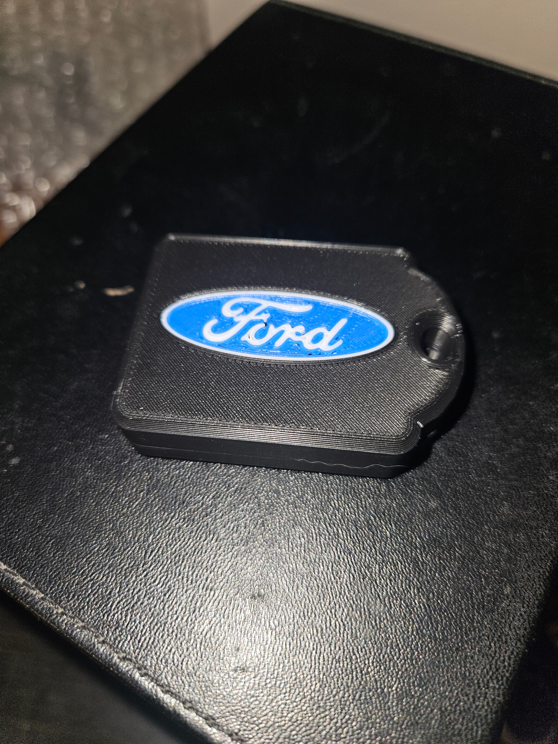

This is a key fob case I remixed for a friend. Obviously for a Ford car.
I have some complaints, mostly about how the slicer fits things together with “painted” surfaces. The Ford text and oval are separate bodies in a .step file, the blue is painted in. When on the bottom like thst, it works well, but if it’s bridged, the slicer does not bridge it at all, and prints the colour unsupported, which works about as well as you might think. I solved that but going back to CAD and making a slab slightly larger than the required grid, and having it made in the different colour. Then the bridging across the depression worked as expected.

My first query was answered right away, I put in the request in the evening, had an answer in the morning. I’m guessing support is in China given the time, but the English wasn’t bad. It took a while from “we will send you a new part” to “here is a tracking number” though. I got the tracking number this morning, and it’s coming from China, so I’d guess at least a week before I’ll have the part in hand.
Meanwhile, I got the CC1 hotend and have been working with the printer. Now I guess I can keep the spare CC1 thermistor and have a spare hotend ready for either printer on short notice, so ²pthe money wasn’t wasted.
