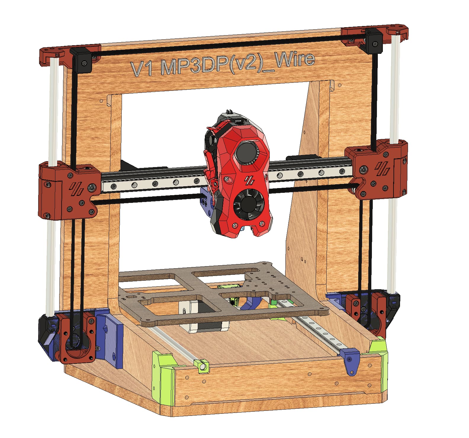

Pretty easy drop-in of PrusaWire Core-XZ gantry on an MP3DP V2:
Blue Parts, and a few new holes in top of front frame for the top idlers and counter-balancer.
Y plate change is not a must-do, but changing bearing hole pattern offsets will maximize print volume.
(The MGN12 Y-rail is something I did to mine a while ago when my Y bearings started getting sloppy - not necessary.)

The MGN Y rail was easy and helped a lot, though simply replacing the the LM8UU bearings and rods probably would have been just as effective - it was rock steady when new.
My X rail LM8UU bearings went too. I had lubed them, but probably not with great oil and they got both sticky and loose at various positions. I did put an MGN X rail on it prior to seeing this. It cleaned up X movement, but I must have had a spacing issue that was creating Z-banding.
The Core-XZ eliminates the threaded rods and should help with that.

The PrusaWire X-carrier has a spacer block between the MGN carriage and the rest of the carrier that pushes the whole Stealthburner assembly pretty far forward. I already took 20mm out and I think there is another 10mm to be had - that is why there are a couple of “blue” parts in the original picture. I think the only benefit is to make room for an inductive Z-probe, but there are other options that don’t require that compromise.
