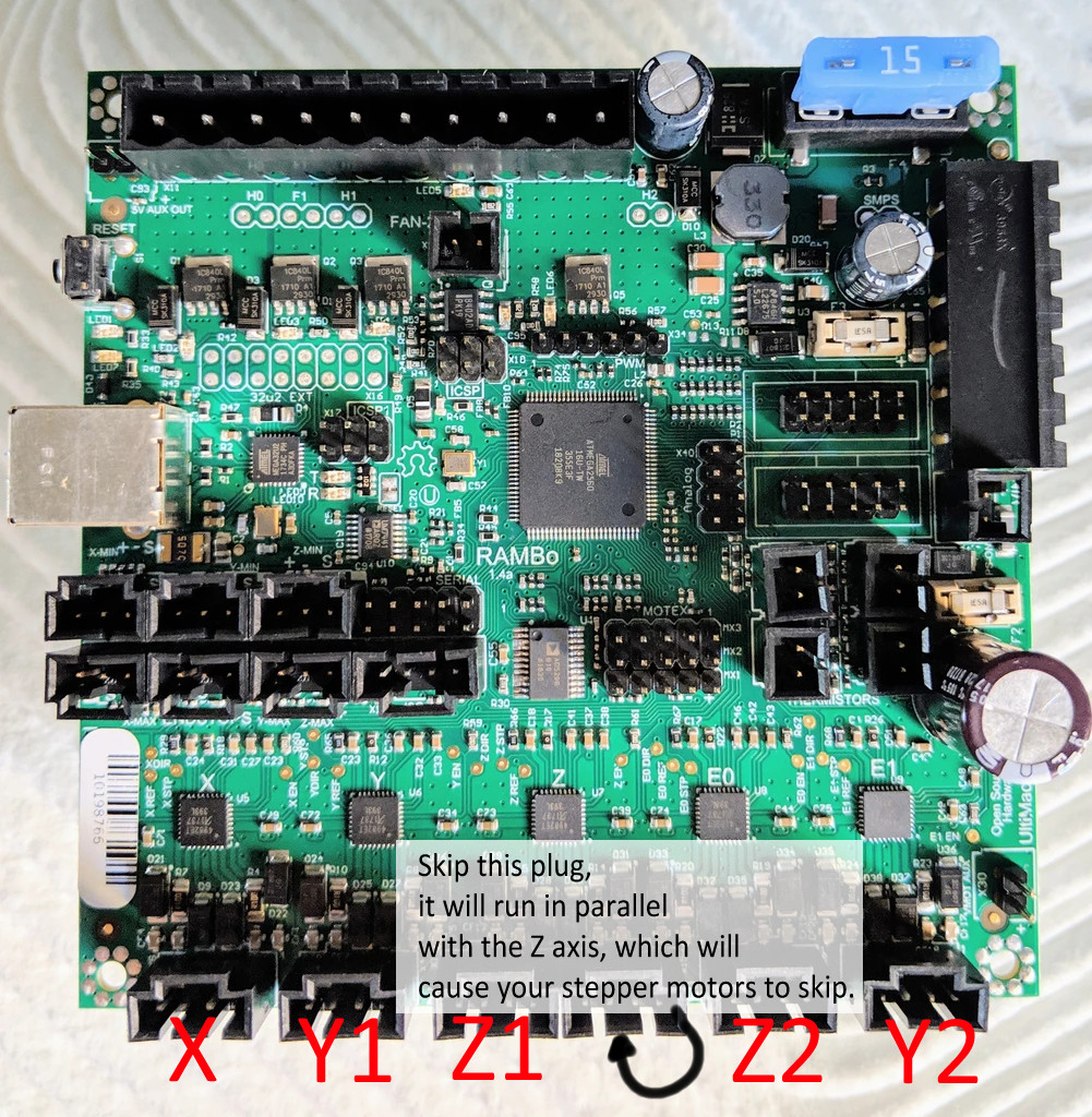

Problems with Z Axis Skipping Steps
If you’re trying to use the grbl firmware for the MPCNC (found here) on the Lowrider there’s a few things you need to do.
After following the instructions in the link to install the grbl firmware navigate to the Arduino IDE libraries folder. (Usually C:\Users[username]\Documents\Arduino). Open the grbl folder and then open the config.h file using notepad/notepad++/etc.
Scroll down to line 72. You should see:
#define AXIS_4_NAME ‘X’ // Letter of axis number 4
Change the X to Z so line 72 reads:
#define AXIS_4_NAME ‘Z’ // Letter of axis number 4
Save this file, and then restart Arduino IDE. Navigate Files > Examples > grbl > grblUpload. Flash this to upload your edited firmware.
You’ll need to change the steps/mm value from 100 to 400. In UGS you do this by typing into the console: $103=400 and pressing enter.
Now you should be good to go! Make sure your motors are wired into the RAMBo correctly.
