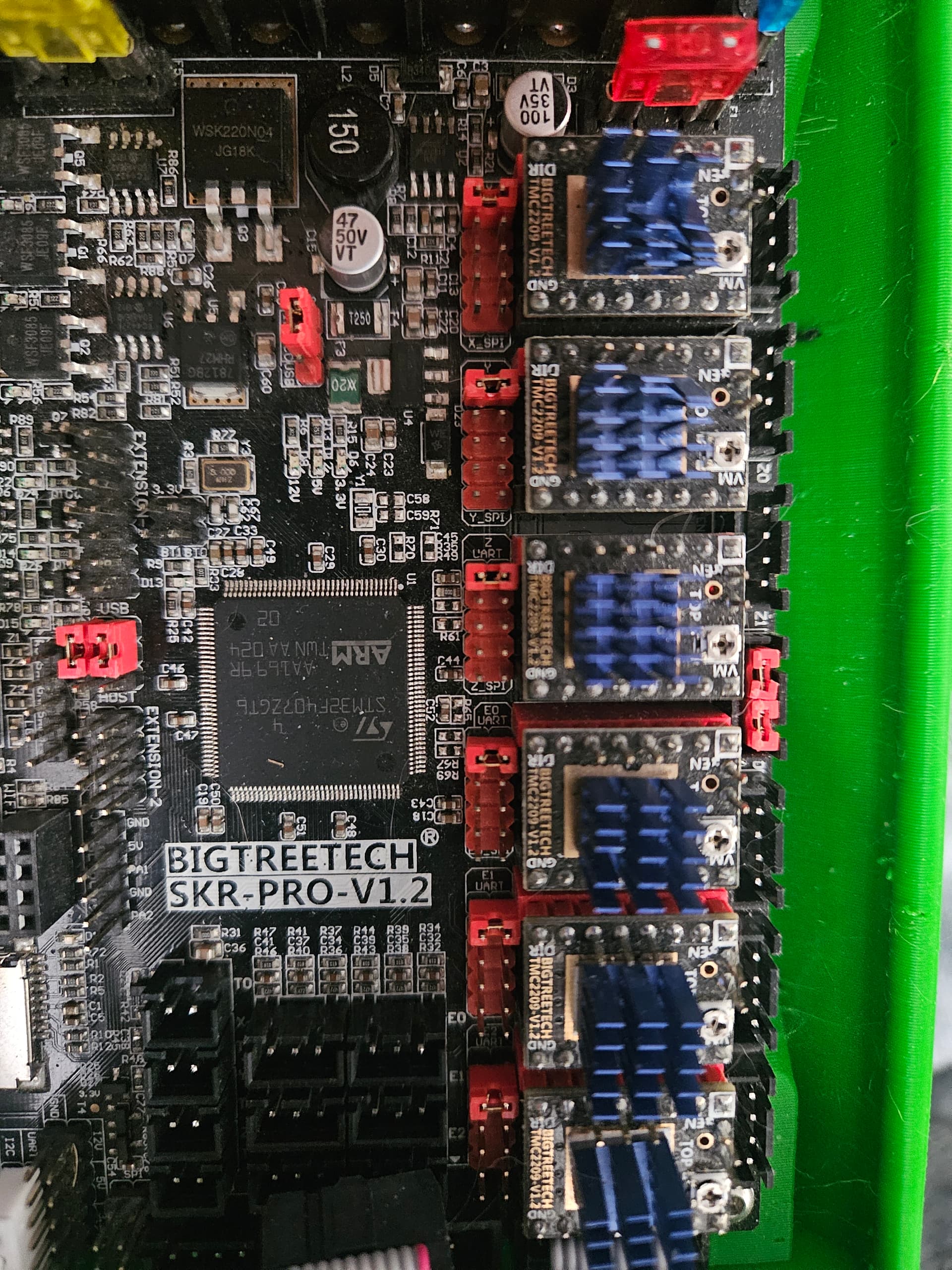

I just built a lowrider cnc… got everything together powered on, repetier host on. Ran into a couple problems… Only one Y and one Z sorry motor will move (more like makes a loud clunking noise) sometimes it moves sometimes it don’t. The z axis feels like it is snagged up but when powered off moves freely. I’m using a skr pro 1.2… The steppers are nema 17 1.5amp 67oz… on the tft screen, the screen functions but I can’t move the axis or anything. Can someone please tell me what to do. I’m not good with flashing, software, and all that so I can’t give much info on what I’ve done but followed the directions on this site.

Able to share picture of your machine and controller board? Would like to understand how wiring is connected, and driver slots used, jumpers and such.

I think I figured it out. The wiring of the steppers are different to the board

I got the steppers working I had to switch a couple wires around on the stepper motor wiring but now everything is working but the z1 axis…once plugged in and moved in 1mms itll make a clunk noise and on the screen it says driver malfunction please reset device or something along them lines. I put z motor in y1 and it worked it seems to be something on the board or the z stepper driver. I’m personally fed up with skr so I ordered a ramps 1.4 setup which will be here tomm. Hopefully that solves problem. I just want to get up and running. Has anyone done any engravings or inlays with this machine? I do have engraved coffee tables and it would be awesome if this machine was capable of such task.

For the Z1 on the SKR Pro, there are the 2 motor sockets. They are in series, so one needs the jumpers over the motor coil pairs. Not havjng them will have the TMC driver detecting an open circuit and theowing an error.

How about a picture? The 2 red jumpers on the motor connection on the side. Without those, the other Z motor (directly above it) cannot work, as it will be like having an “off” switch in the motor wires.
There are 6 stepper drivers on the SKR Pro.
From the top (as oriented in my picture) for the LowRider, they are X, Y1, Z1, (jumpered), Y2, Z2, and unused. (Do not put jumpers on the last one!)
Also take notice of the jumper blocks to the left of the stepper drivers. The SKR Pro comes with these blocks populated opposite. Onneach of these there should be one jumper across the top pair, and the rest of the block should be open.

Yea I have no driver on the last one but I have it junped
But other then that last stepper not being there and having it jumped, everything looks the same

Hey guys I figured out the problem… The stepper motor wires was wired wrong and the wires was shorted out causing the motors to act funny. I removed the plastic holding the pins together and carefully soldered the wires to the appropriate pins on the board. All acts as should now and I know 100% I won’t get a bad connection again especially during a cut… Thank God I didn’t have to swap out for the ramps 1.4 kit like I was going to do. Thank you for all your help I greatly appreciate everyone who helped me along this. Hopefully today I get it all put together and possibly a cut. I ordered metal xy plates from v1 that would be here today and eventually I want to cut it some metal yz plates, or atleast MDF for I don’t feel the yz plates 3d printed at 70 percent feel like they will be strong enough for the long haul. What I like about this set up is you can start small like I did, 18*36 cut area and if u want to go bigger later on all u got to do is get some more conduit and print a few more braces and rail guides. Had anyone done any inlays or 3d carving with this machine?
