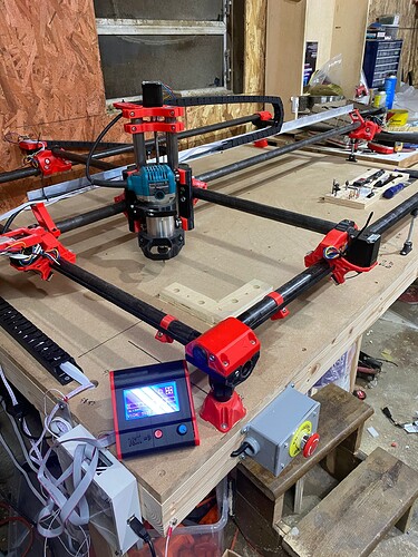

Problem with accuracy. Please help!
When you’re measuring, don’t just measure the inside, either. I had an issue with holes being small, and tabs being big, even when I had the 'correct" diameter set for my mill. It turned out that the 1/8" mill (3.175mm) was actually making 3mm cuts, and setting the diameter to 3mm in Estlcam ended up with correct sizes both internal and external.
I will look at modifying the end mill diameter. It is currently set to .25 and is .2485. While this may help a little it still would not account for one set of holes fitting and another not. I did however have my bits set in inches and designed the spoil board in mm but I’m pretty confident that Vectric would convert everything over as needed. I plan on making a few changes tonight and running some test cuts. I’m going to decrease my feed rates, decrease the step over and tighten my belts. It is possible there is flex some place in the system and I’m just trying to cut to fast causing the inaccuracies in my cut.
I think I may make the same cut 3-4 times with ever decreasing feed and step overs and see if accuracy improves.

No pictures of your build so it is all guesses.
You should absolutely be getting repeatable results. Error or no repeatability is a must. My advice would be post your machine and way more details.
33mm/s at how deep? That is VERY fast for trying to get super accuracy. How many flutes, depth of cut…and a full depth finishing pass is absolutely necessary. (3D printed mill, need to have a spring pass).
Try a single flute upcut, 10mm/s 4mm DOC, .5mm full depth finishing pass and lets see what you actual numbers are. From there, faster or deeper and see when the numbers start to break down. You are coming at it from the too fast side (you are running at the suggested rapids speed, not milling speed). This is all a guess without knowing how your machine is built.

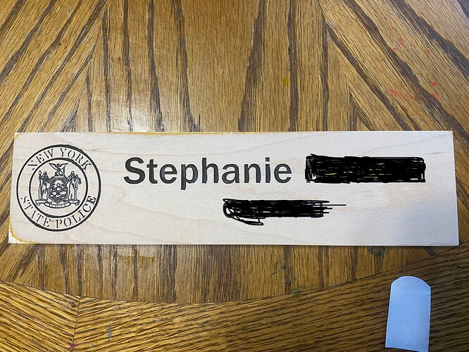

Something like the one finity. Starting off with name plates for my wife’s office with the NY State Troopers seal. Still working out some kinks before I start making them for sale.
I blacked out the last name and department but this was my trial run.
I have my build posted other places but here is what some of my sizes are
I have a 29x46 work area with mid span supports. The supports have virtually taken out any kind of flex out of the side rails. I’m using 1” DOM tubing with a 1/16 wall.
I can definitely take the speeds down and plan to give that a try tonight by doing multiple holes and decreasing the feed rate by 10% for each hole starting at 70 inches per minute and try a conventional cut like somebody suggested. Maybe just do a 70, 60, 50 and 40 with a finishing pass and change my bit size to the .2485 I measured it to be. My depth of pass I use a maximum of bit width/2 unless the recommended depth is less based on the manufacturer. I’m strictly using white side bits and the V1 bit set.
The entire build is very square and after homing and moving it out a given amount and measuring how far each block is out they are the same to within the thickness of the mark on my tape. I have also put in a v bit sunk it into plywood by 1mm raised it and moved 80mm and sunk it again and got a measurement of 80.02 mm so probably spot on and within the margin of error for me measuring and my calipers.
I have tried multiple bits. Almost all are 2 flutes like the bits and bits 425-DNC125LR 1/8 diameter 2 flutes 1/16th depth of cut.

I highly suggest you do it like I said. Start at 8-10mm/s and work up. Why bother making 10 cuts if you do not get what you want at 8-10mm/s? We need a base line to work from. (sorry I work in mm/s as in/minute are hard for me to visualize.) in/min to mm/s - Google Search so start at 20in/minute. If you can;t get a perfect cut with 3-4mmDOC and a fill depth finishing pass of 0.5mm then there are larger issues at play.
70…is pretty far from there.
So you are making a ton of 0.1" passes and no finishing full depth pass? Please have a look at the milling basics page. Try 3-4mm DOC single flute upcut.
A single flute is highly recommended. If you are going to use a 2 flute slow your RPM all the way down.
When working in wood with a extremly high RPM router a single flute stands a chance of clearing a chip before it comes back around. A two flute has a much smaller flute channel and comes around twice as fast. So you will recut a lot of chips, higher load, and burn more often from the double contact.

Ok so here is what I did.
  1. I snugged up the belts slightly
  2. I adjusted my end mill size to .247”
  3. I reduced my rpm down to 10-11k
  4. I adjusted my feed rate to 24 in/pm (10 mm/pm)
  5. I adjusted my depth of cut to be .157” per pass
  6. I changed my cut to a conventional cut instead of a climb cut
  7. I then duplicated that pocket 15.9mm at a feed rate of 36,48 and 60.
I cut them and found the holes to be to small by .1 mm. So I made the hole bigger by .1 and recalculated and ran the passes again. The 24,36 and 48 while snug all fit and if I was to increase by .2 mm to allow for the initial size issue and a little wiggle room I think I will be good. However the 60 was to small and would not fit. So I think 48 in/pm might be my sweet spot. There was no difference in fit between the 24 and 48 in/pm cuts. I didn’t figure out how to do the finishing pass in Vectric until after doing these tests. So tomorrow I will add the same bit into the pocket and put in a .5 mm pocket allowance for the first cut and 0 for the second cut and reduce the passes down to 1 and see what I get.
The important thing is all 3 of the first holes fit the same and I can make allowances for .1mm in my pockets.
I will try this again with the full depth final pass tomorrow and make a series of holes to see if they all stay consistent and then report back with my findings. I will also allow for .2mm extra in diameter. It is possible .15 will be enough.
My plan is to do 6 holes up the Y axis and 6 along the x axis at 48 in/pm with a .5mm full depth finishing pass and see if all holes along both the x and y are the same. I will also be increasing the size of the holes from the actual measurement by .2 mm.

Yeah it is so, not, straight forward as you can see. Reading things and suggestions from all sorts of perspectives, different machines and companies. You really have to test things methodically. Find what works for you and move to the next step. I only revisit settings typically with each revision or when someone figures something new out and posts it here.
Here, everyone started off assuming it was a machine/hardware issue when it was much more of a CAM issue. You never know though.
