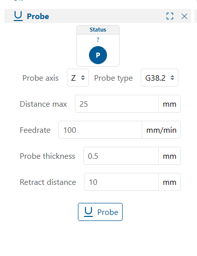

Probe not retracting
After updating to the most recent fluidnc and webgui my probe will not retract after making contact with the pad. I used to use the M5Dial for probing but that is broken so I’m using the webgui. I have retract set for 10mm but the probe just stays on the pad after making contact.

You need to make sure the probe post command in your settings is set to this:
G10 L20 P0 #selected_axis##probe_thickness#;$J=G91 G21 F1000 #selected_axis##probe_retract#
I fixed the default, but if you already had a value there, it would not get overwritten on upgrade
and actually… there’s another bug there because the feedrate is ignored too
Amazing!! Thank you.
So I think it should actually be
G10 L20 P0 #selected_axis##probe_thickness#;$J=G91 G21 F#probe_feedrate# #selected_axis##probe_retract#
but I haven’t tested that

Hi Mike. This seems to be working well now.
This did not retract after probe contact:
This one worked though:
