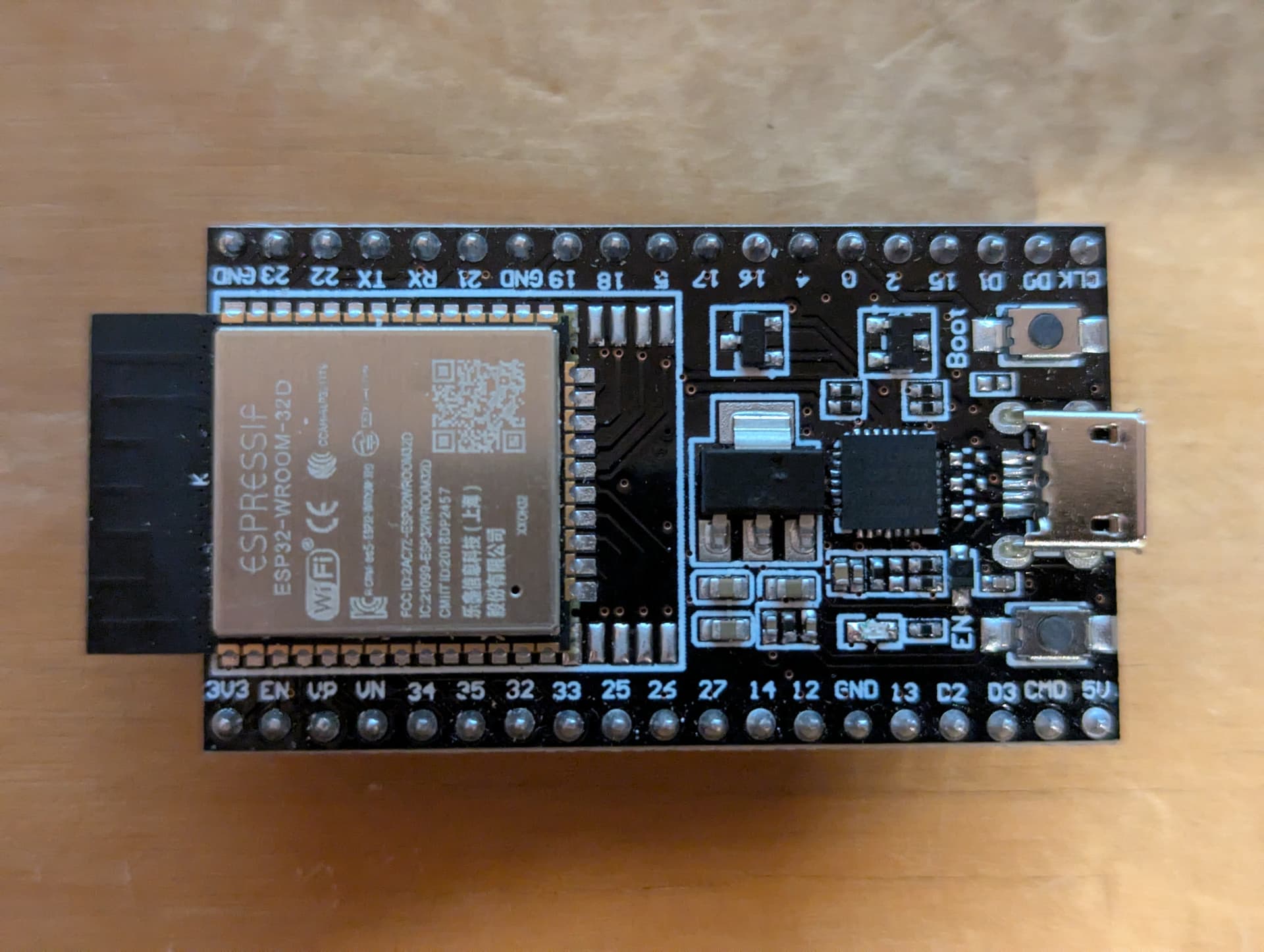

That means the GPIO pin on the ESP-32 was likely blown.

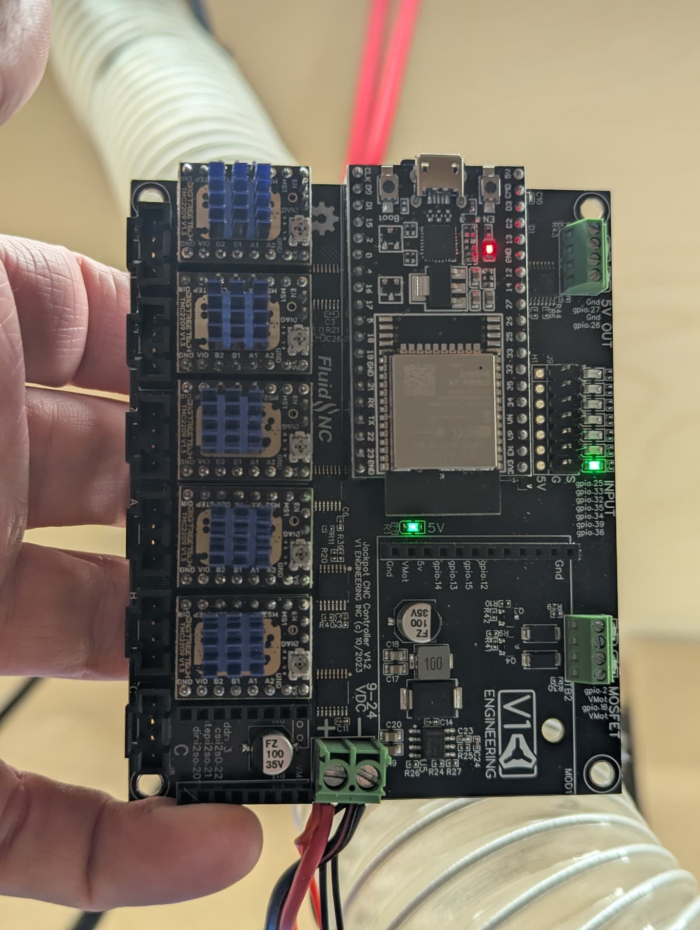

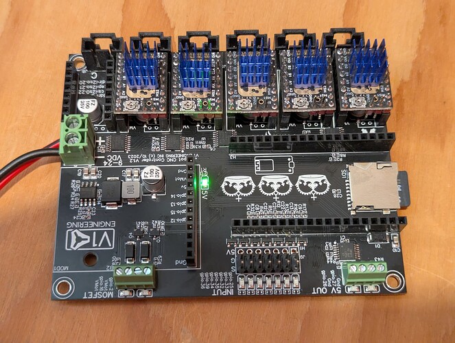

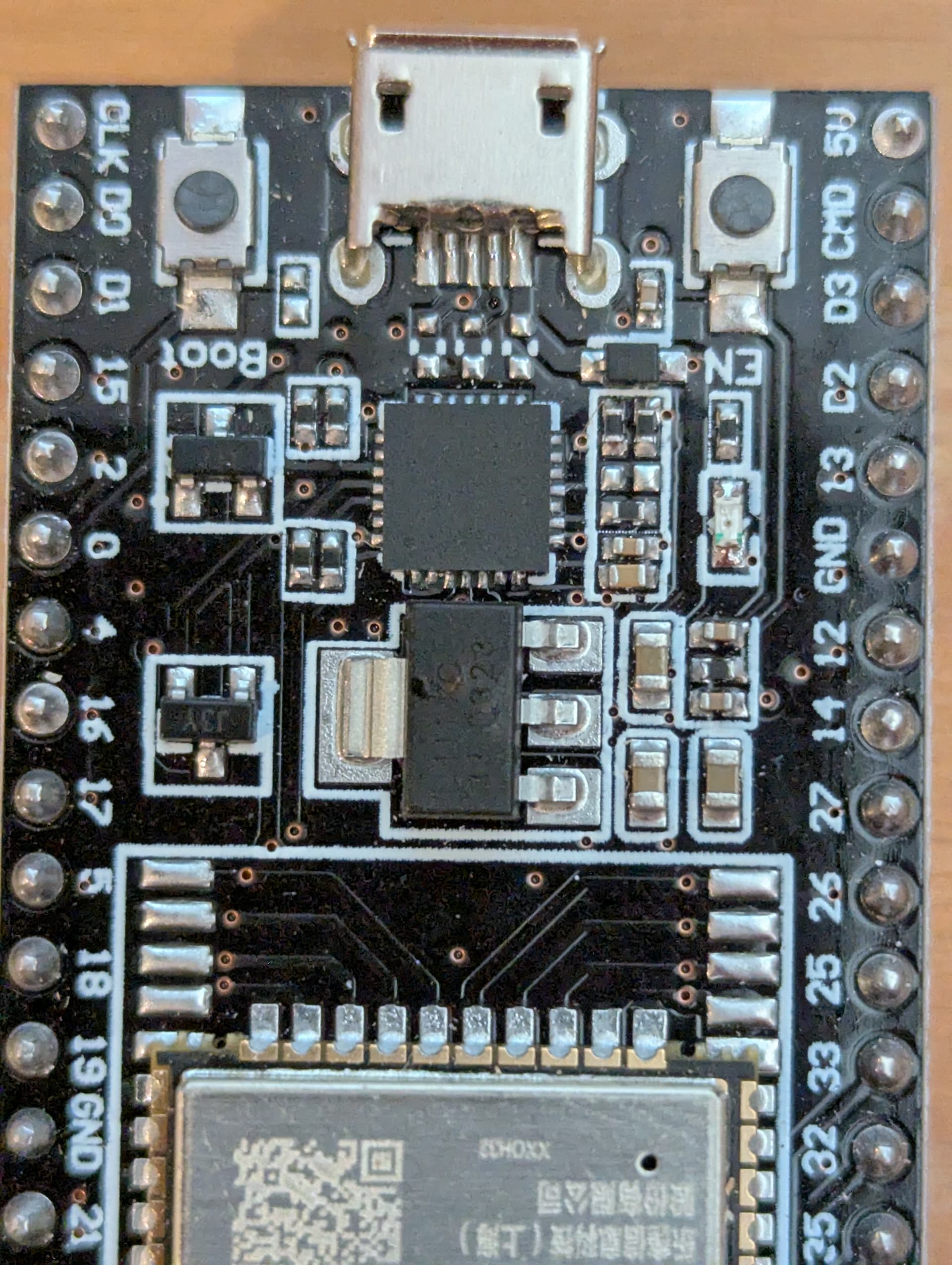

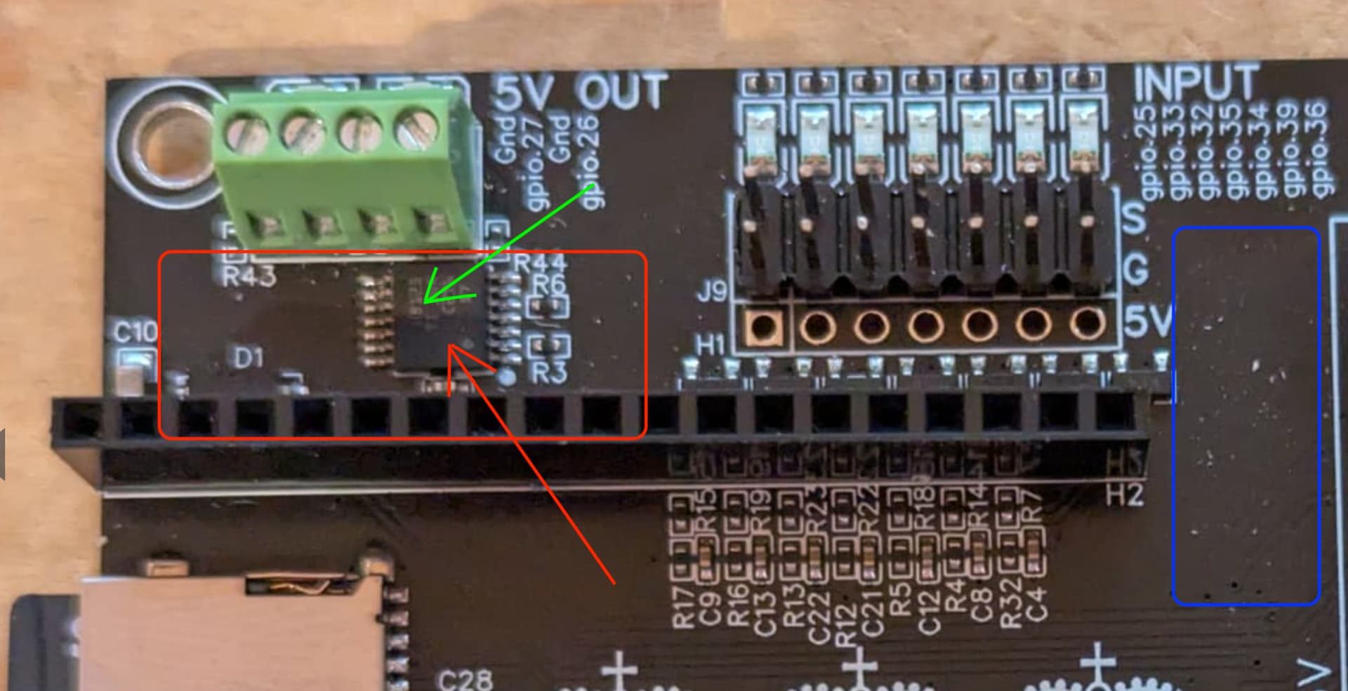

Can you post high-resoluntion pictures of the ESP-32 as-is (removed from the jackpot) and high-resolution pictures of the jackpot itself?
Something is very wrong to be blowing IO that way.
Yes, you can find suitable ESP-32s locally.
What part of the world are you in?
We need to figure out what is blowing your electronics up.
Do you have a DMM to troubleshoot with?

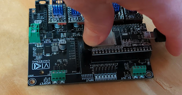

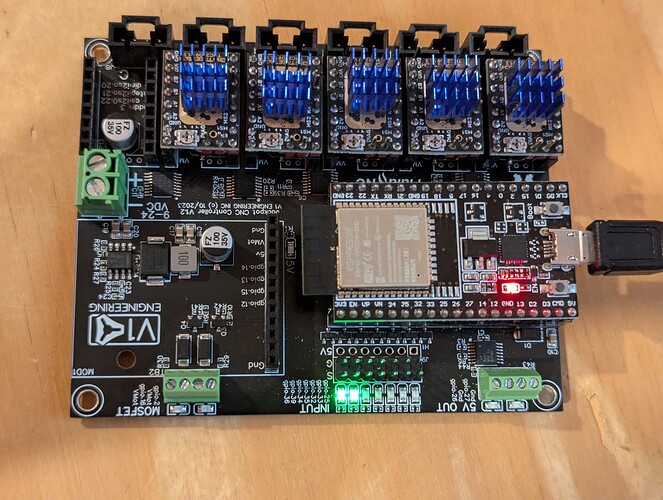

In this little video, you can see the boot process and the fact that the 2 green leds (the 2 blowed up pins) are flashing.
Eastern Canada.
Yes, I have one. A basic one, but I have one. :slight_smile:
The upper picture has some double exposure.

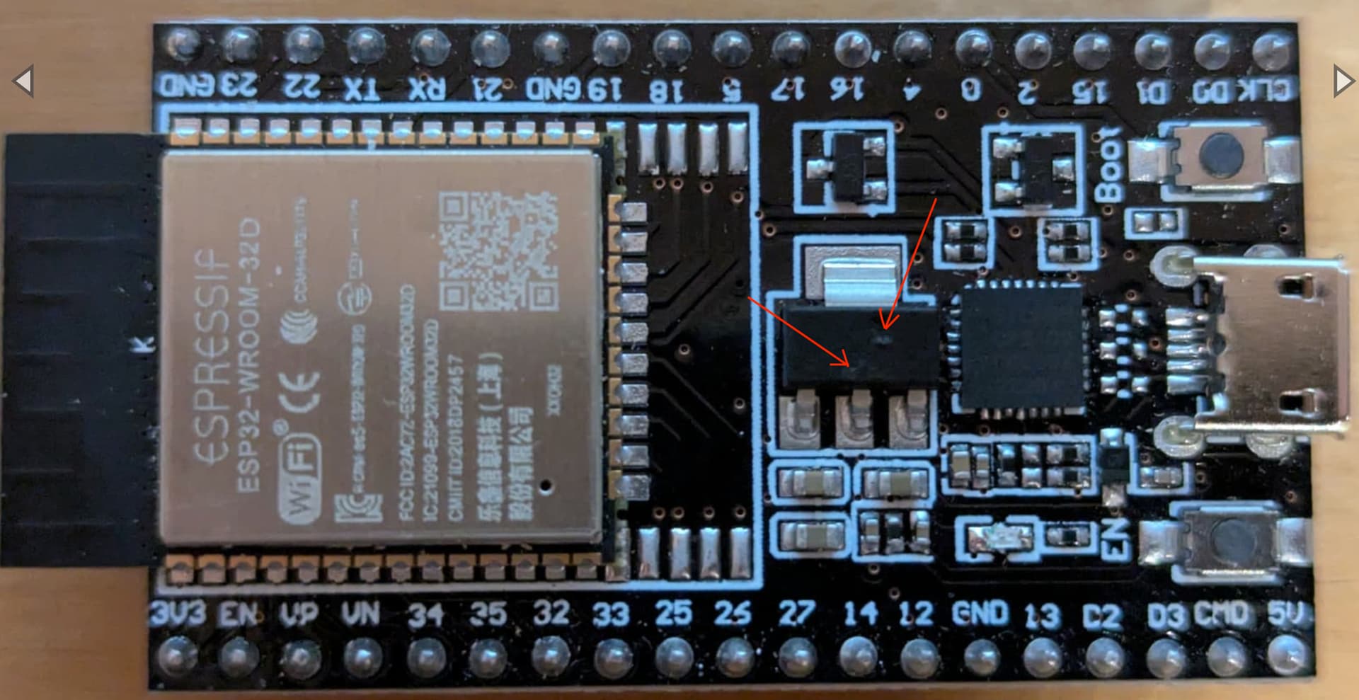

What’s going on here? Note the appearance of the IC… I think this is shadow, can you confirm?
What are the flecks on the board, shown as an example in the blue box?
The voltage regulator on the ESP-32 looks cooked to me. I’m surprised it even turns on. Was this where it smoked?

I think it’s just dust. I don’t see anything with the naked eye, and there’s none visible in this photo (taken this morning after wiping this section with a cloth).
I think it was in this area. But it happened so quickly that I’m not 100% sure. When the smoke and noise started, I quickly turned it off.

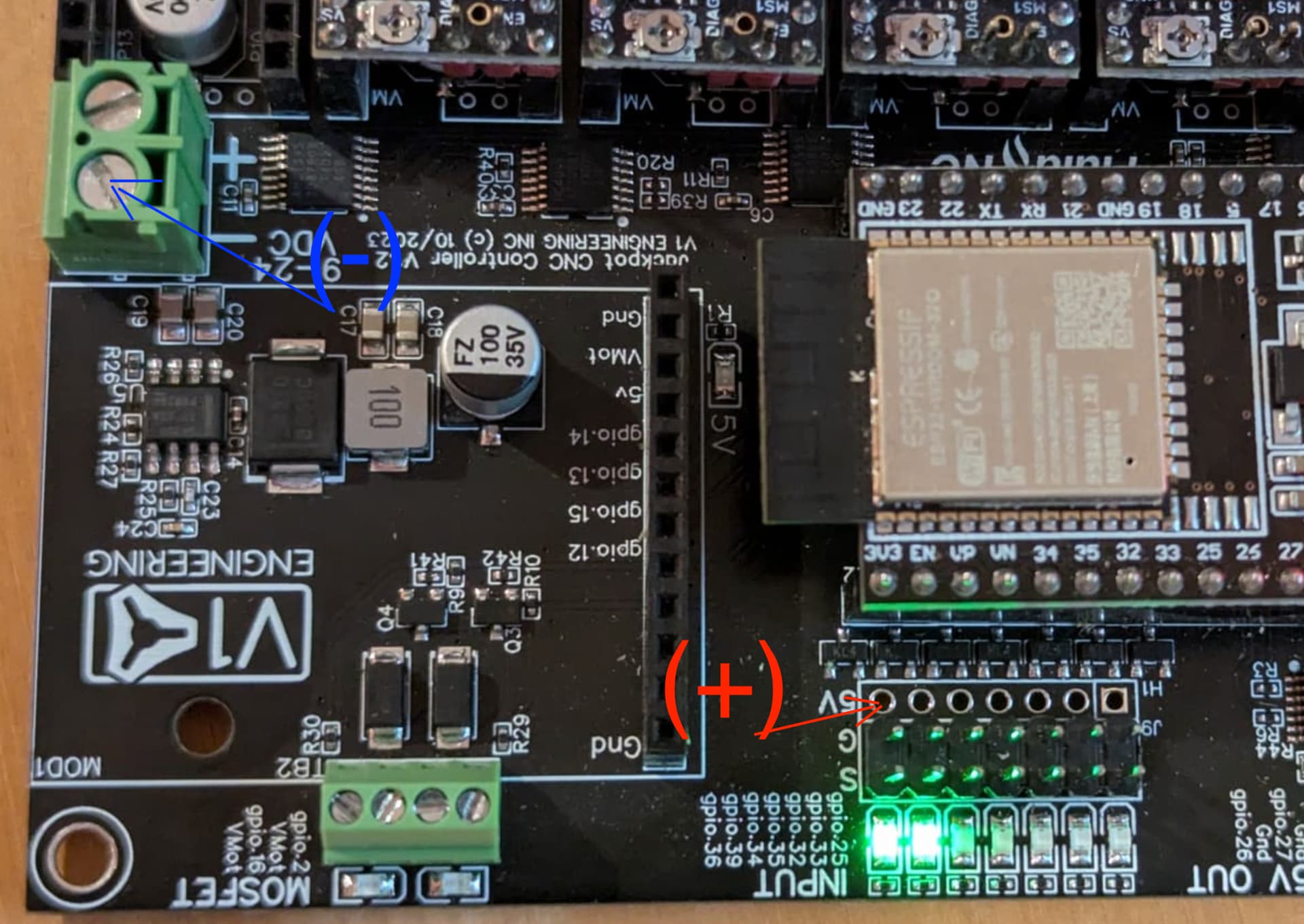

I noticed two more things…

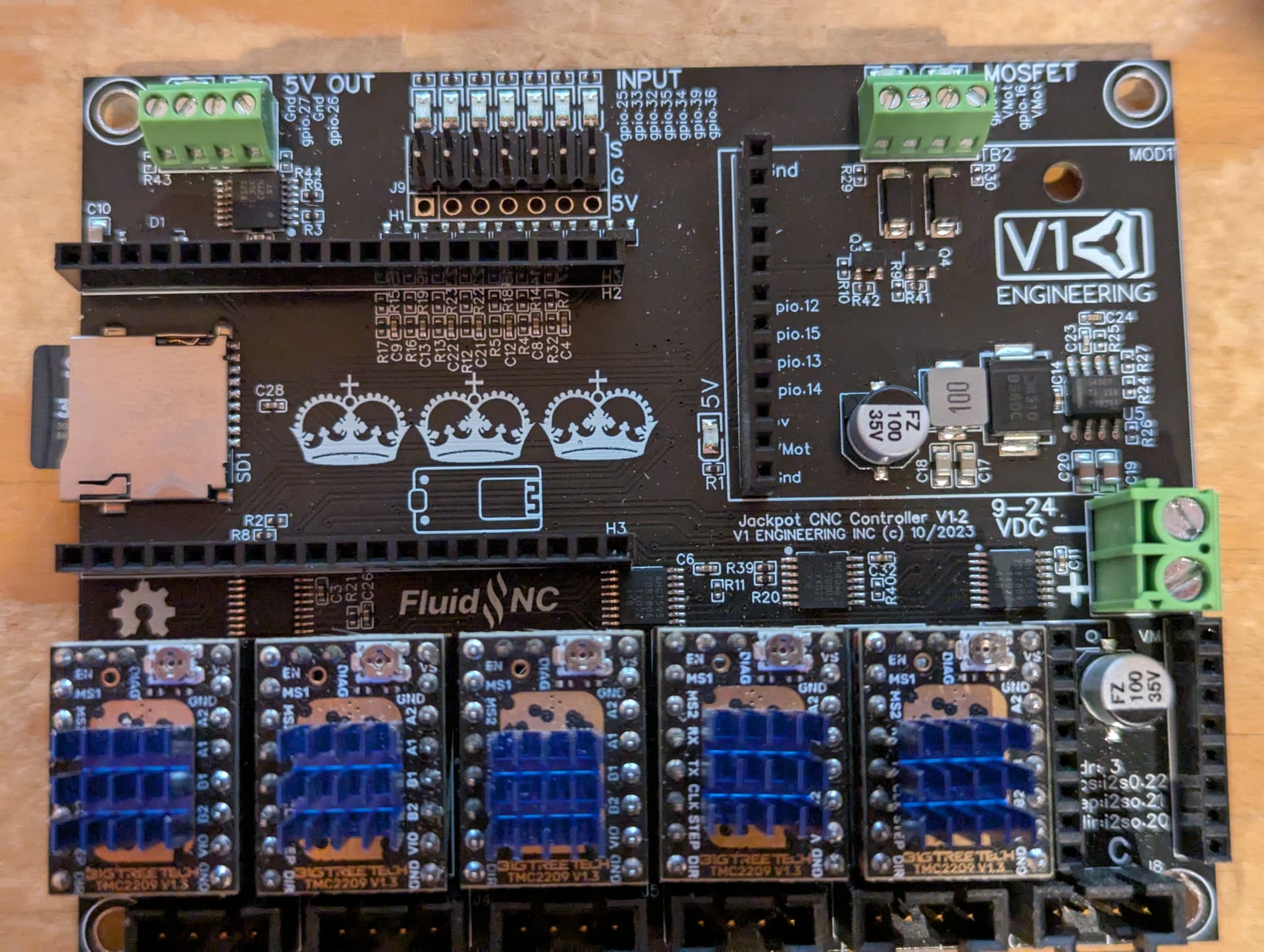

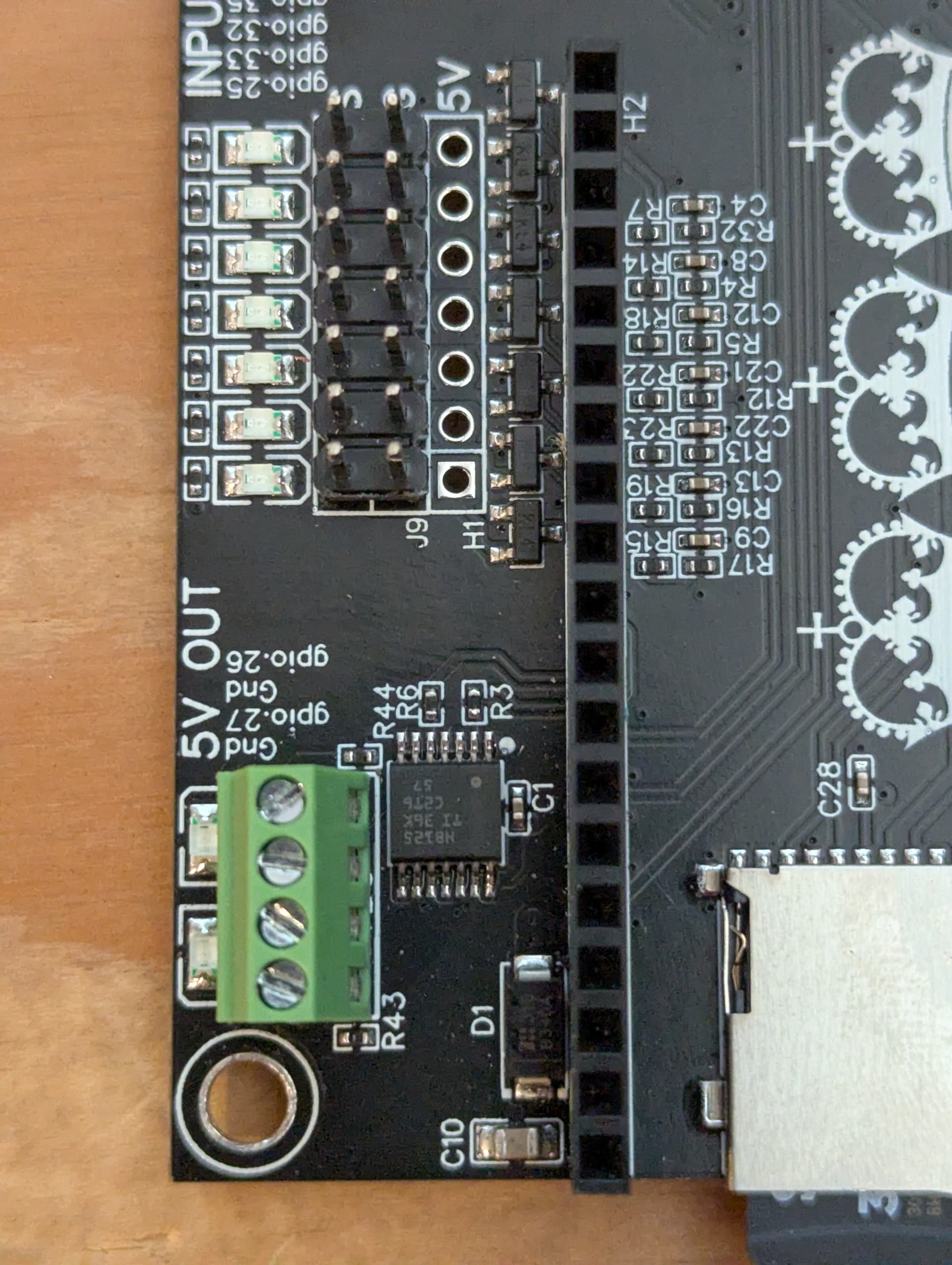

First, when I power on the board, the two LEDs next to the text “5V OUT” don’t light up. I realized this because while taking my measurements, they sometimes turned on and off…
Also, should the ones next to the text “MOSFET” be lit as well?

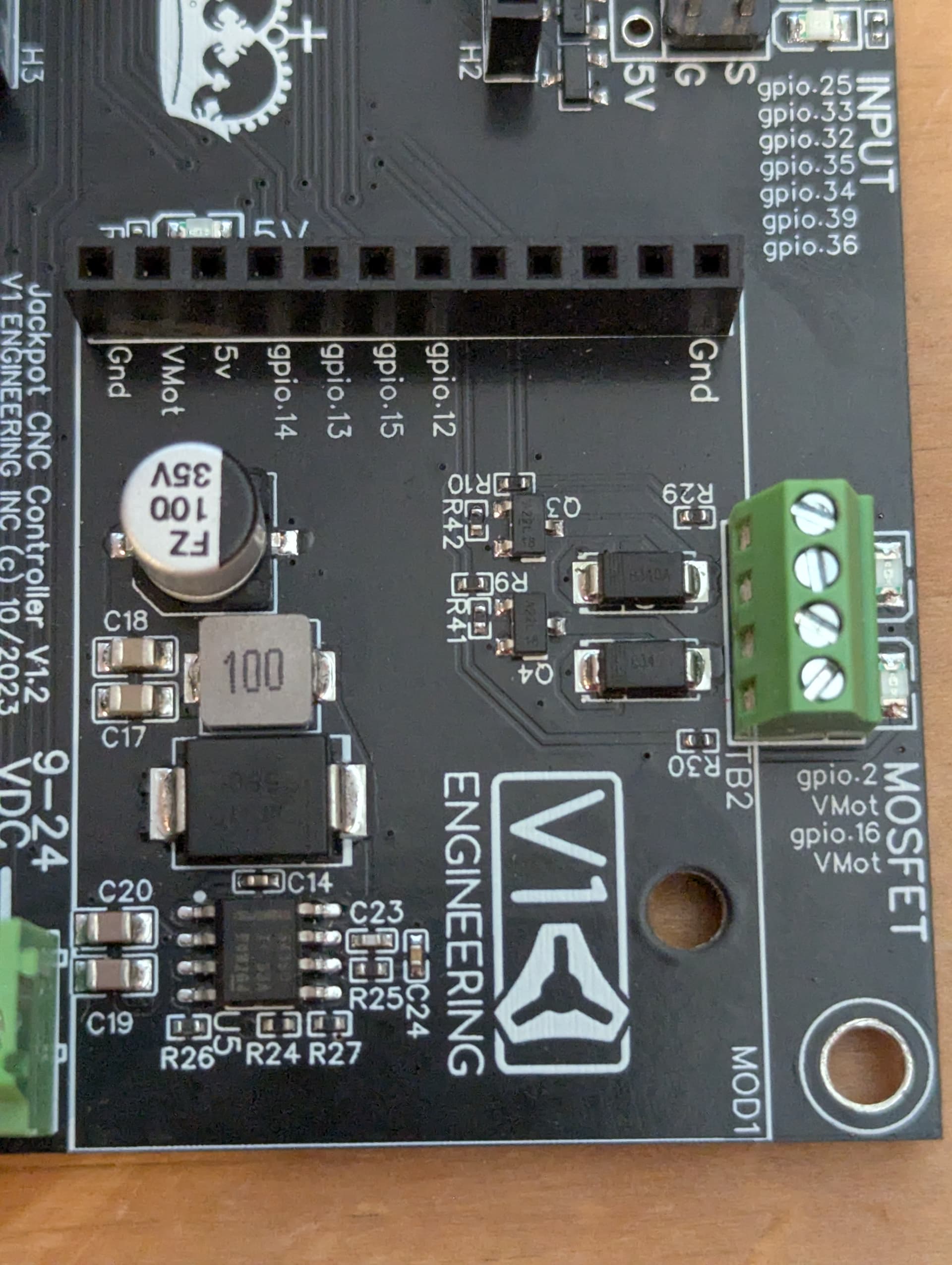

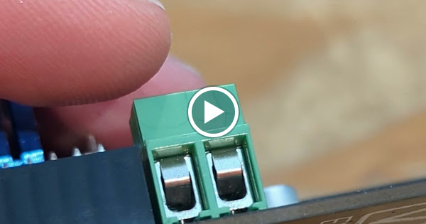

Finally… I think I found something major! The VMOT inlet connector isn’t solid! Not just the green part, but also the pins underneath! It looks like it’s not properly soldered!
Google Photos
Could this explain everything? The voltage regulator on the ESP-32, the unstable voltage on the 5V pins, the LEDs that don’t always light up, and especially the two probe pins that burned out (GPIO 36 & GPIO 39)?
At this point, I assume I need a new Jackpot & ESP-32… But I’d like to make sure this isn’t caused by multiple issues. If everything makes sense to you, that works for me. Otherwise, what else should I check/test before connecting a new controller?
No question the solder of the power inlet connector is broken and looks like it wasn’t properly flowed.
That’s not good, an intermittent/bad solder joint will mean very intermittent power rail and can cause a number of bad issues including arcing at the connector.
Did you source your jackpot from the V1 store or from elecrow?
How old is it?
If it were me, I’d re-flow the solder to the green power inlet terminal block and see if the behavior improves. Given the number of different symptoms and inconsistent 5V power rail behavior on this board I’d say you have maybe a 50/50 chance of fixing the jackpot that way, depending on how stressed the components on the board were from inlet power problems.
I’m sure the ESP-32 has at least a damaged 3V3 regulator, so no question in my mind you need a new ESP-32.
@vicious1 - take a look through the last few posts in this thread…
So that power socket does that when it gets overtightened. The next version of the boards will not use screw terminals here. These terminals need very very little force to completely hold a wire.
I use and power up all the boards before they leave, so that was solid when it left. If you tap it with a soldering iron it will be fine.

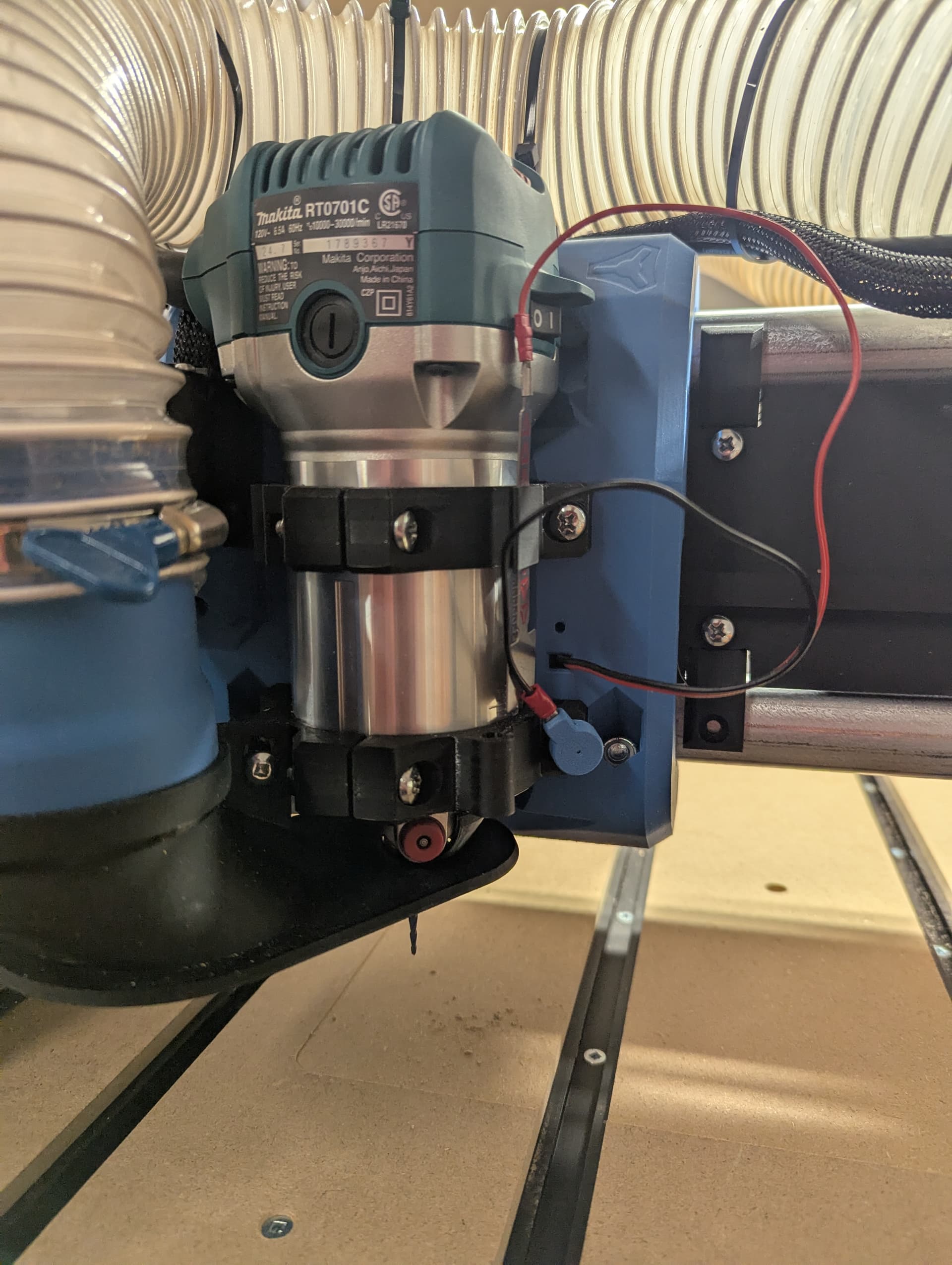

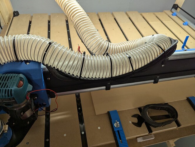

I’m almost certain that the problem came from the wire putting pressure on the connector inside my enclosure. My enclosure is a custom version of the official one. I made it wider, added a switch and a connector, but the depth is the same as the original.
Makita RT0701C.

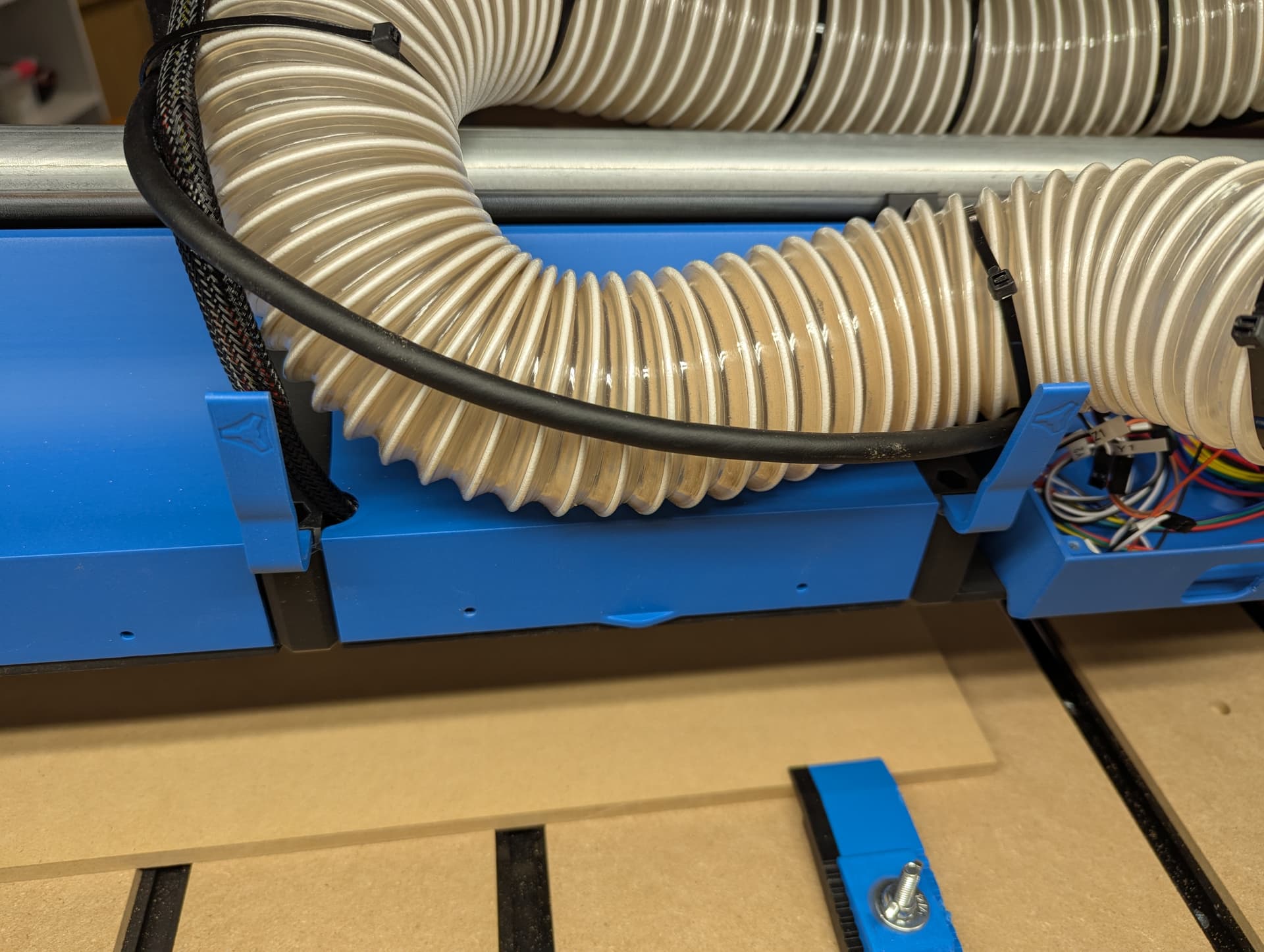

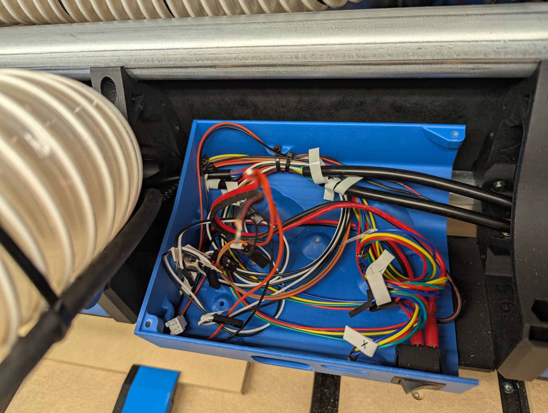

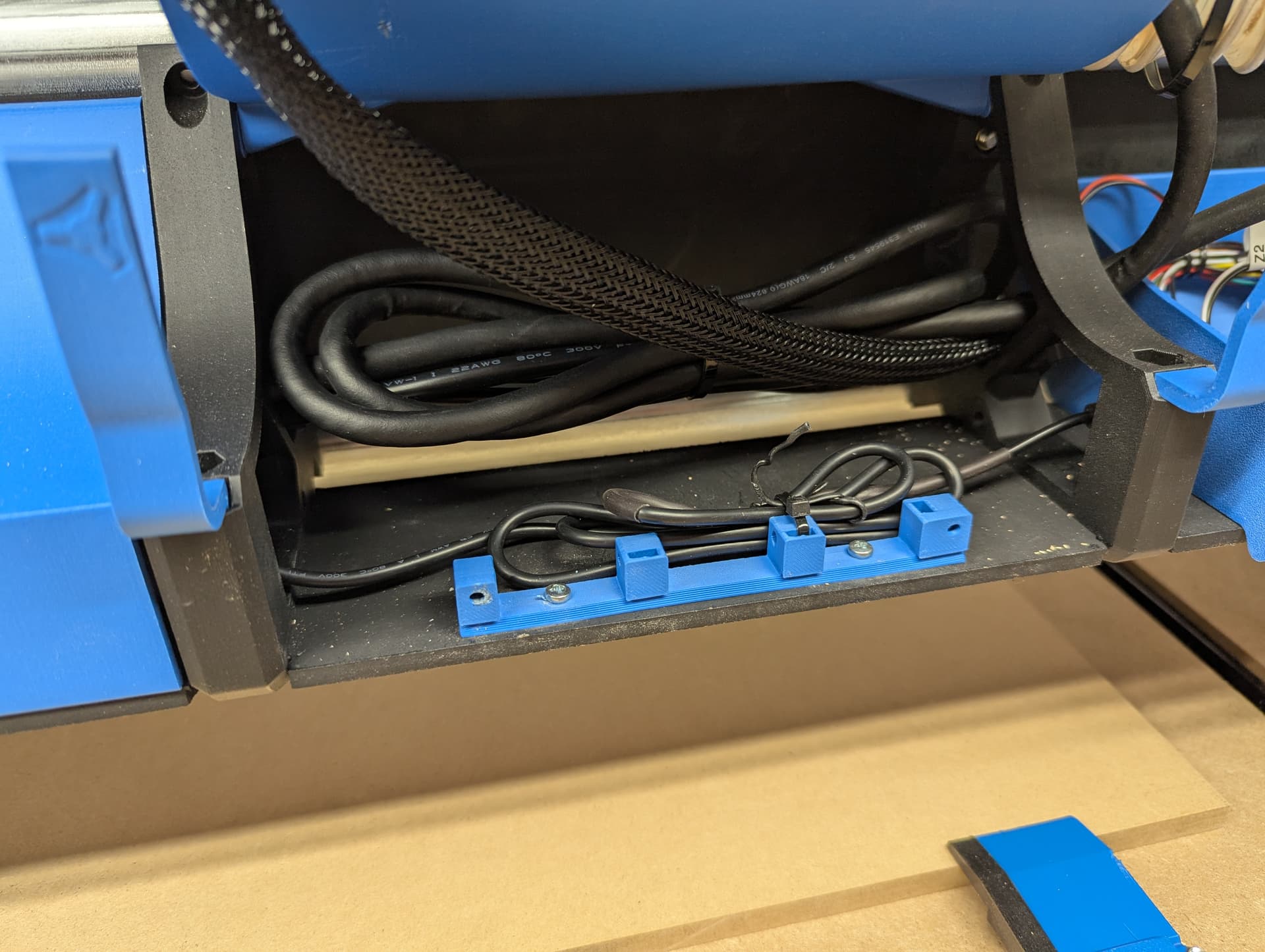

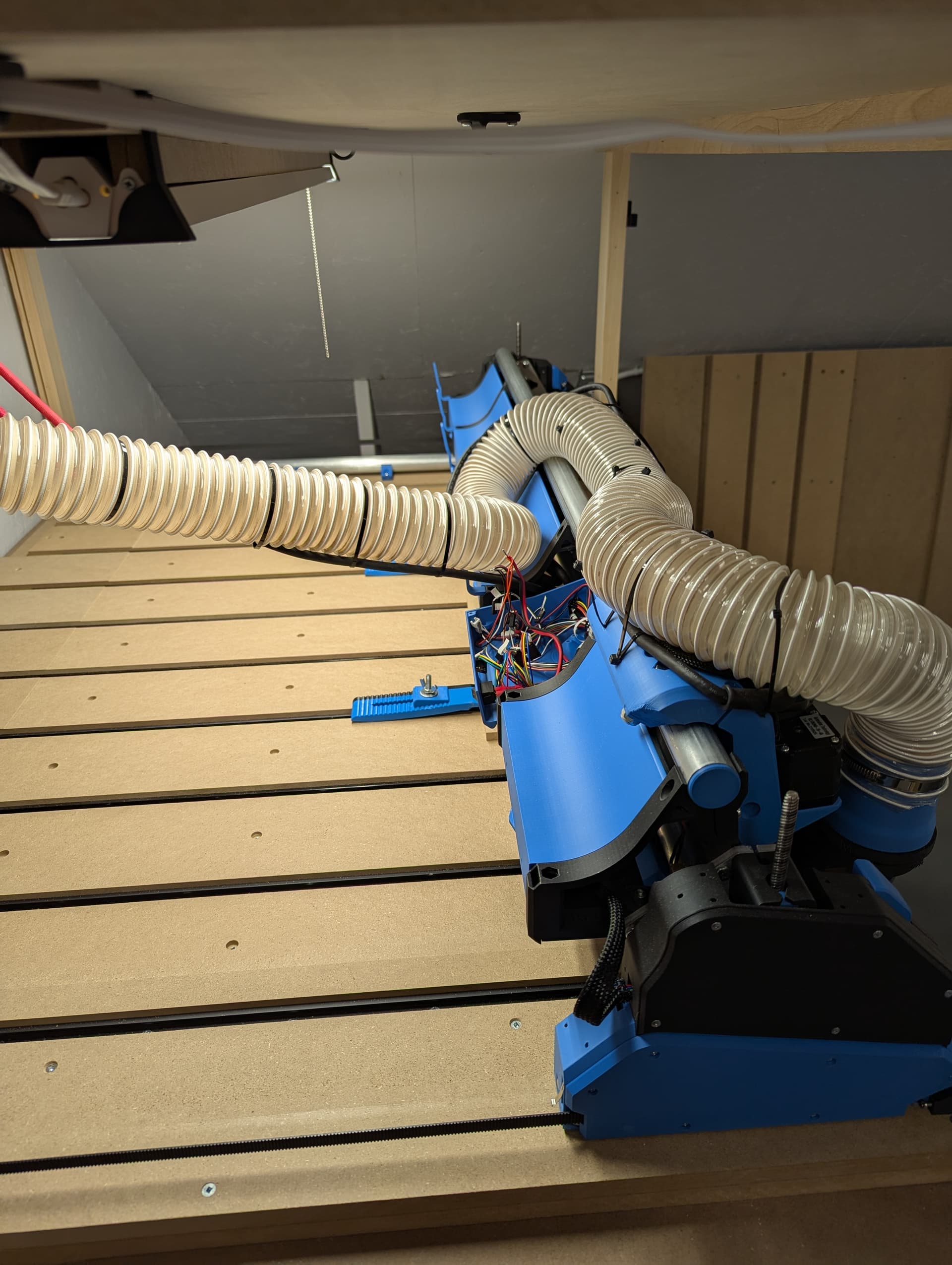

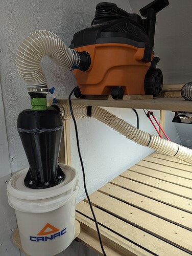

Here is my setup.
The probe wire enters and exits through the core using the standard path.
Then, it runs through the wire sleeve (purchased from V1) and follows the dust collection hose along with the router’s wire.
Then, it enters the controller enclosure and connects there.
Possibly an important detail: The power supply also provides power for a 24V fan and an LED strip to illuminate the work surface.
Finally, my dust collection system consists of a vacuum and a cyclone separator.
The next question is going to be is your vacuum hose grounded?
Looking a lot more likely at this point.
Definitely, I never thought that this could generate static and potentially damage the board… But when you think about it, it makes perfect sense. Especially since I just realized that even the vacuum doesn’t have a ground…
In your opinion, would wrapping a bare wire around the vacuum hose from the LR4 to my cyclone and connecting it to the ground of a power outlet be sufficient?
That coil in your hose should actually be metal, diggin out some of that at one end and grounding it should be a good enough ground.
If you ever touch that cyclone right after milling you will feel how much builds up, I am down right scared of mine. My hose is grounded but not my bucket, that thing packs a punch some days.
