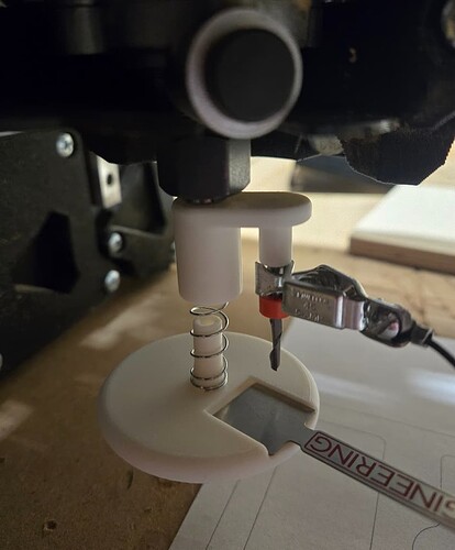

The part that kept me from going down the software side is that I’m not going to crawl over my table to probe a bunch of spots. I want to connect a probe that can do that on its own. There are those 3D probes but I don’t want to do that. I want to use my existing probe setup without having to disconnect anything. Plus, my spoilboard has cut marks all over so probing a tiny point would be misleading.

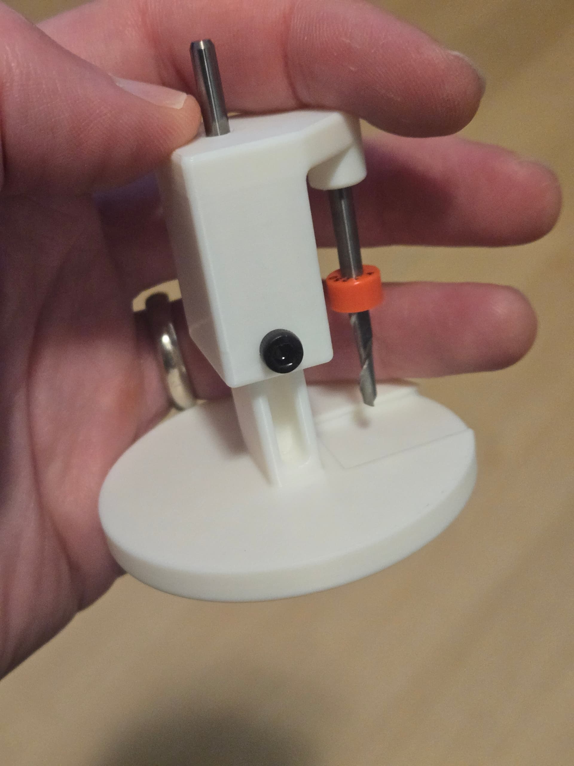

So, here is my current prototype. I haven’t actually tested it yet. It’s cold out there.
Currently, it requires 2 3D printed parts, 1 spring, 2 old 1/8" endmills, and the tiny touchplate.
One endmill goes in the top to connect to the collet. Another goes in the spot off to the side. The tiny touchplate slides into the base. The spring connects the 2 3D printed parts.
I need to adjust the length of the 3D printed parts to help keep it straight and maybe get a different length spring, but it seems like it will conceptually work.
And actually, it could perhaps be modified to incorporate a 3D printed spring. The spring doesn’t need to be strong at all. It just needs to ensure the base is pushed away (which gravity may handle) and also keep it from coming separated from the other part.
Thoughts?

so how repeatable is it? looks like there may be a lot of variance in it. I like the simplicity though!
I don’t know. It’s an untested prototype. :laughing:
Once I update the parts/spring so they overlap more, I think it will be pretty accurate. The top part is quite rigid to the router. The bottom part is going to hit the bed and all the spring/overlap needs to do is make sure it lines up.

Needs to be larger and a bit more rigid.

I came up with something that just presses on to a 1/8” endmill and I can just connect it to the jackpot probe port. It does suffer the issue you point out where a probe point could fall on to a hole. I do really like the idea of just reusing the v1 probe though. I’m starting to get in to engraving so I’ve been playing with a few ideas. I’d like to see if perhaps the same(or similar) visualization that klipper provides could be provided. It would be cool to have a visual representation of the flatness of the board.

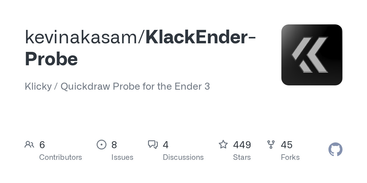

I was always impressed with this simplicity, but i had already bought a crtouch before i found it. Maybe it could help inspire an idea!
I put one of those on my Ender 3
Same thing I have on both of my ZeroG builds too. Works awesome.

Well, I guess I want to finish pursuing my current idea. This uses the same clip and touchplate from the V1 kit. If I use something else, I may have to disconnect that to connect this. With my current idea, especially if I can get a 3D printed spring to work (experimenting now), you would literally need to print 3 small parts and use a couple old endmills (or I can buy some 1/8" rod to cut at the hardware store for $1.79).

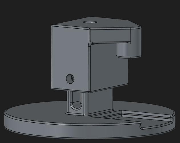

I haven’t printed this yet, but this is what I’m trying next to try and not need a very specific sized spring.
With this version, I’m going to see if gravity is enough to make the bottom part go back down. If not, I’ll try adding a pen spring around the endmill that attaches to the collet. With it meeting up with a rectangle, this will solve a problem with the original model where it wanted to spin a bit. The holes on the sides are for short M3 (or close-ish equivalent) screws to limit travel.
It’s binding a bit. I think once I extend the bottom piece a bit higher and reduce the gap between the sliding pieces, it will work. The pen spring definitely helps.
I have been able to lightly sand parts that slide into another and make them slide much smoother. I think it just smoothes the layer lines out and makes a noticeable difference.
