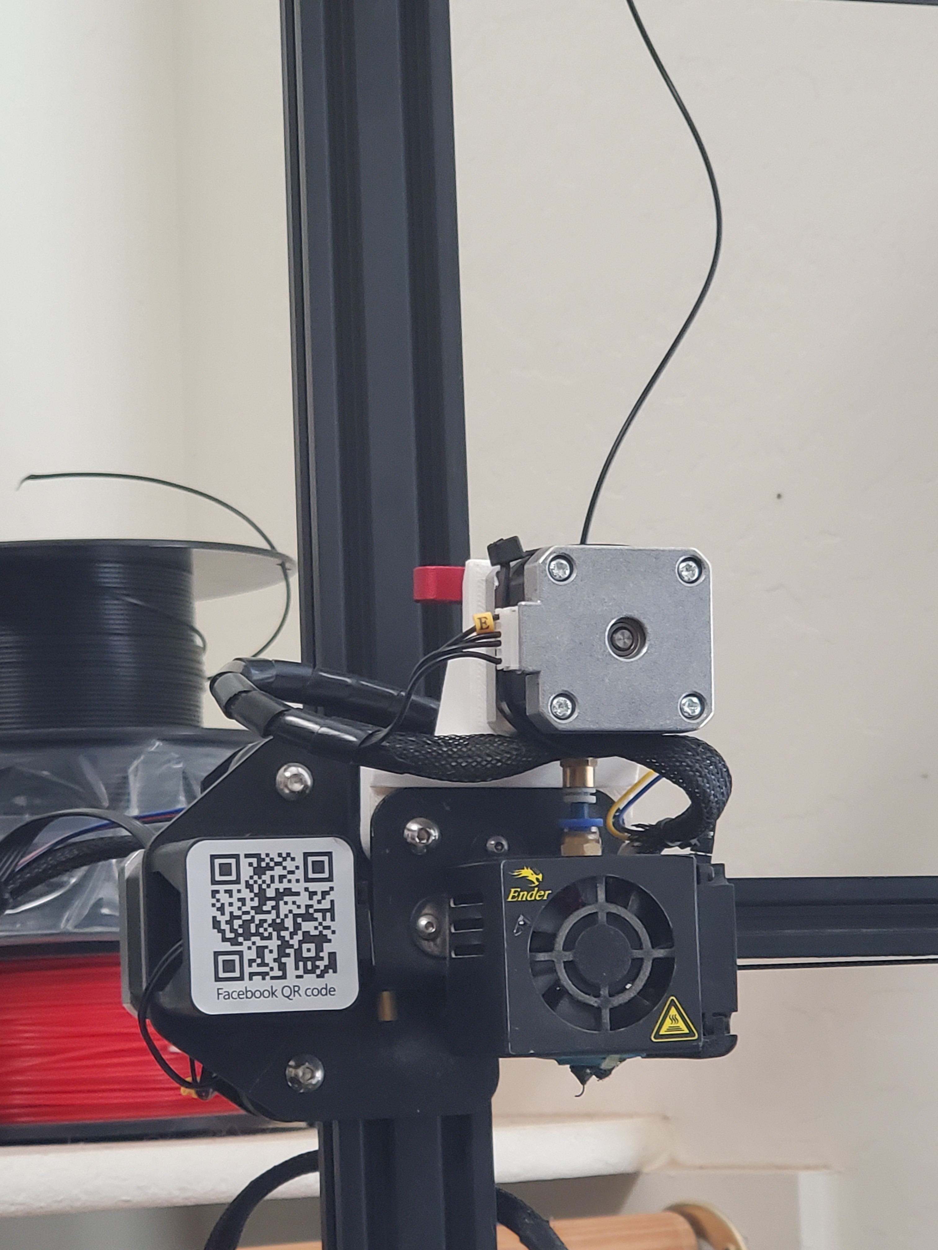

Have you tried Linear Advance? I’ve found that good L.A. setting allow me to lower my retraction distance a lot. But, I’m using a direct-drive extruder, not a Bowden setup.
Both of those are on my list… what direct drive do you have?
I have an ender 5. I used this to convert to direct drive and it has worked great.

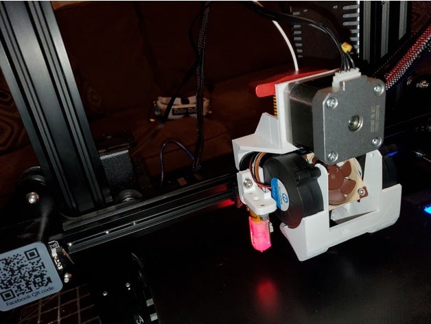

There is also the speed drive on thingiverse. Somebody remixed it into speed drive mirror, so the motor hangs to the front.
The original was designed to minimize some sort of inertial forces, so it hangs the motor off the back and you lose some x travel. The mirror gets that back, but also makes it a little challenging to load new filament. I need to put a mirror out something on that shelf, lol.
This is the mirror, the original is linked in the remix reference.
Cost of the print and a little extra wire to extend the extruder connection, reuses all original hardware.

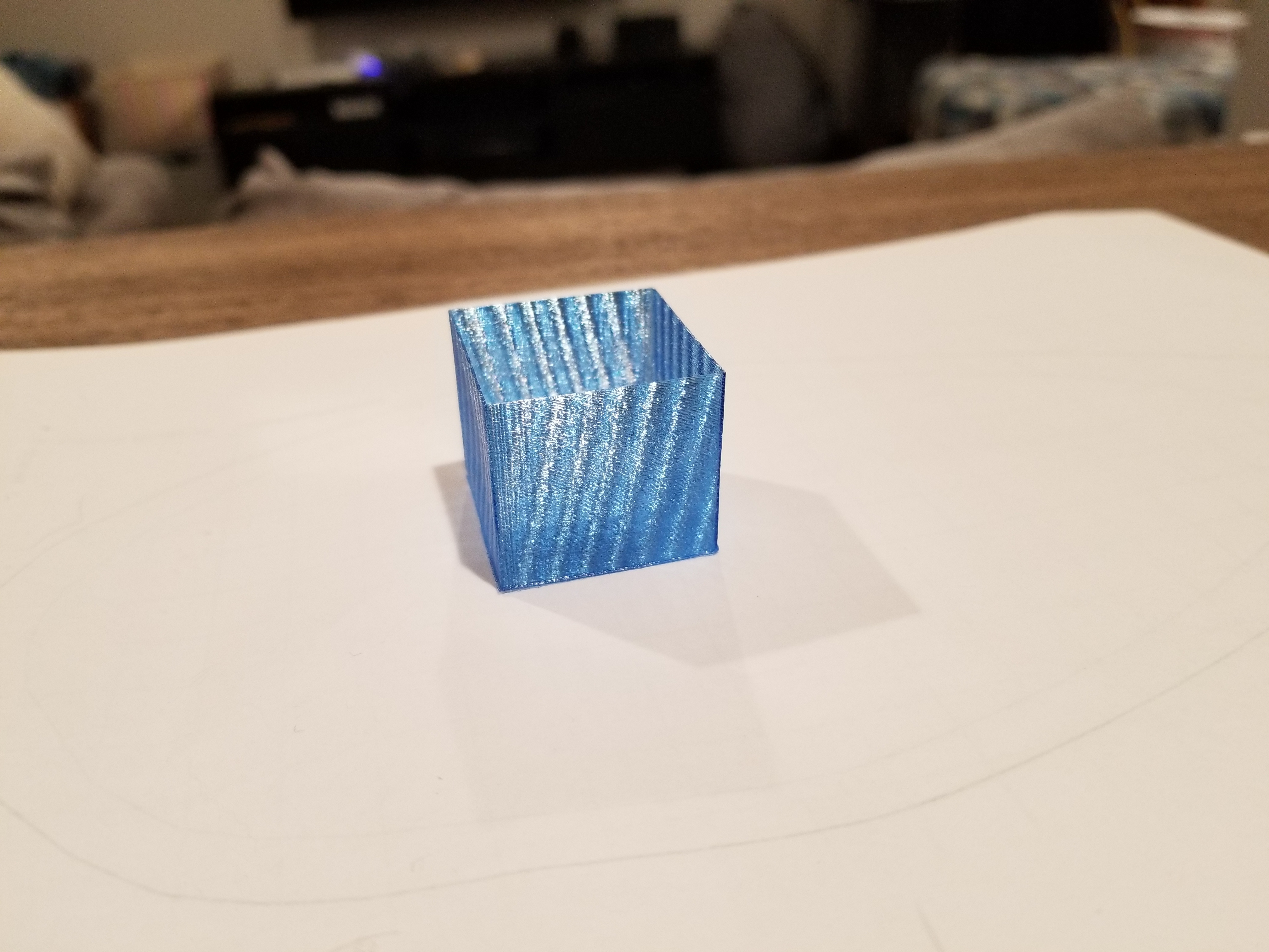

I’m using the Prusa R4 extruder on an i3 Mk2S clone running a RAMPS 1.4 board with A4988 drivers. The extruder uses dual BondTech style gears to drive the filament through an e3D V6 hot end. I was getting regular pulses of alternating over- and under-extrusion with the standard .7 volts vRef which resulted in a moire pattern in prints like this test hollow cube.
I’ve lowered the vRef several times since that print. I’m now down to about .45 volts vRef, which translates to .9 amps on the extruder stepper. I think I may go down a bit more. Interestingly, lowering the amperage hasn’t impacted the maximum volume I can put through the extruder.
This was tricky to figure out, as my E steps/mm were confirmed as being right-on by measuring 100mm of filament input for 100 mm of commanded movement, but parts still came out off of dimension due to the pulsing, which isn’t nearly as visually obvious on irregular shaped parts.

Quite some time ago, I set all the stepper drivers on my home-built Prusa i3 R2S clone to the same vRef, and now I understand why I’ve been chasing my tail trying to get things dialed in. Last night I tried tuning things by the seat of my pants and got much quieter overall operation, but started getting layer shifts, which I’d never seen on this printer before. I decided it was time to research and solve this problem once and for all.
I didn’t just have to lower the vRef for the extruder. All my vRef’s were around 3x what they should have been, leading to hot steppers and very noisy operation. I thought I had a growly bearing on my X axis but was too lazy to break everything down to replace it. Now I’m glad I didn’t. Tuning the vRef completely eliminated that noise.
I had originally set driver vRef’s based on a “rule of thumb” that the vRef in volts should be 2x the desired amperage. Turns out that applies to DRV8825’s, but I’m running (probably clones) of A4988s. The proper vRef for A4988’s depends on what value resistors the manufacturer uses for Rs1 and Rs2. Also, I’ve got a mix of motors that have different current requirements, so I need to tune for that too.
Spent some time with the Stepper VREF calculator and now I’ve got much more confidence that I’m in the right current ballpark for all my axes. Motors are cool enough to touch, and print results are vastly improved.

I modified the ender 3 to dual gear direct drive and found that the hot end was never assembled right. the nozzle and heat break tube were never touching which caused a lot of oozing filament. all is good now.
