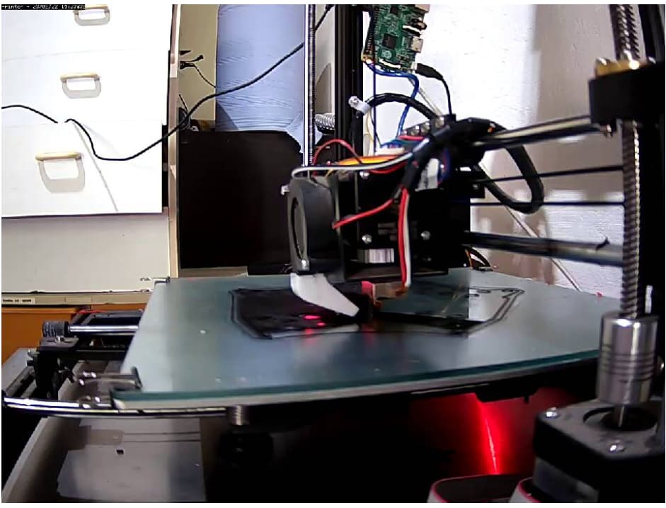

I just started printing them, cura 4.13 tells me they take 20:20 h to print on an Anet a8 Plus

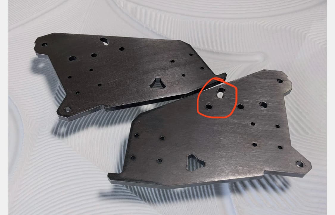

Did you notice the printed version has a hole missing compared to flat?
I’ve put a question up, awaiting confirmation that it’s ok
