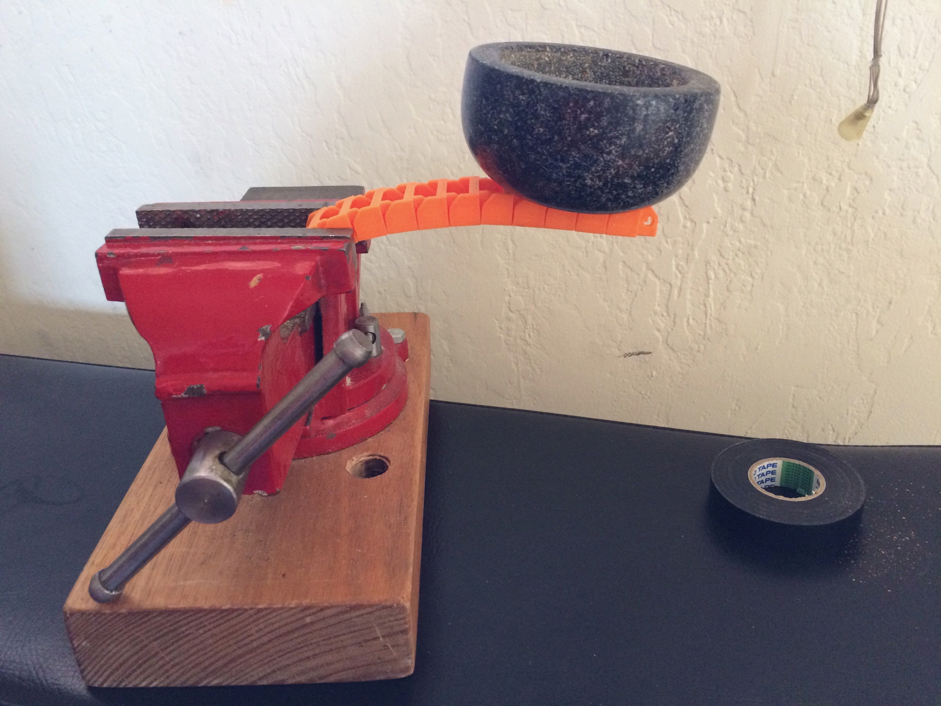

I redesigned a Thingiverse MPCNC drag chain and gave it several worthwhile improvements. If you intend to print your chains, check it out: https://www.thingiverse.com/thing:3117461

One problem I did note is there is a bit more horizontal sag, so not sure if they will be good enough for the z axis motor where they will need to extend out horizontally in mid air…

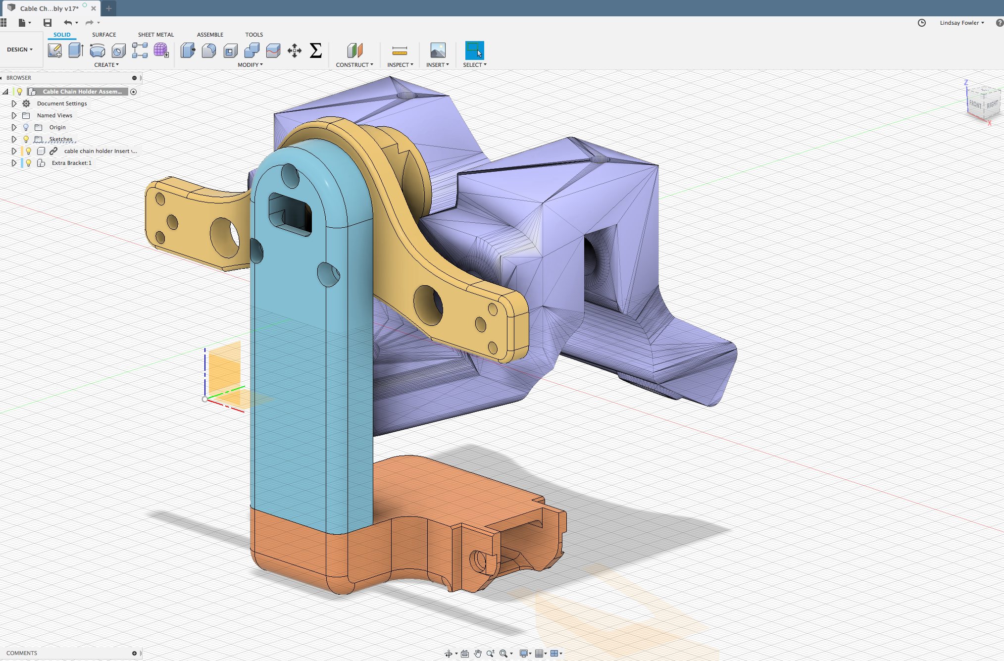

Now I am working on this mount, but Fusion 360 is causing me a bit of grief losing references as I refine it.

Fusion 360 hates me.

I’m not very good with Fusion 360 but if anyone wants the files for the end brackets they are welcome.
The top bracket does need some engineering though.
