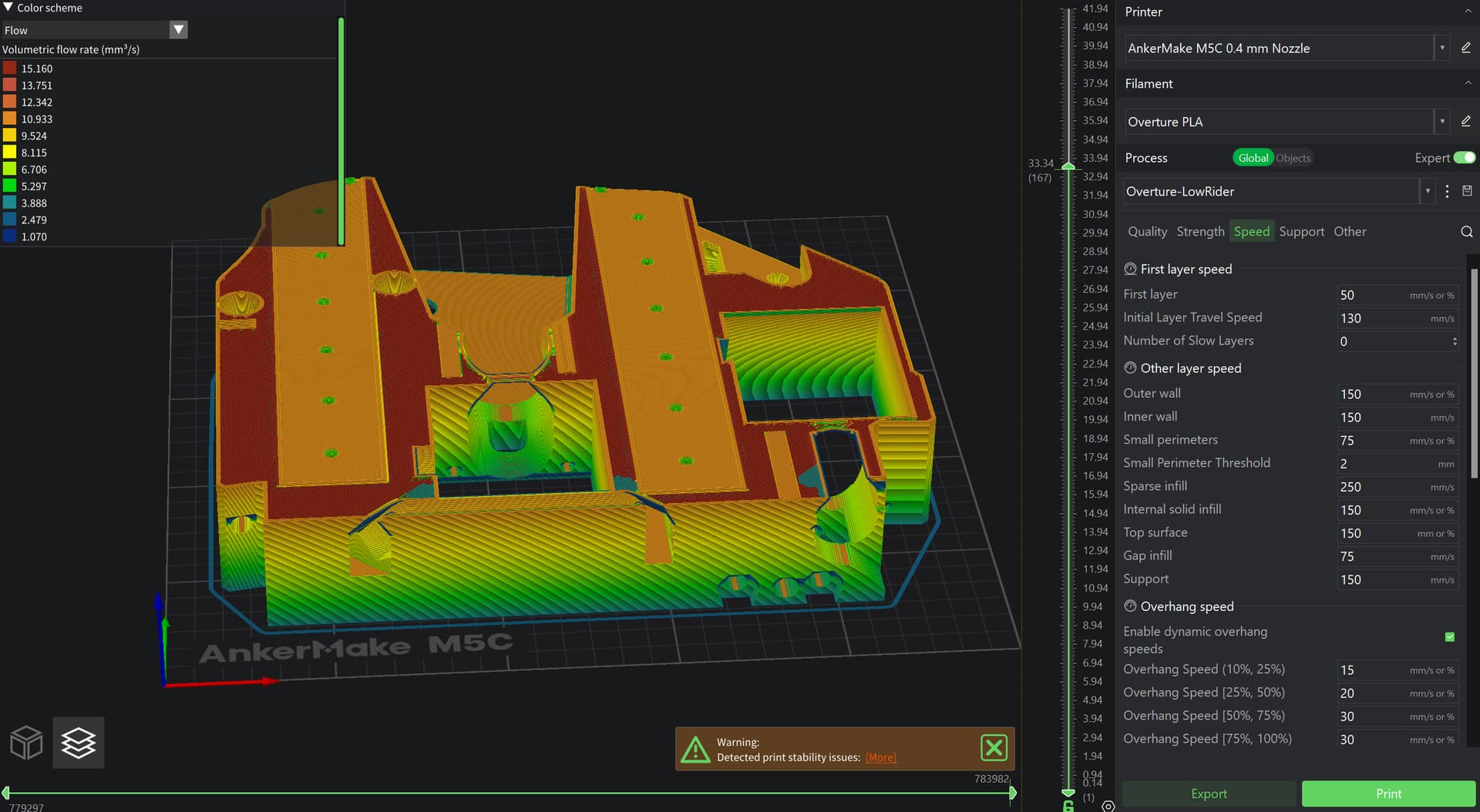

I have started a new 13 hour print with the following changes.
  1. Max Volumetric speed is 15 mm3/s. Instead of unlimited.
  2. I made the inner wall speed 150mm/s. This matches the outer wall speed. I had a thought that the inner wall may be effecting the outer wall.
  3. I added a glue stick layer to the print bed for better adhesion.
This added a couple hours to my print, but I am not too concerned with print speed or pushing the boundaries of my printer. I care much more about print quality. I just don’t want to have to go excessively and unnecessarily slow. If going a little bit slower than the printer is capable of gives me better odds of a higher quality print then I am happy to make that trade off.
Here is my flow rate and speeds

These changes worked great. Looked much cleaner and the print stuck to the plate way better than I have ever seen. It was great. I do still have some excessive budging on very acute corners.
The glue stick is a great trick to bring consistency to adhesion if necessary. I actually use it more to keep PETG and TPU from sticking too much. But it can be useful is I want more adhesion without adjusting bed temp, adding brim, or other tricks.
I keep an eye on the bed. I reapply when it starts looking like an area isn’t covered well, every 3-4 prints for me. YMMV. I do clean the bed completely once I’m done with those prints and start again for my next project.
