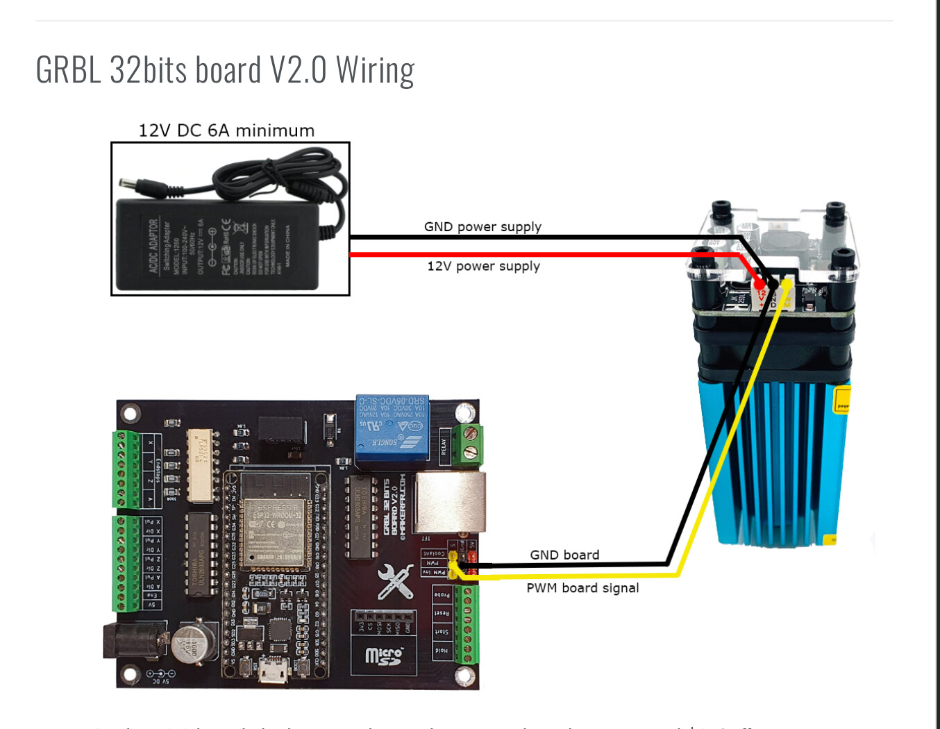

I have converted from a rscnc32 to a primo. On the rscnc, my laser module worked fine. It was wired like this
However, I needed to put a resistor between the red and yellow pin according to their forum. This worked for years. Now built a primo with Jackpot board and trying to use the same laser. I have it wired similarly but no resistor. I have red, green and black wire. Red goes right from +12v ps to the laser, black is in - on gpio27 and spliced into the - on the ps. Green wire from gpio27 5v to laser(yellow in the pic). Laser powers on(fan runs). Config has laser section with no errors on loading but can’t get the laser to fire

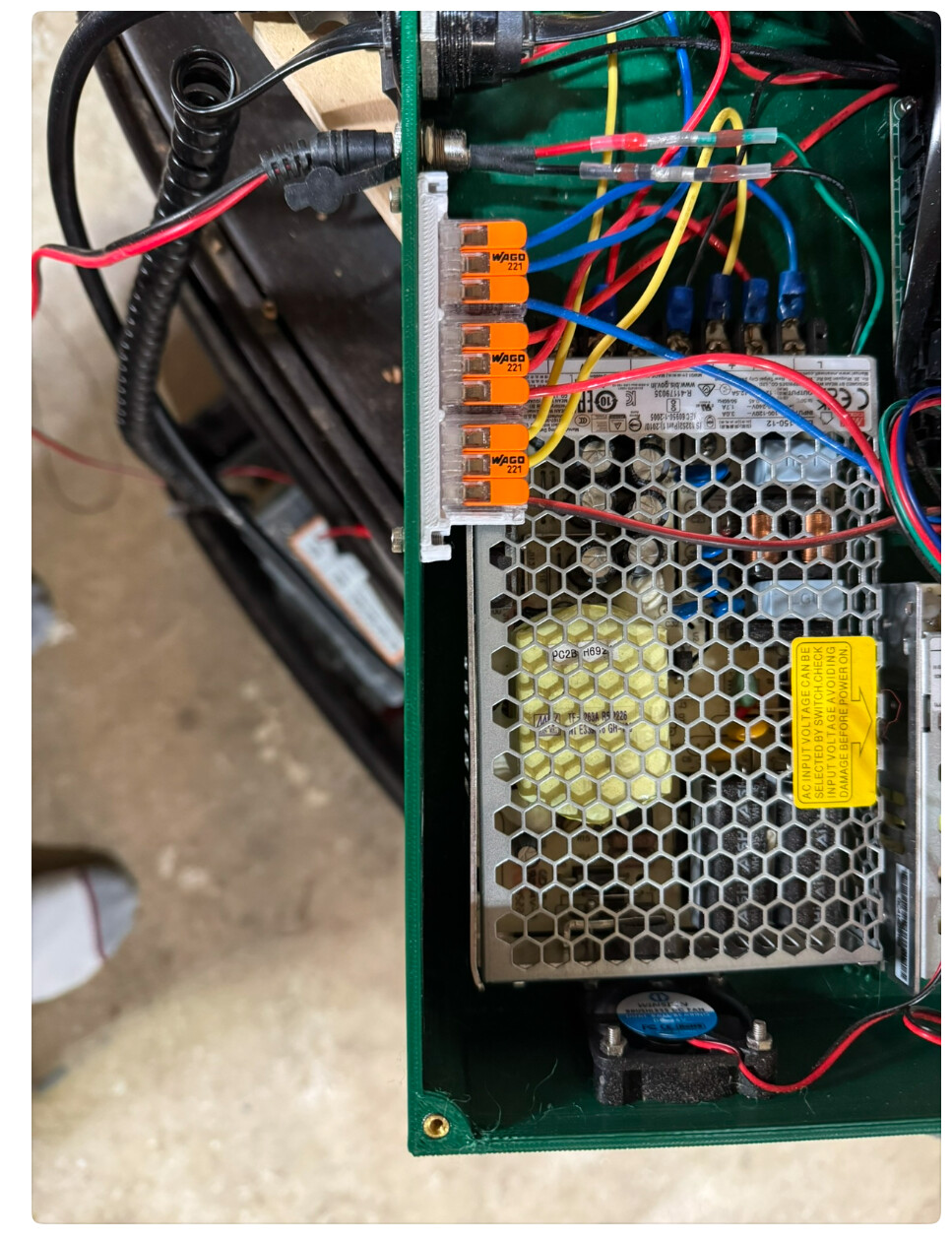

Here are some more details. This is a 12v dedicated power supply for the laser that is also wired to an on/off switch

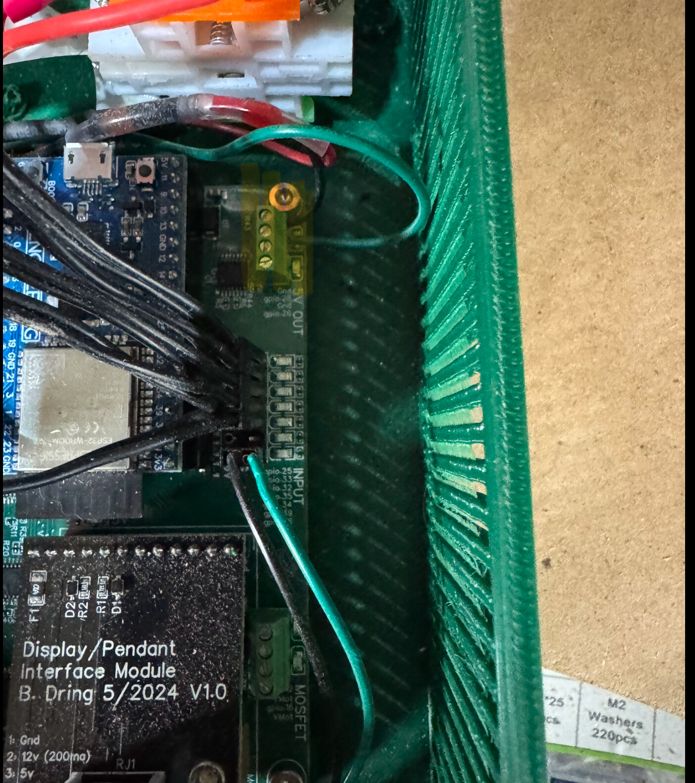

Here are the green and black wires in gpio27. The black wire is spliced in with the 12v neg ps terminal.

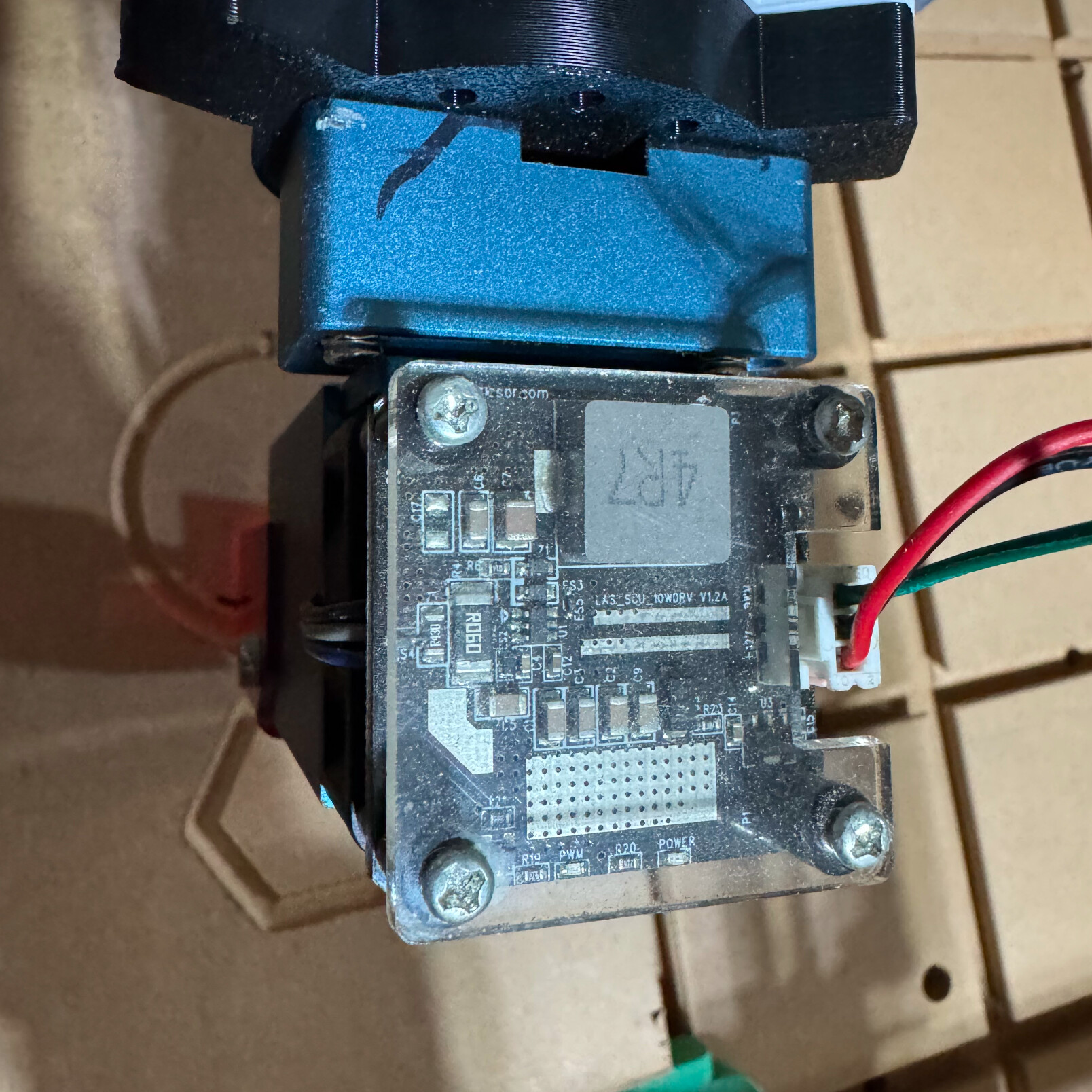

Finally here are green black and red going into the laser.
Again, no specific Jackpot knowledge, but if this was my problem, with the power to the control board off, I’d disconnect the laser, connect a multimeter to pin 27 and ground, and then send laser commands at various PWM values. You should see the voltage vary depending on the S value. This will give you an indication of whether the issue is with the Jackpot or with the laser.
In your config.yaml, is gpio.27 on any other line? If it is anywhere other than under the Laser settings, change it to NO_PIN.
