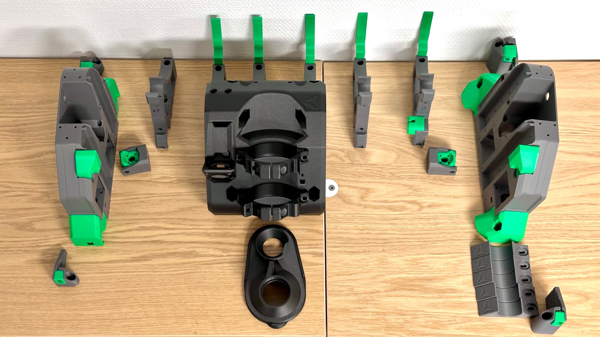

Printed Parts

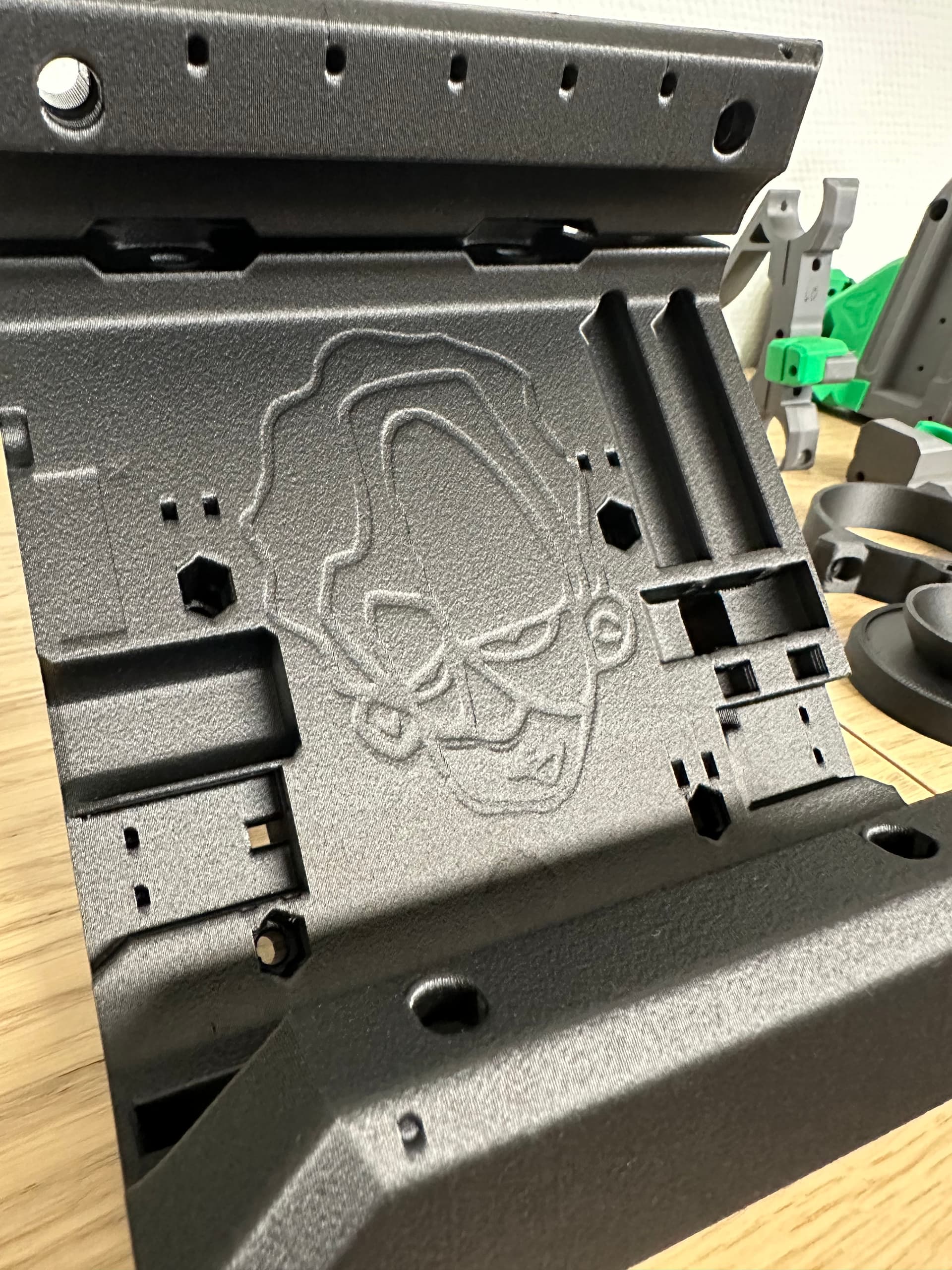

But when I saw the new LR4 design, I couldn’t resist from converting my Primo. So I ordered some spools of material and started printing the parts. And thanks to my quite new Bambu P1S (which I totally love by the way…) it took only a few days until I could marvel at these glorious parts.
To @vicious1 and all beta users: what a nice thoughtful design. Those parts feel so massive and sturdy. Wow…

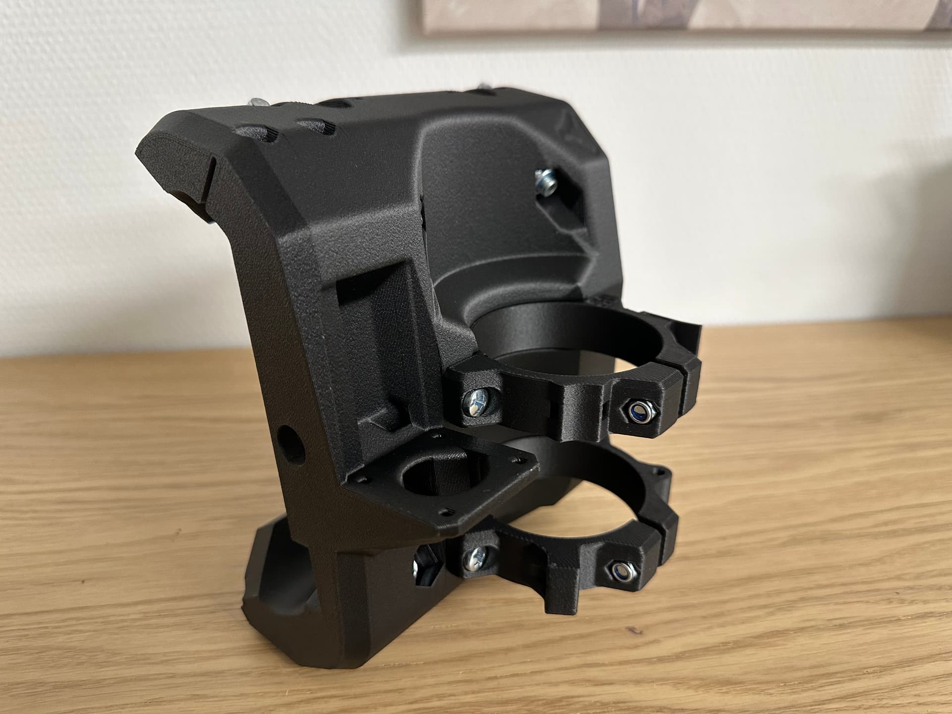

I know that it’s not needed, but I printed the core and everything that is attached to it with PET-CF. Purely because I wanted to know how well it prints on my bambu. And boy do they look nice. They came out flawless. Again, great design.
So now with all the printed parts ready, I started thinking about all the rest on the shopping list.

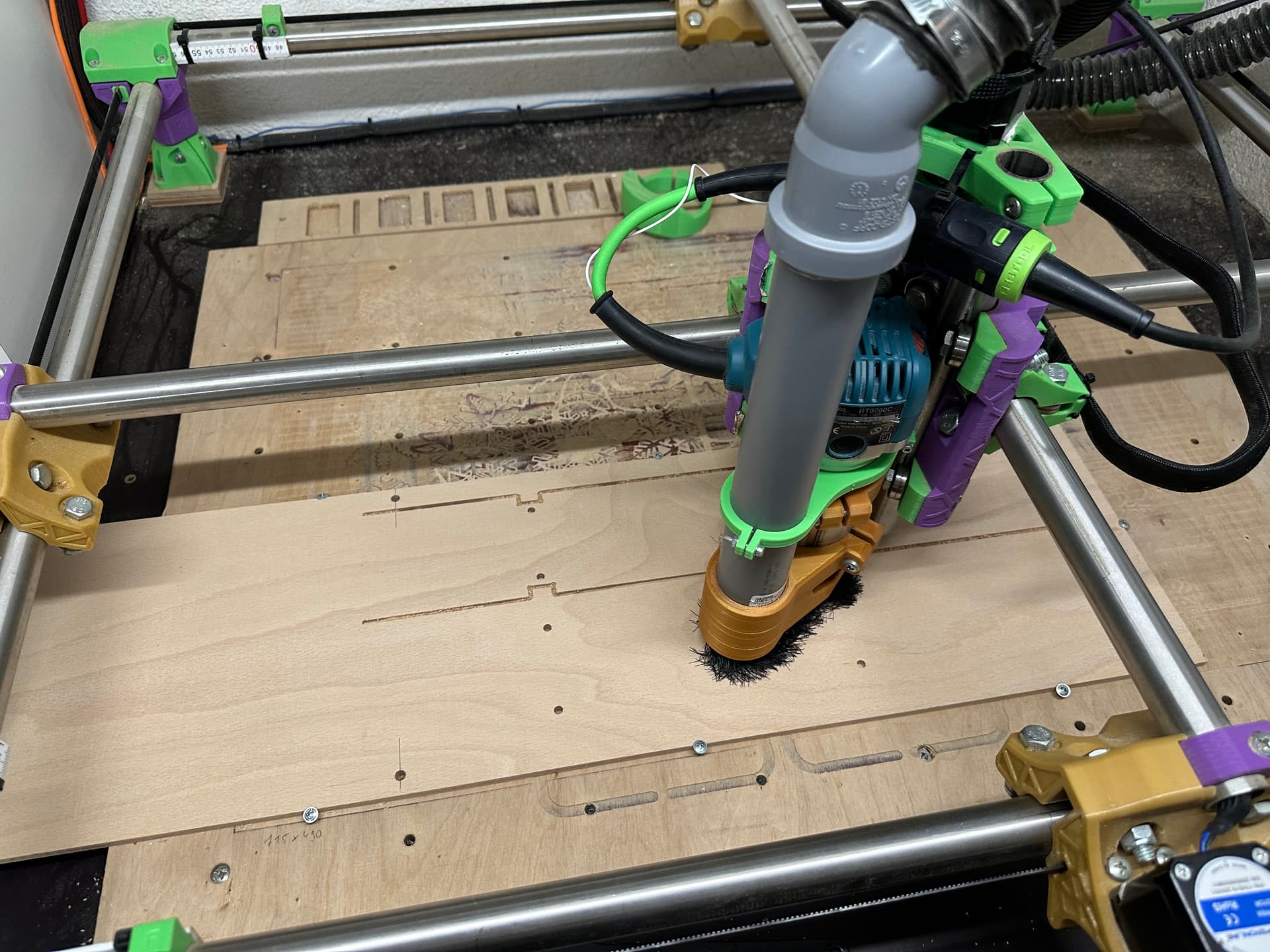

Strut plates

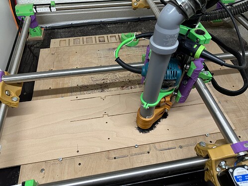

With my Primo still in working condition I started cutting the strut plates from 6 mm birch plywood. Because I only had 751 mm max working length and the strut plates need to be more or less precisely 969 mm, I had to do the cut-flip-cut with dowels trick. Thanks @Tokoloshe for the tutorial on that. Worked without issues (no broken bits this time :rofl:). Because my workshop has quite a high humidity, I coated the strut plates with some white paint I had still at home.

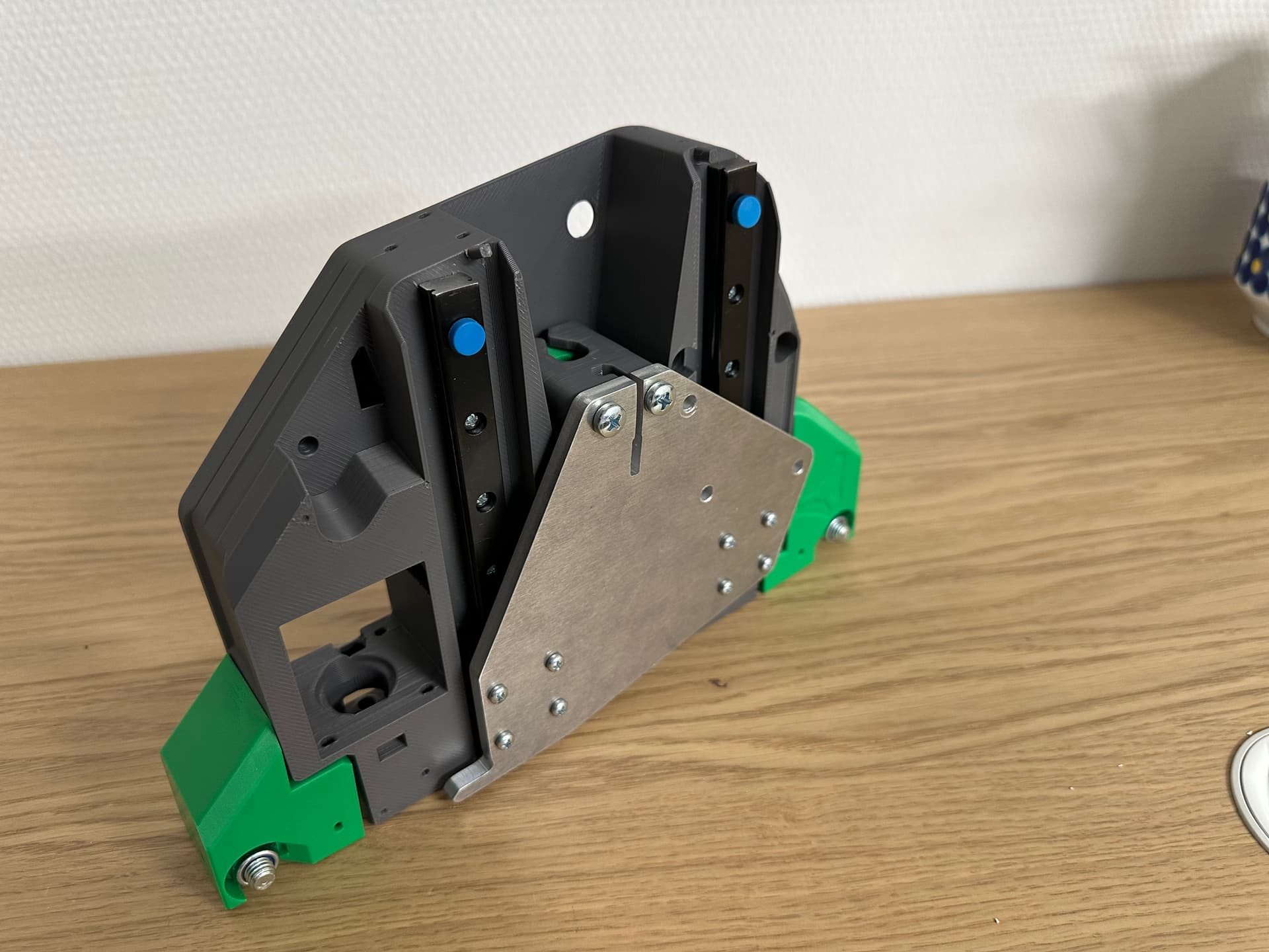

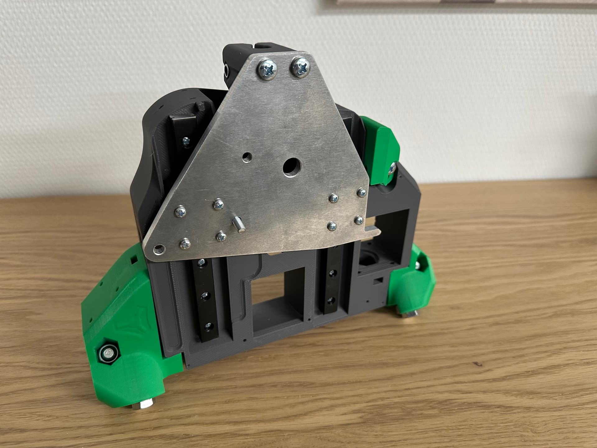

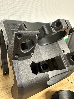

I didn’t break down my Primo yet, but was curious if the parts will fit together, so I started assembling everything mechanically. Ryan your design makes me speechless. The tolerances are so good, everything just slides together. :top:
The moment I put the core onto the beam for the first time was unbelievable. The core rolled without any play on the beam. I couldn’t stop moving it by hand. That felt so nice and much much stiffer than my Primo.

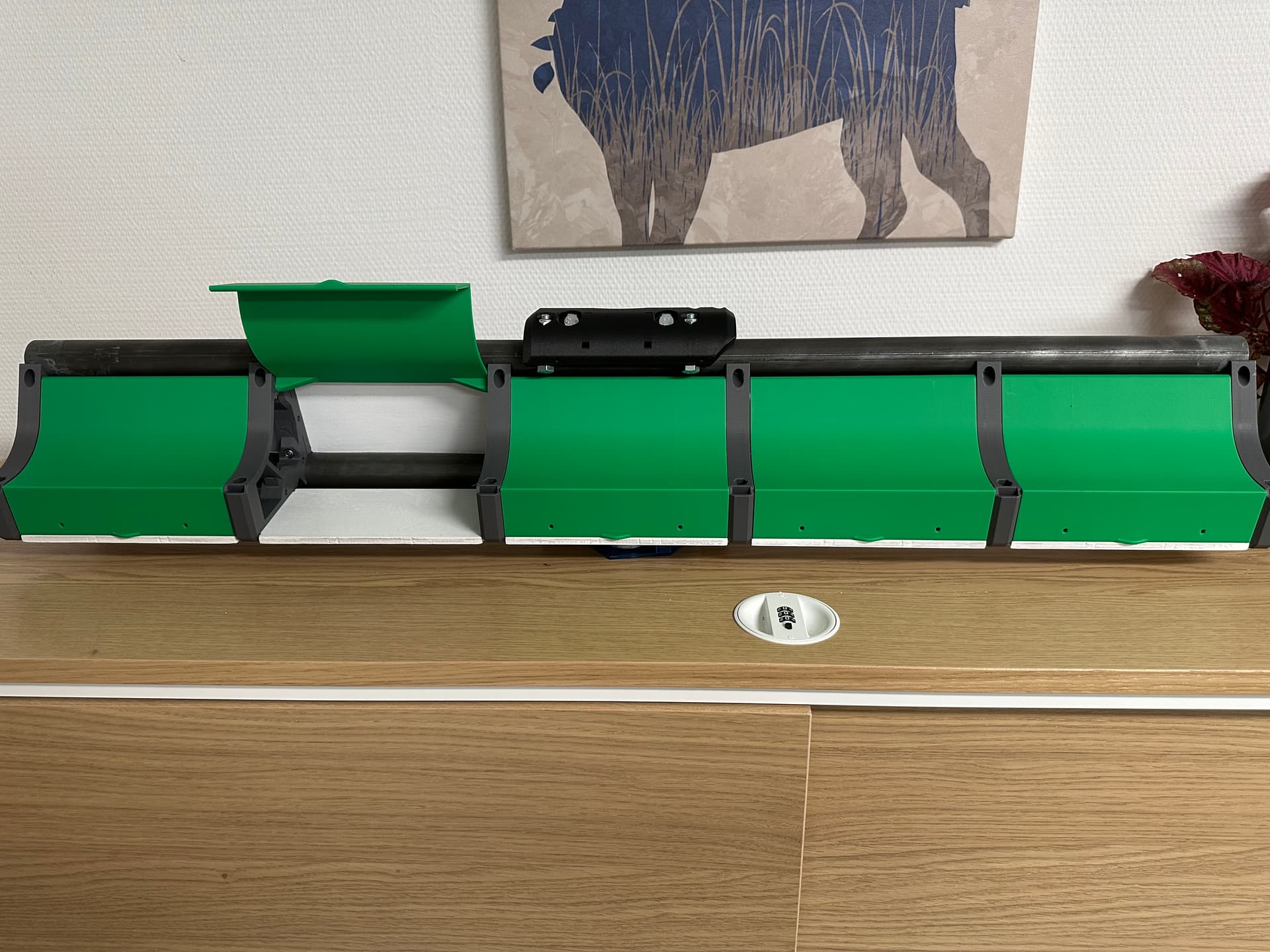

So here are a few more pics of the current situation:

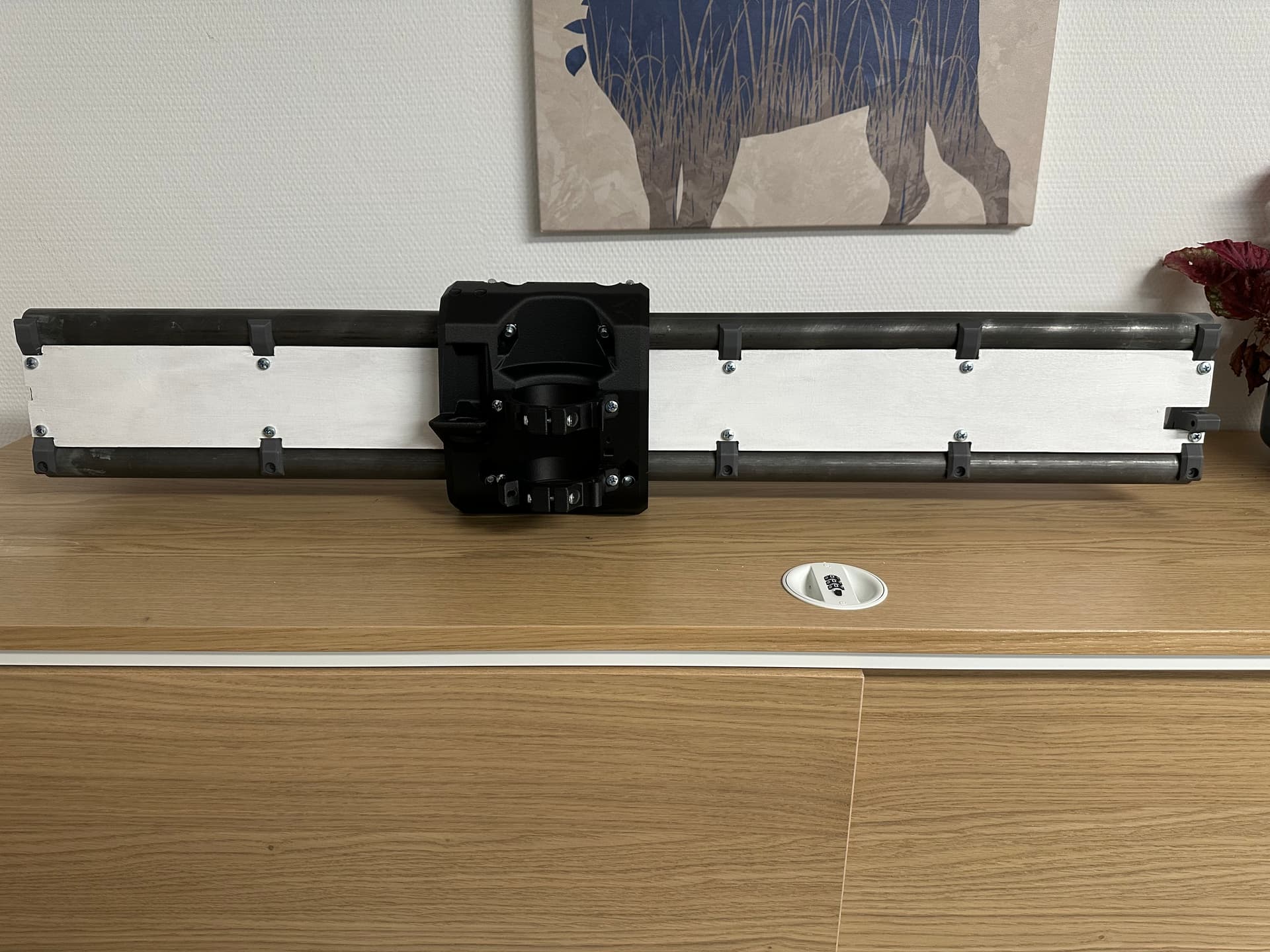

On the back of the beam, I will use the back plates by DougJoseph. Quite nice design, but they do not open that good with the 32 mm pipe. Maybe I need to trim down the top a bit.

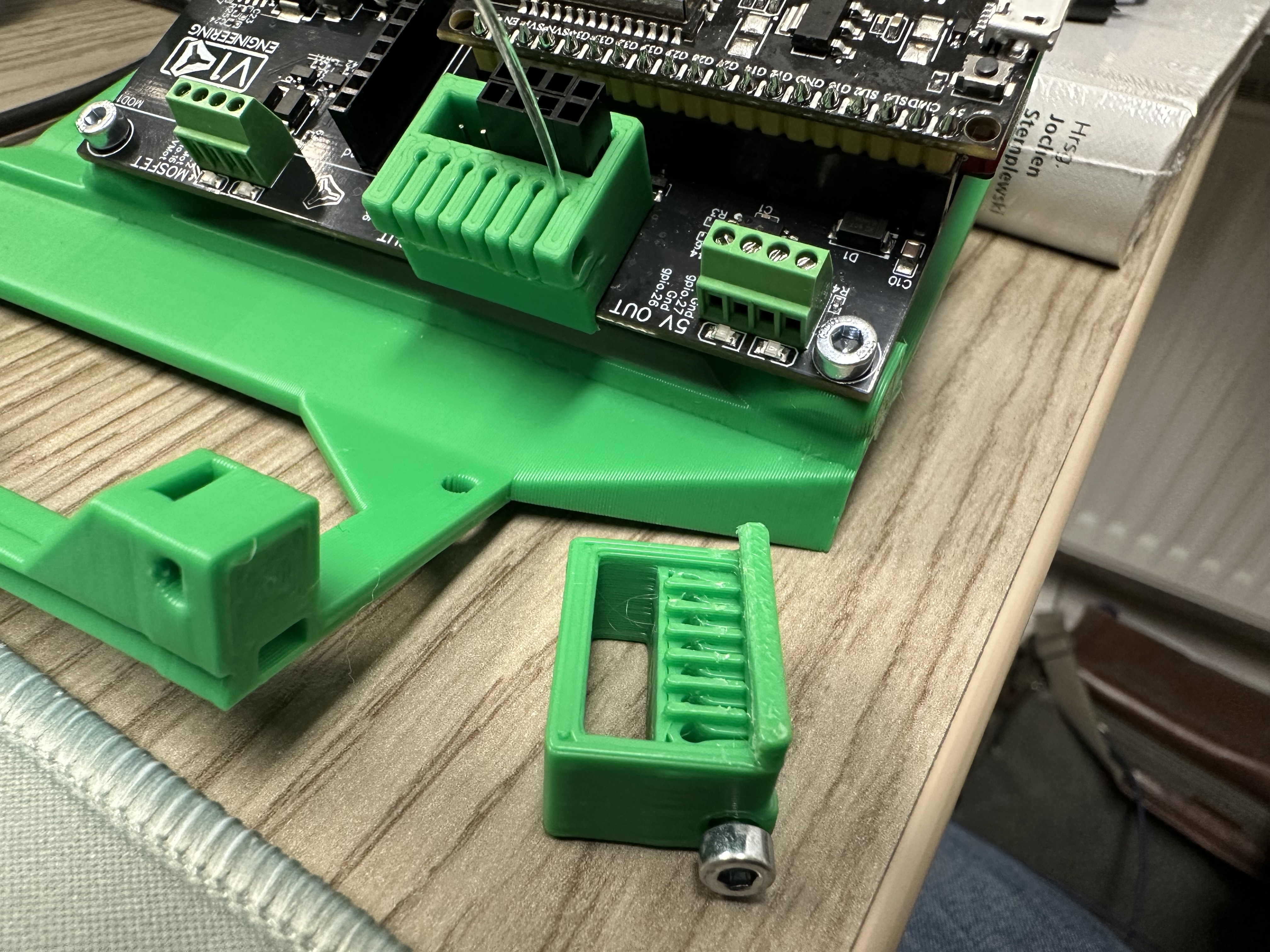

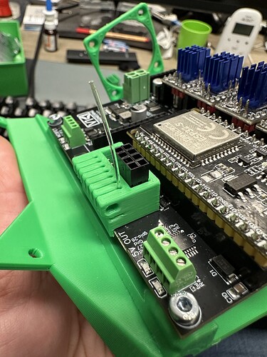

While I am waiting for some motivation to tear down my Primo, I started tinkering with an idea. @jamiek did this really cool jackpot box where he uses transparent filament to display the end stop leds in the front strut plate (see his build thread here [Jamie's LR4 RC2/RC3 Upgrade - #141 by jamiek]).
I really like this gimmick, but already printed @DougJoseph gantry back covers and jackpot in-gantry mount. So I cannot use the adapter from Jamie to attach the transparent filament to the jackpot board… and started designing my own version.
I do not have transparent filament, but I do have some old spare toslink fiber optic audio cables. The core of these cables is 1 mm in diameter, so thinner than typical filament, but it should be enough.
Here is what I came up with:

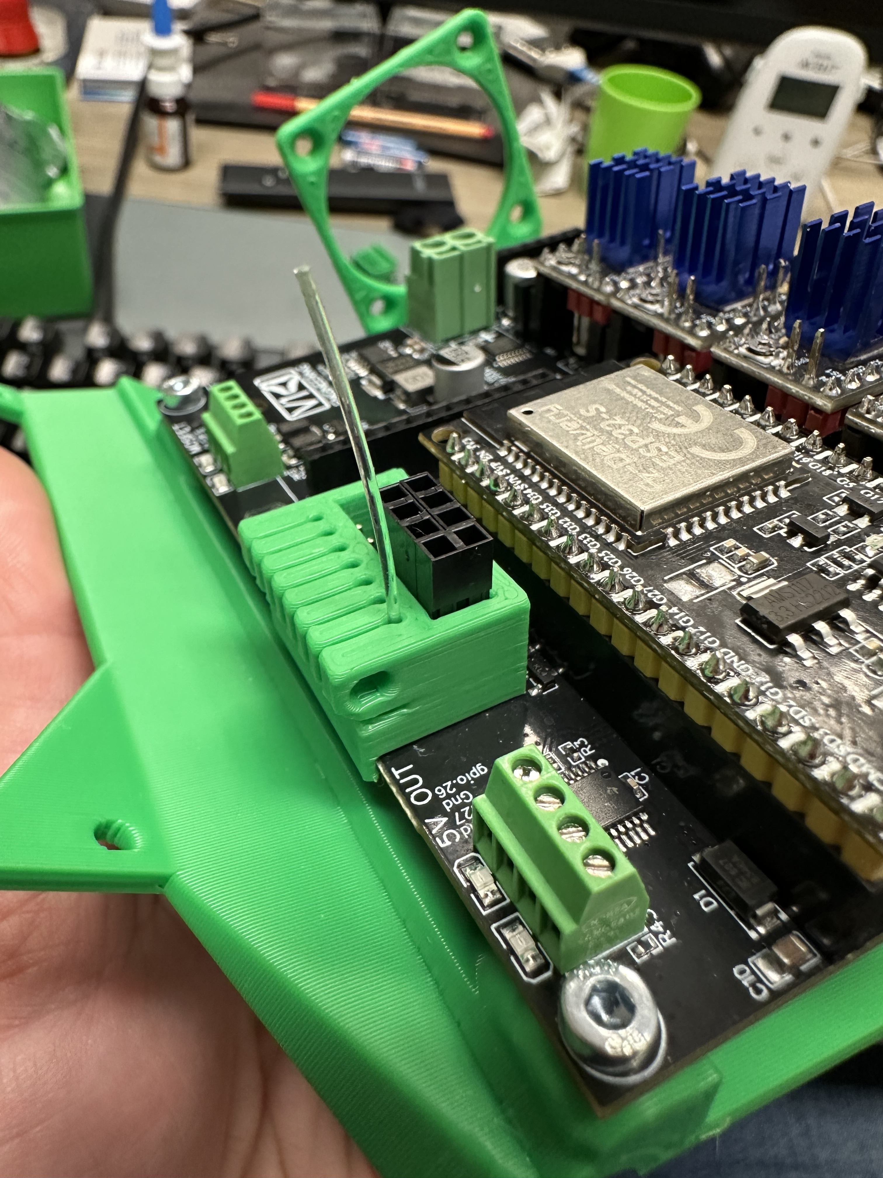

I designed a small adapter that clamps to the jackpot board by grabbing the DuPont connectors and the board itself (see the one mounted to the picture). It features small walls between the leds, so that they do not light up each other (see the one upside down on the table). The fiber optic cables can be secured with a M3 screw. The design is still WIP but I wanted to show it to you and see what you think.
I think that is going to work well.
Here is another picture with a better view
Wow, looks impressive to me!

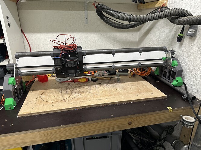

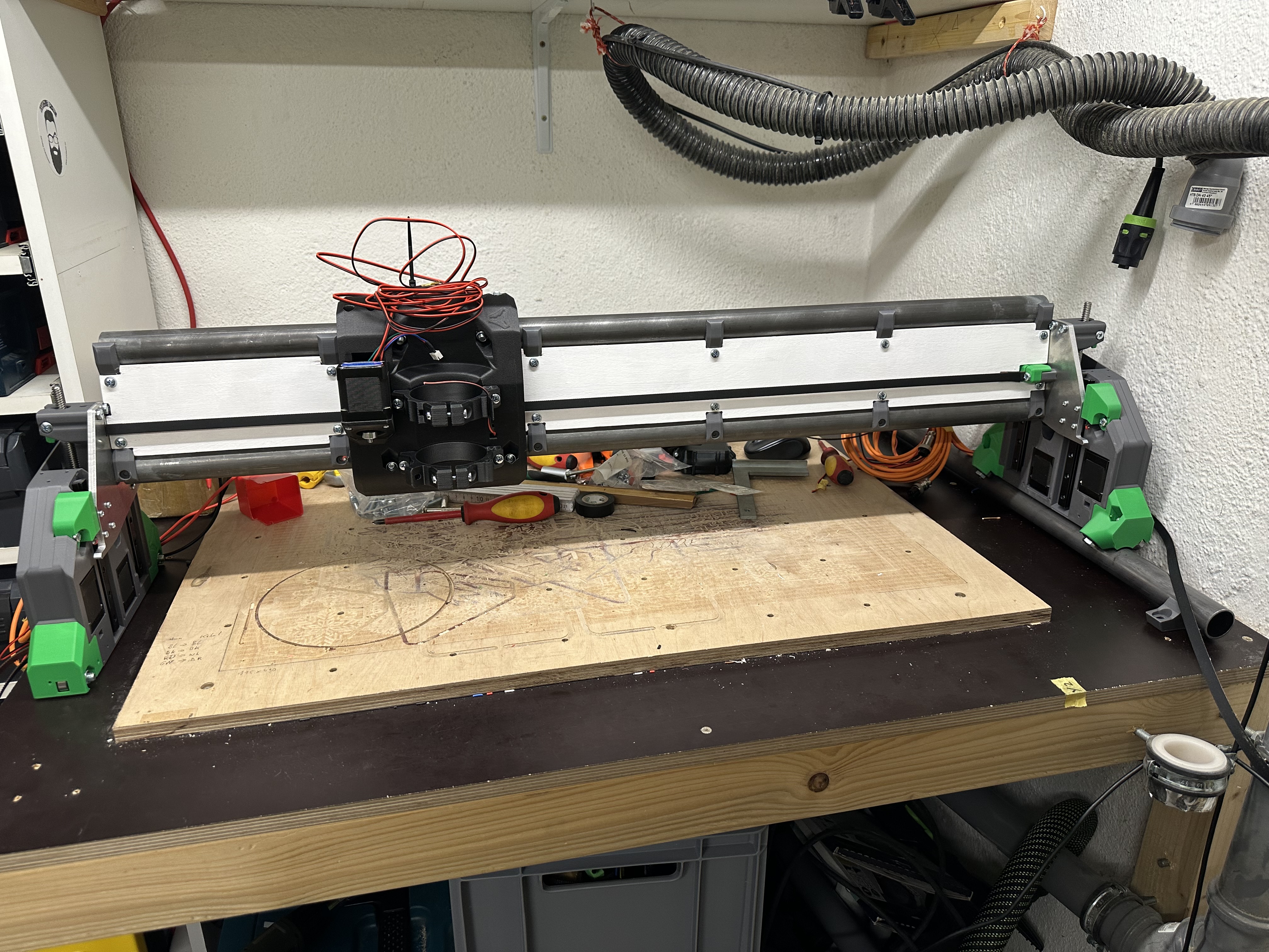

Just a quick update. I tore down the old MPCNC and started assembling the LR4. Two long sessions in the workshop and the main assembly is more or less done. It could have taken much less time, but my past me thought it would be a good idea to have some connectors near the stepper motors, so wiring the MPCNC would be easier. It was back then, but the XT-Connectors I soldered to the stepper wires with only keeping 5 cm long cables, did not fit into these tight cable tunnels on the LR4. So I had to solder the wires directly to the stepper motors, which took quite a while.
So this is the current state of the work (please ignore the mess on the table).
