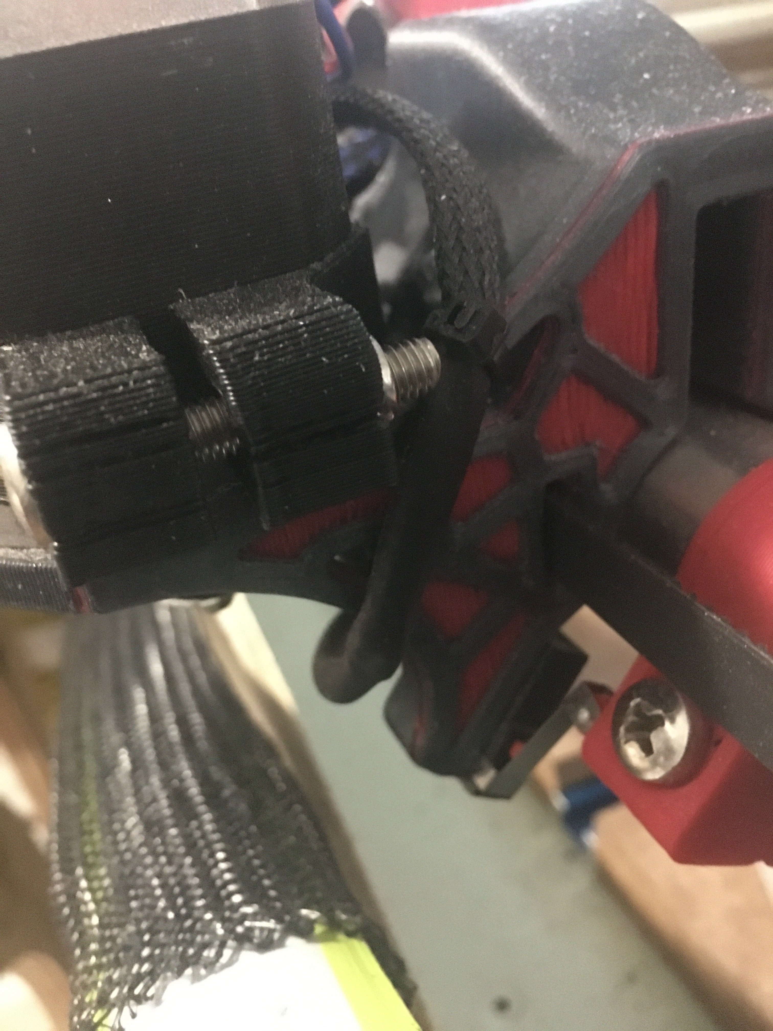

Hi,
Is there a nice way to position endstop cables on the primo ?
Cable may touch the belt or the middle bearing. Looks like it should be attached somewhere but I don’t know how.

This is how I have… use some zip-ties and you are done.

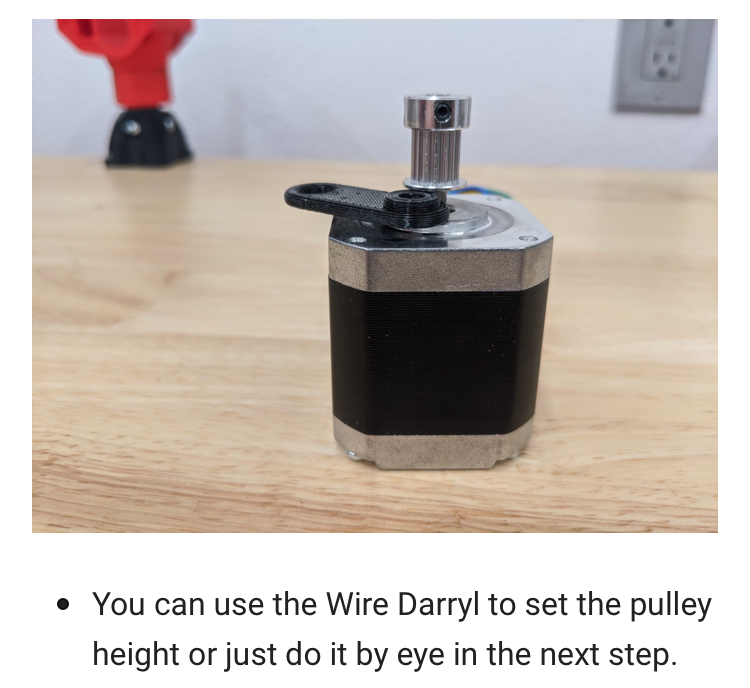

The wire Darryl is also used to set your pulley height.

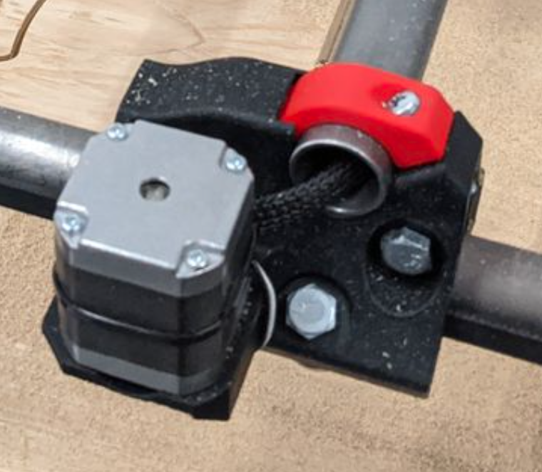

I dug into the monstrous topic and extracted this picture from Ryan.
Can someone point out the wire darryl in that picture?
@gividen the wire darryl is not in this picture.
My original topic was about cable management for endstops, and the picture shows how Ryan did it. I did the same on my machine.
As I understand it, the wire darryl can be used at machine corners : if you use it like a washer on the belt tensionner screw, it gives an anchor for cables along the machine. Personnaly I use drag chains for this purpose and I didn’t use the wire darryl.
