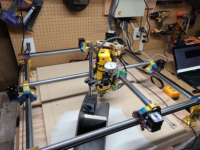

I decided to go with the 1" version with the obvious idea of getting the best accuracy possible out of this machine.
Everything went together very well. The plastic build time was 196 hours and the parts came out flawless. Ryan, your engineering skills are excellent! As parts were being built, I kept looking at how each part was designed, and well, I’m fully impressed.
I’m not going to say the build was easy. It wasn’t. The instructions come from the engineer who fully understand the intent and design of each part. Without that, in my case, I really didn’t understand the instructions to align the trucks properly. This cost me a ton of time.
I also found it somewhat time consuming to figure out where the Dewalt router mount was on Thingiverse. I thought it would be nice if that link was in the build instructions. I did finally find it, and the parts work flawlessly.
The rest of the build went well. Truly, I’m very grateful to have this new machine to find out what it’s capable of producing ahead. Especially with aluminum parts.

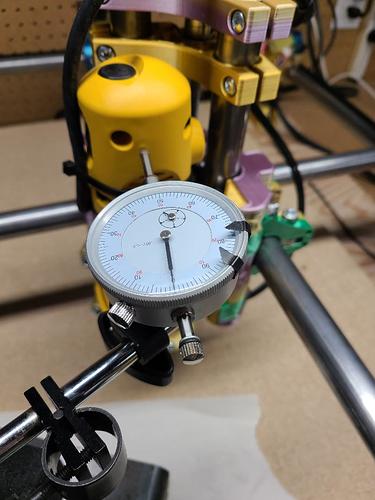

My first move of the machine was to find out how accurate it is, and wasn’t I surprised to find the repeatability of moves was close to perfect! I find this hugely impressive for a machine made out of plastic parts.
I set up a dial indicator as you will see in the photo and set the indicator at the x,y, and z zero point. Then I kept going back to home and then to the zero point, each time showing almost a perfect precision move. Each one was well under .001". That is amazing to me!

I cut my first pieces today. Four small 1/8" plywood parts. They came out PERFECT!!!
I am amazing by this machine. Each part cut is literally a carbon copy of the other. One thing I remember from the last build is that I had to go about tightening up the hardware periodically. I’m going to be interested to see if that holds true with this one.
The 1" pipe is really stiff! Even with the slightly taller legs, I don’t see any movement at all. I wanted to be able to get some taller parts under the tooling this time, where I couldn’t last time. Then, the router… What a difference! I was using one of the 500w china spindles, and while they were fine, (Yes, two of them), they didn’t have the speed or hp.
