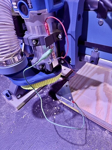

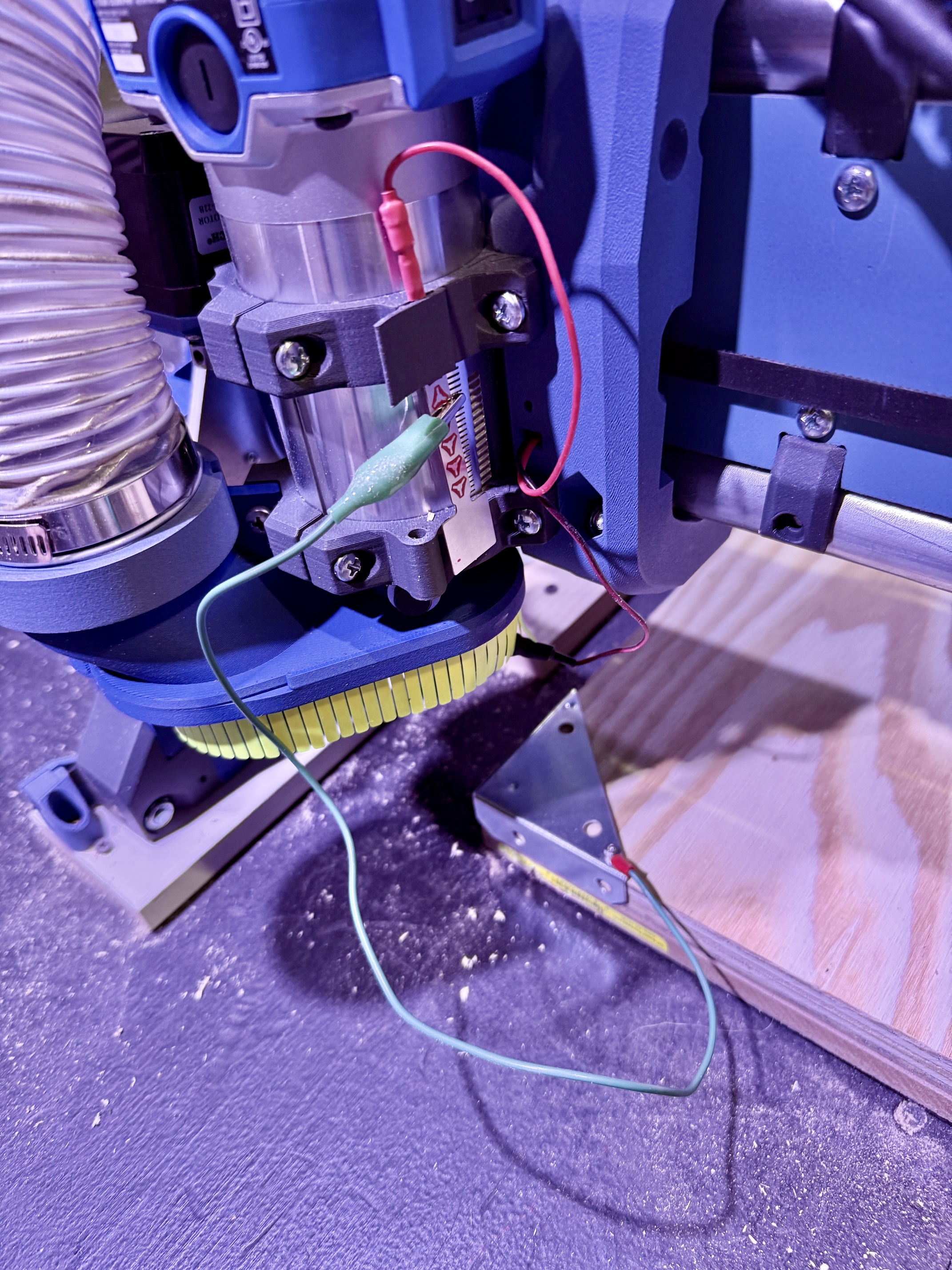

Follow up, Dec 20th, so I tested my “cheap- no milling required” 3-axis probing block and gcode last night. Albeit this was on bootstrapped rails screwed to the stage floor so that we could cut the torsion box frame. The probing plate and g code worked perfectly after minor tweaks.
Here’s a pic of the setup… Simple and easy to use when necessary.

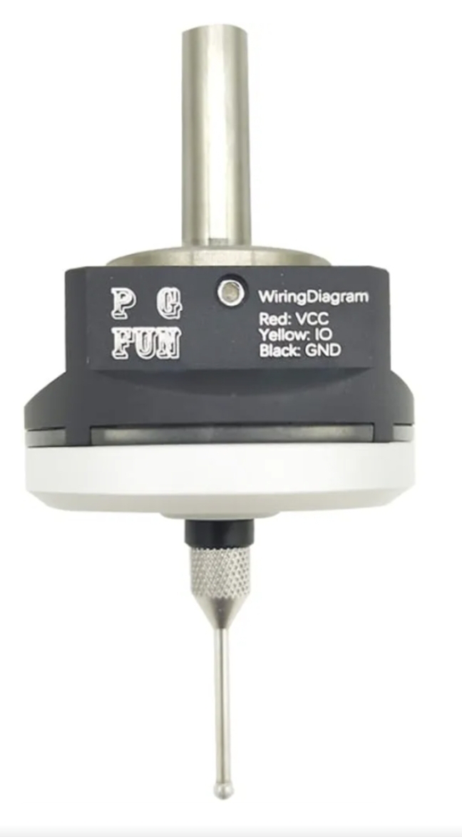

You can actually probe X and Y like you probe Z. I think this means you need to offset for the bit width. I wrote some gcode to do this once, but I never fully tested it. They make fancy probes for this, but I just did it with the tiny touchplate.

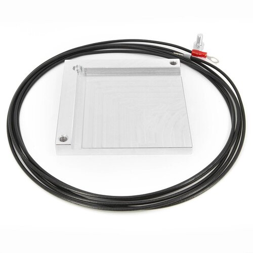

I’ve got one of those:
Cut it myself though. If @jeyeager has the code working for FluidNC, those are great.

I use aluminum tape on the corner to probe X Y And Z

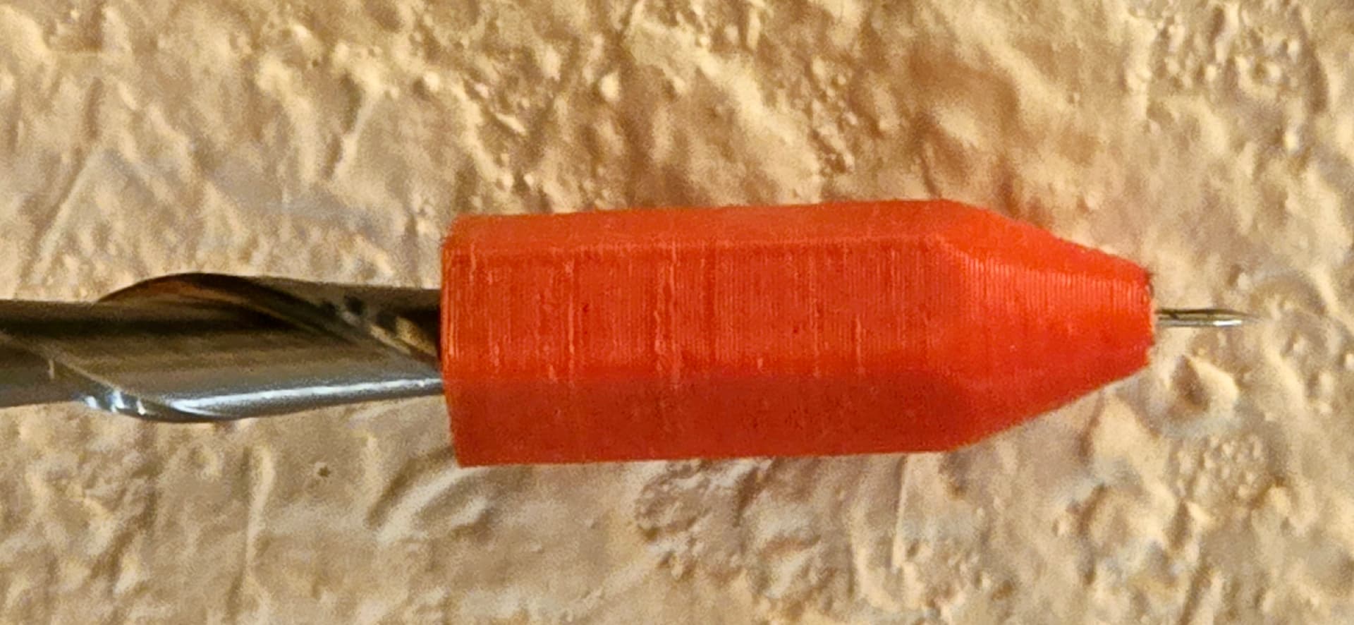

Another low-tech method I’ve used to find positions with 1/4 bits is a 3D printed endmill cap with t-pin inserted on the end. This is not as accurate some of the methods above, but it works for arbitrary positions, not just the corner of the stock. I’ve used this method to find the center of fixtures. I also use the cap to mark the home position on my spoil board so that if a stop block breaks or slips, I can find the current home again.
