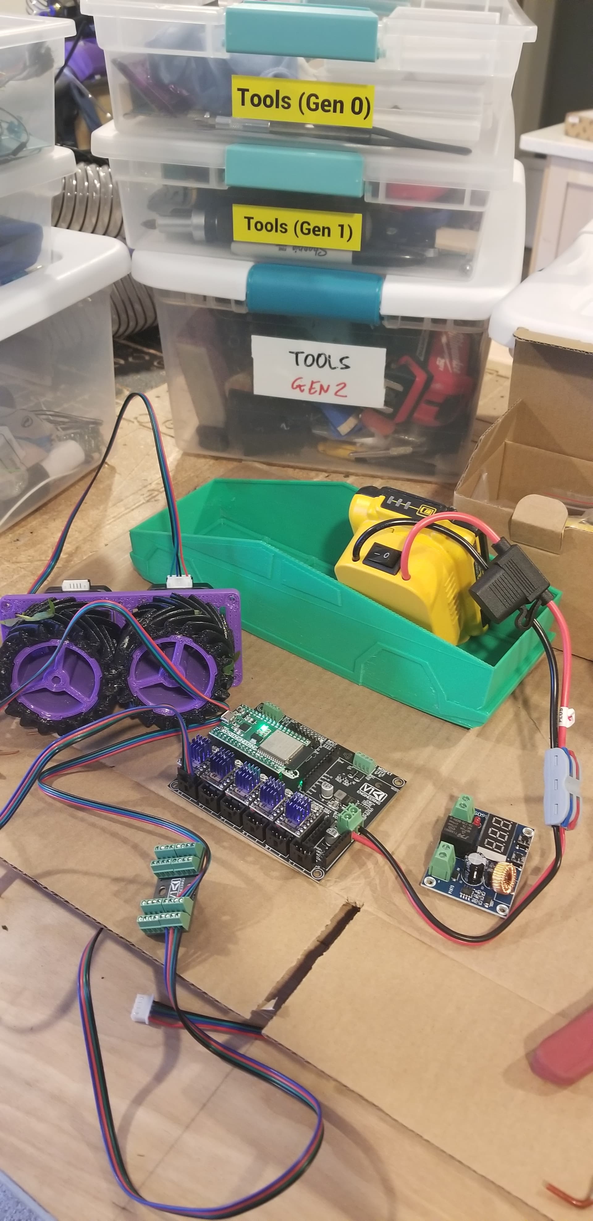

Curious if anyone’s powering portable devices built using JackPot + Steppers (or some electronically similar controller) using Dewalt batteries?
Am trying out this adapter, and a module to help protect battery from over discharging…
Was planning on 18650 batteries, but I may as well use the DeWalt ones on hand and have chargers setup for. Will ensure they’re doing light work within battery’s ampage/power spec.
Advice and suggestions appreciated, as well as seeing portable JackPot projects folks have hacked together?

@azab2c - I looked into this, but the problem was the DeWalt batteries have the BMS in the tool, so you can wreck the battery with over-discharge.
I have a portable adapter that I use with Ryobi batteries and these have the BMS in the batteries themselves. You can diode OR packs together and then swap batteries in a 2+ battery setup as you deplete them.
I haven’t used it to run a Jackpot but I have run a bunch of other stuff this way.
Wouldn’t the voltage protection module he’s suggesting prevent that from happening?
Test, test, test.
I have not tried that specific protection module, but several I did try would ‘shut off’ but still leak current at a few mA of draw. The net result of that is if you leave your no-BMS battery in a device that leaks current when off… you kill your batteries.
I ran my Zen off a battery pack for a while. The table was perfect worked for a long time, but as soon as I added the LED’s I killed a pack by going too low.
So, in addition to the low voltage protection module, it sounds like a mechanical switch or relay is warranted.
DeWalt adapter has a on/off switch. Appreciate the advice to test, test, test. Am checking as I go…
