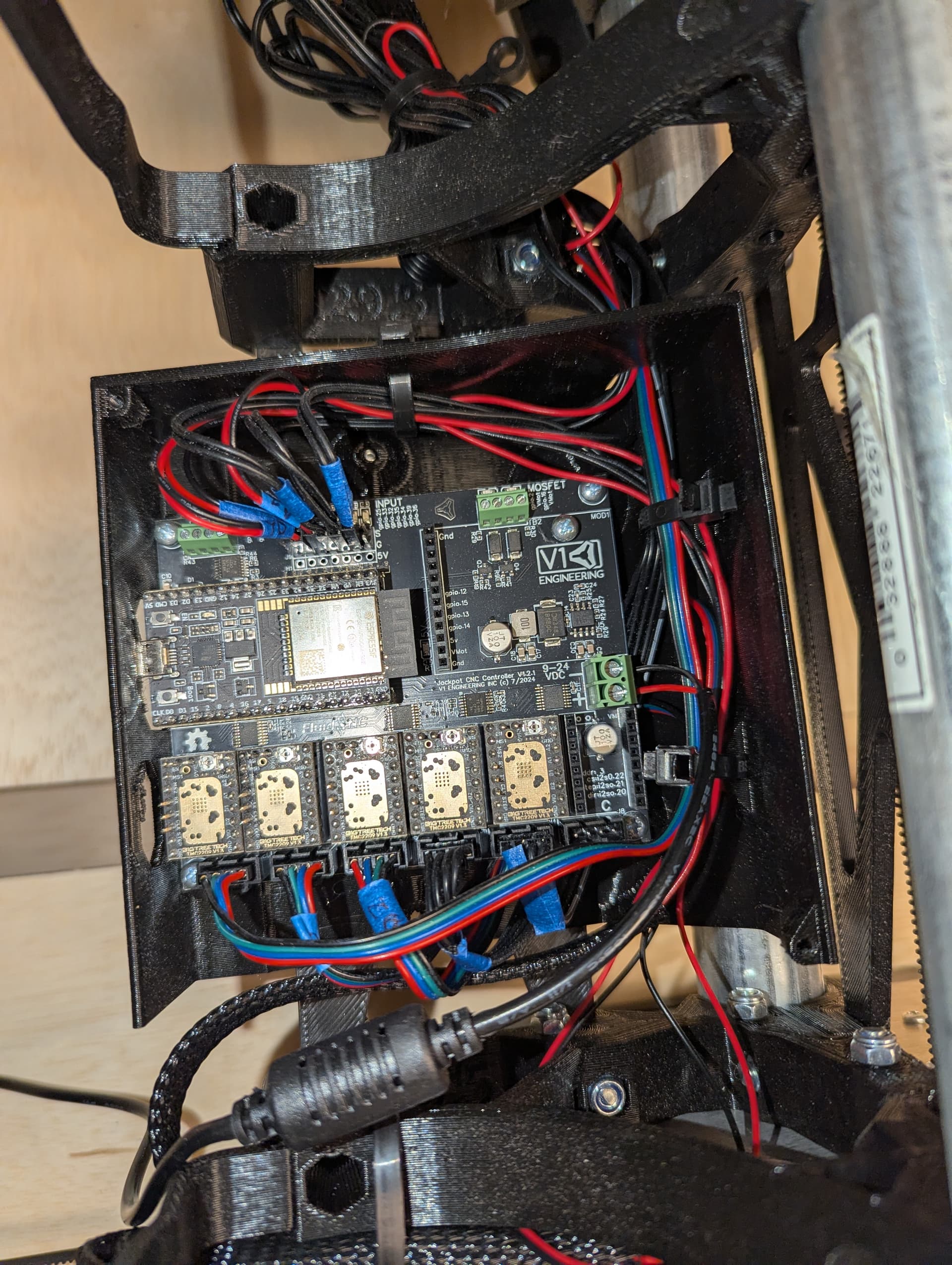

One thing that I note from your picture, this isn’t your problem, but it is something you need to correct: The TMC2209 stepper drivers need to have heat sinks installed on the copper area in the center of the driver.

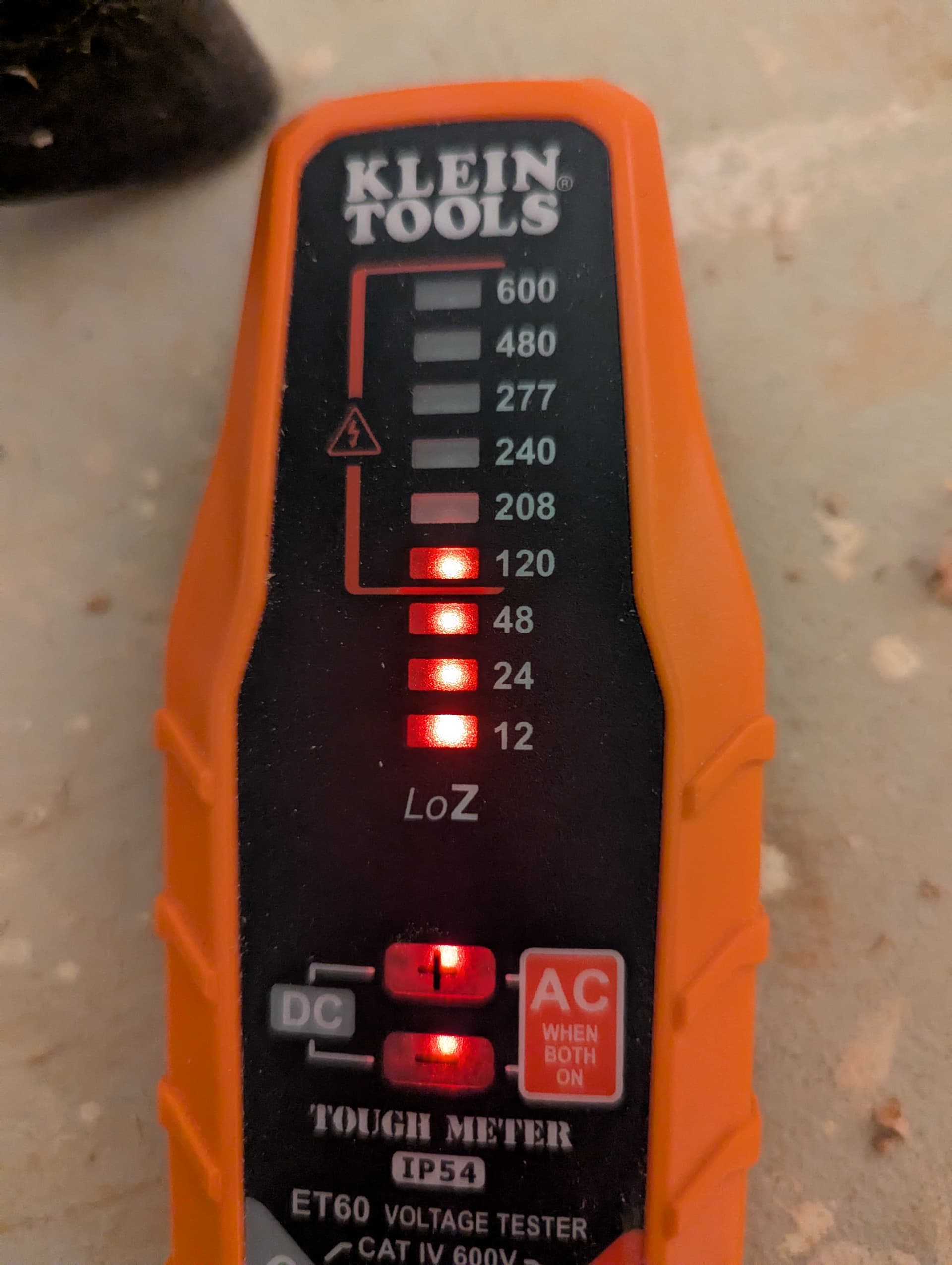

As a sanity check, I’d plug something else into the outlet to make sure you didn’t trip a breaker or something. I’d have at least expected something to light up.
I tried disconnecting the plug from the supply and reconnecting. No luck. Also verified there is power at the outlet. I’m not getting lights, or sounds, or anything.

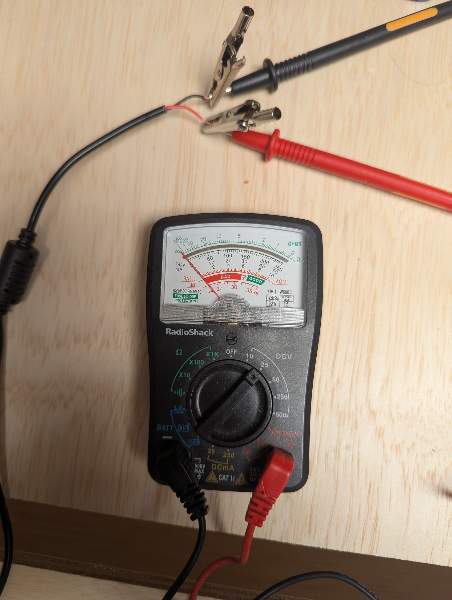

I have a multimeter somewhere if i can find it. Would i test at the + and - terminals? What would i be looking for?
Noah
Put your DMM in DC volts mode, put the + lead on the + terminal of the jackpot, and the - lead on the - terminal of the jackpot. If there’s no voltage present there, then we need to pull the wires out of the jackpot terminals and re-test at the wires.

no voltage on the terminals when i tested (although accidently i had the meter set for 10V instead of 25v at that test), so i pulled out the wires and had 24V. I put the wires back in, and now i have power again. I noticed the green terminal block twisted a bit out of alignment as i torqued the screws. I twisted it back straight. Is that normal?
It’s working again for now. Thanks for your help!
You may have broken the solder joints on that connector. Get a good picture of the bottom of the board. This happens sometimes, particularly if the wires had been torqued super tight.
If the solder joint was cracked, it can be reflowed. Your picture will show us what happened.

Actually i plugged it in this morning, and again no power. This time i pulled out the wires and not getting any voltage on them. I have power at the outlet.
With the clips on the meter probes i noticed the voltage goes to 24 when i plug it in, and drops back to 0 in a few seconds. There is also a blue light on the power supply i never noticed that comes on and then goes back off. I don’t have another 12 or 24v power supply that i can find
