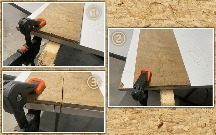

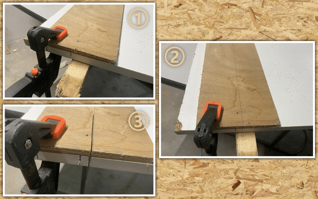

Never tried with the CNC, but when I cut particle boards or plexi with the track saw, I usually put a layer of mdf on top and cut though the whole thing to prevent tearout
This, plus a downcut bit…
The only caveat I see is the lack of pressure between the two
