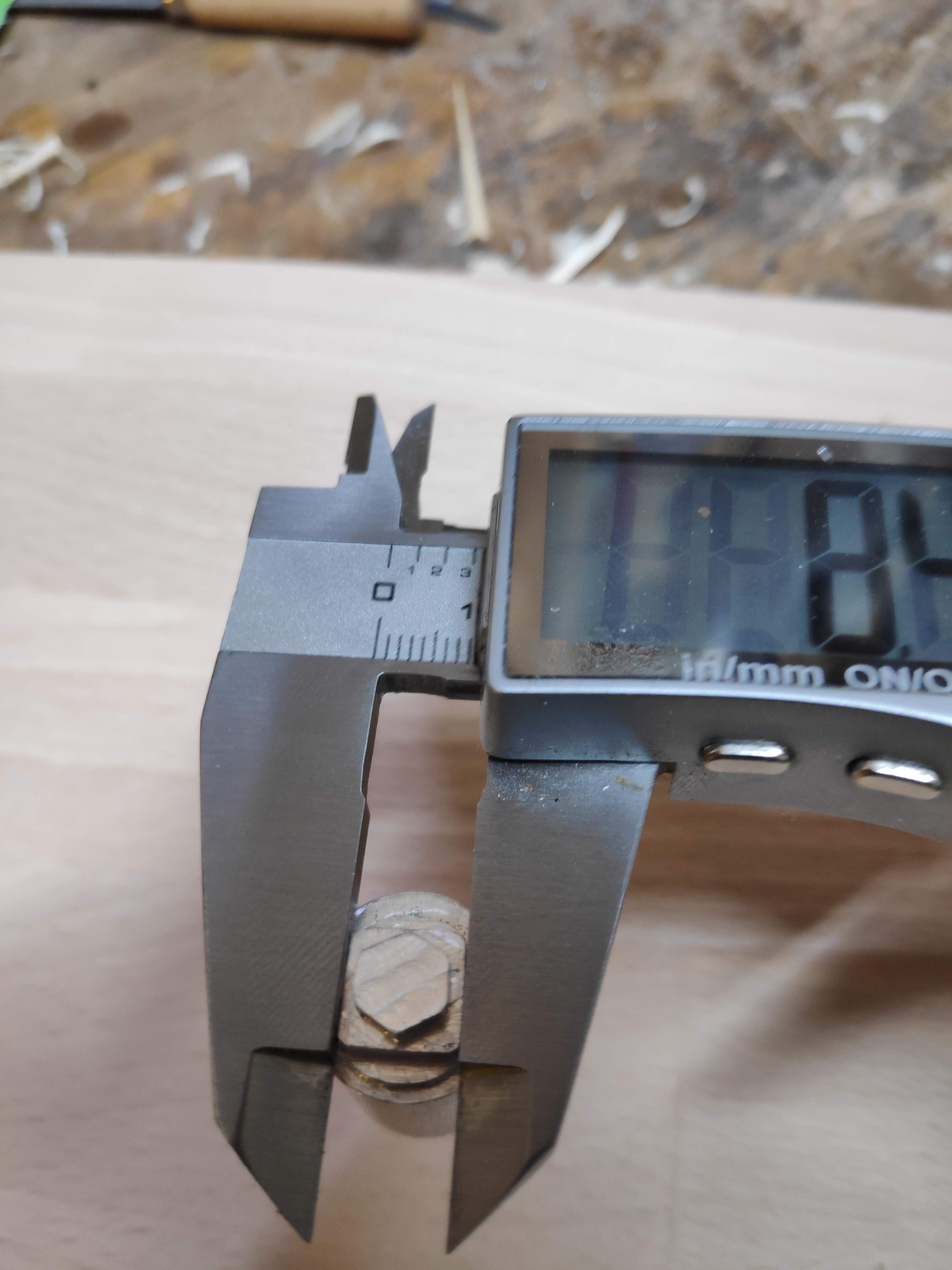

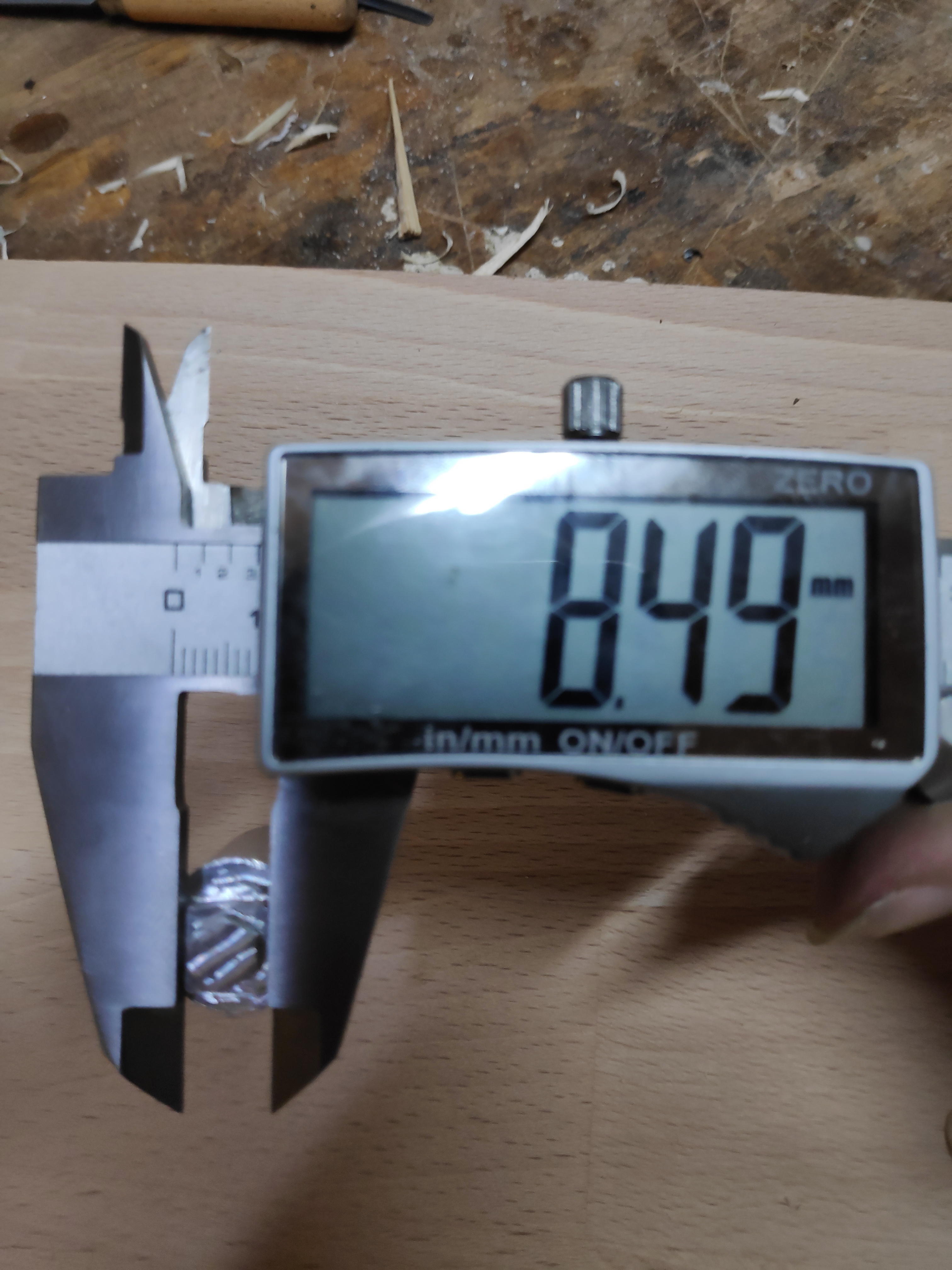

I used your advice to improve my cutting parameters. It just works and it is fast.
For my adaptive roughing cut I use 2,5mm DOC with 0,6mm WOC, 400mm/min feed and 20.000 rpm.
For my adaptive finishing pass I use the entire depth of the endmill and 0,3mm WOC and 350mm/min feed. The finishing pass removes the 0,1 mm axial and radial stock to leave.
For the test piece a 12mm cylinder with a 8,5 mm square on top and a 6mm polygon on top of that inorder to test x movements, y movements, xy movements and x y interpolation.
I achived ± 0.04 mm for the square, +0,06 for the cylinder and + 0,12mm on the angled planes of the polygon and - 0,04 mm for the polygon planes that were an the y-axis.
