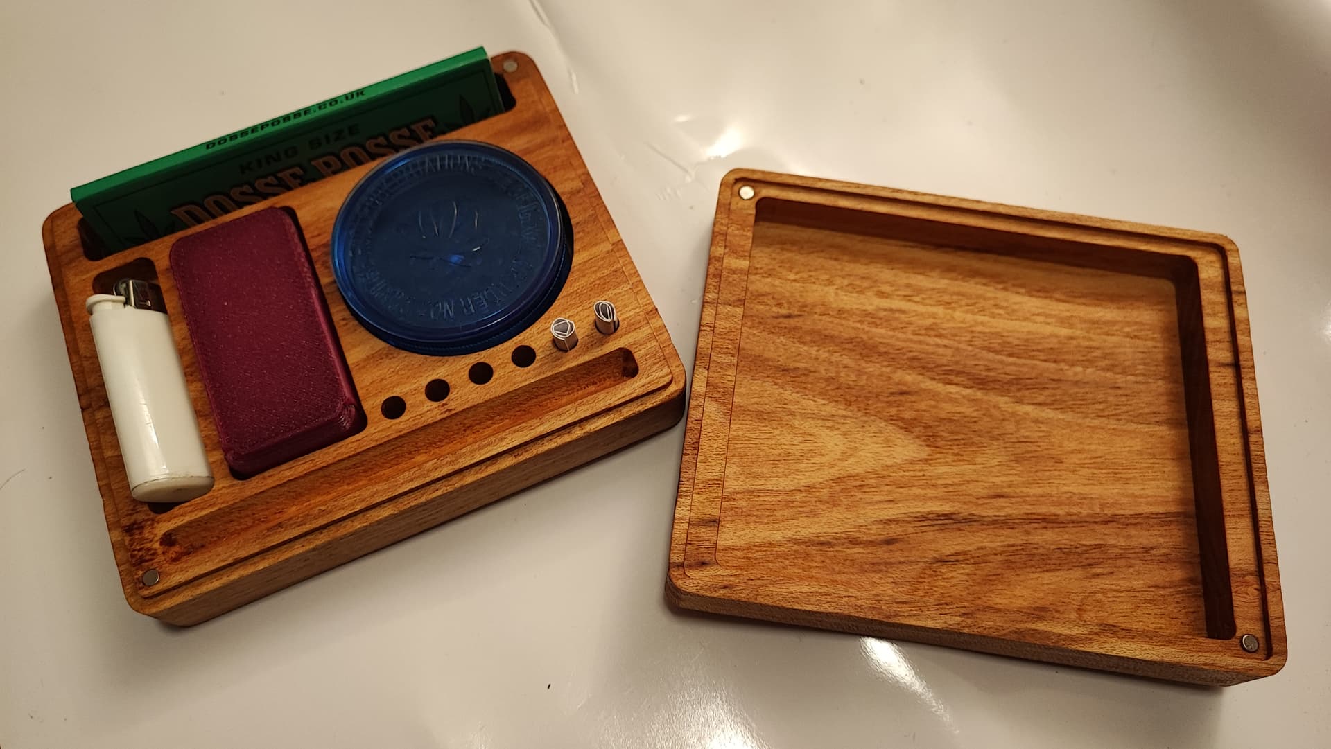

What shall I say, I do love designing new stuff, even though I’m not gonna use it personally.
Also, I love pencil cases. So it’s a case again, but this time for the friendly neighbourhood pothead. Acutally, a guy from the skatepark that always helps my son and me (he is only smoking the THC free weed, so basically beer without alcohol…).
(The camera from my mobile does shitty pictures of oiled stuff… Uff. It looks way better in real life…)

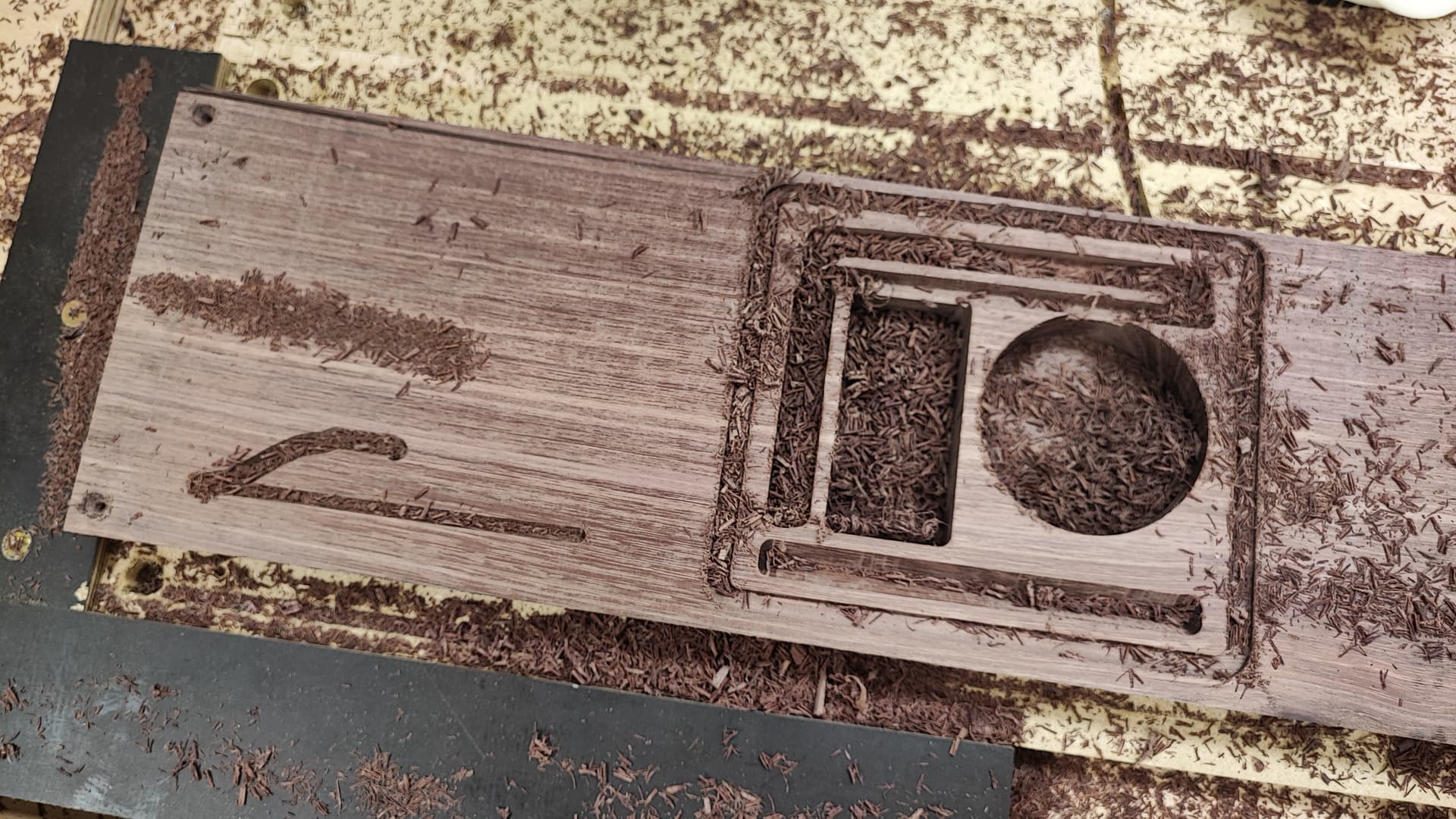

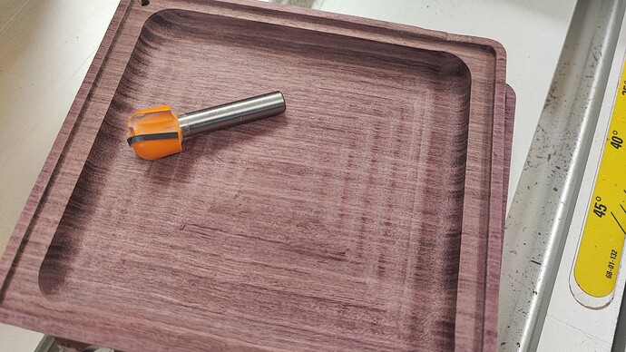

Remember kids: Purple Heart is hard… way harder than Honey Locust. And my endmills aren’t too sharp any more… Managed to destroy one tray after 5 seconds, the other one took a few minutes… The X stepper did not lose its way though, no alarm was triggered, so I can definitely say that the closed loop was worth it.

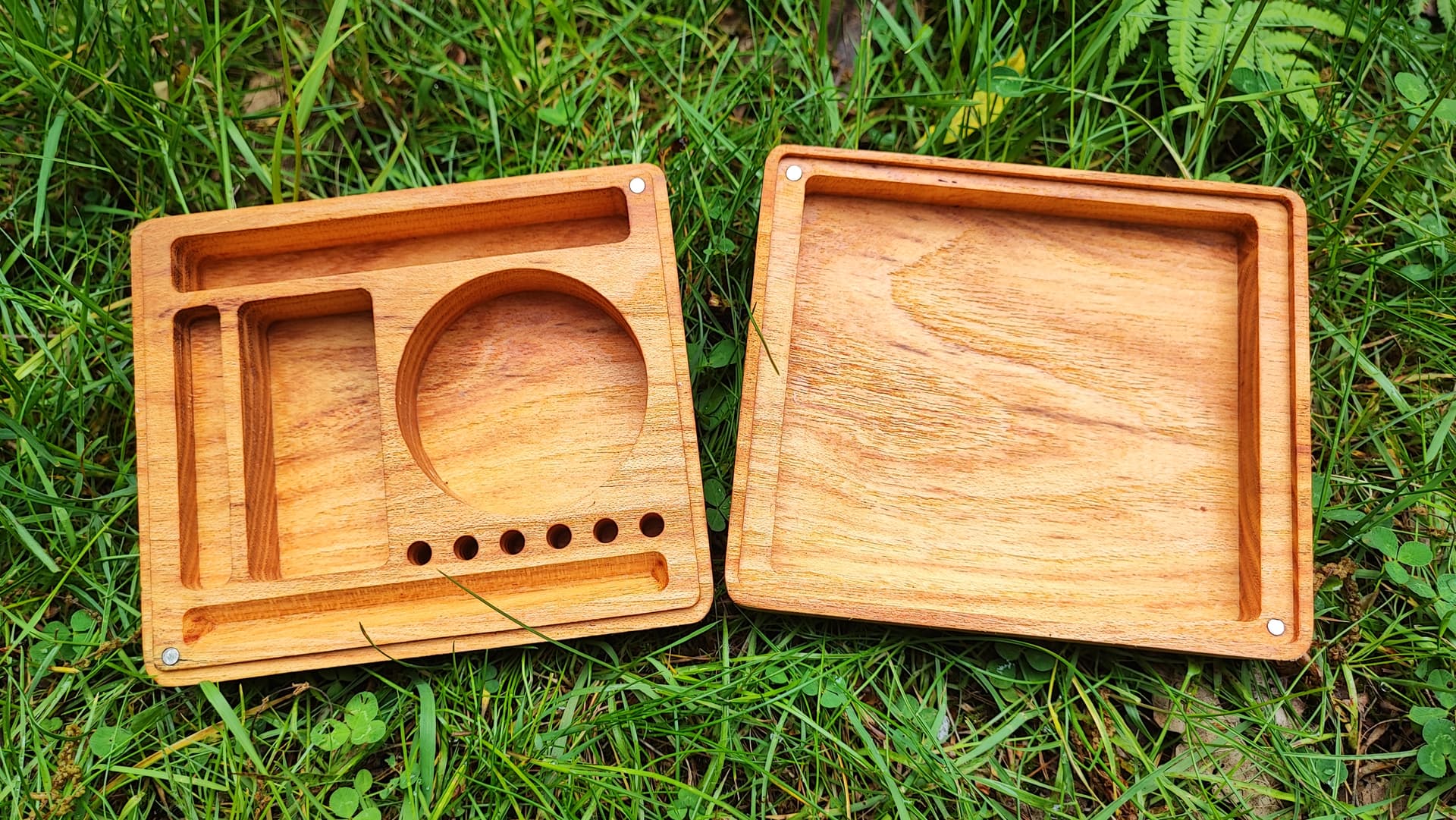

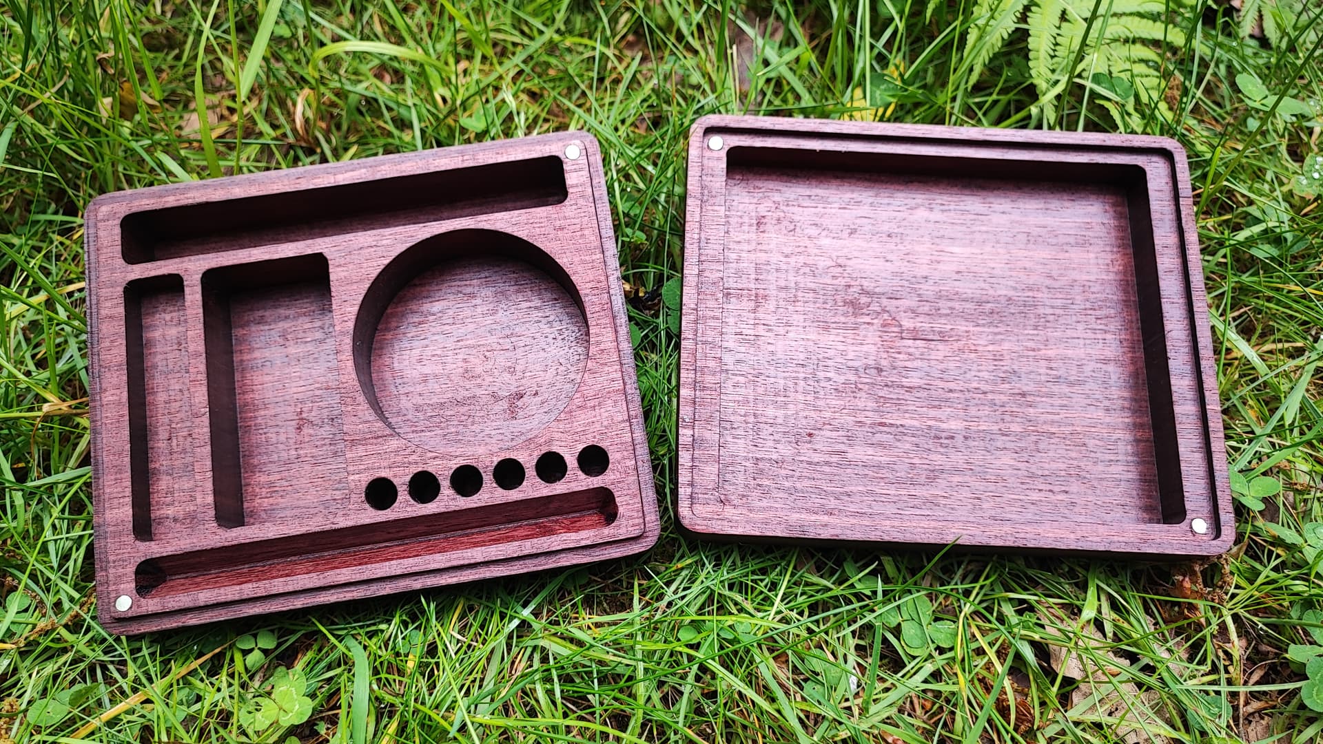

New version with bigger lighter holder amd 8.2mm holes so you can use active filters that are 8mm (Purple Heart):
Old version with too small lighter holder and 6mm holes (Honey Locust):
I really, really like both of them but the Honey Locust really is a very nice wood.

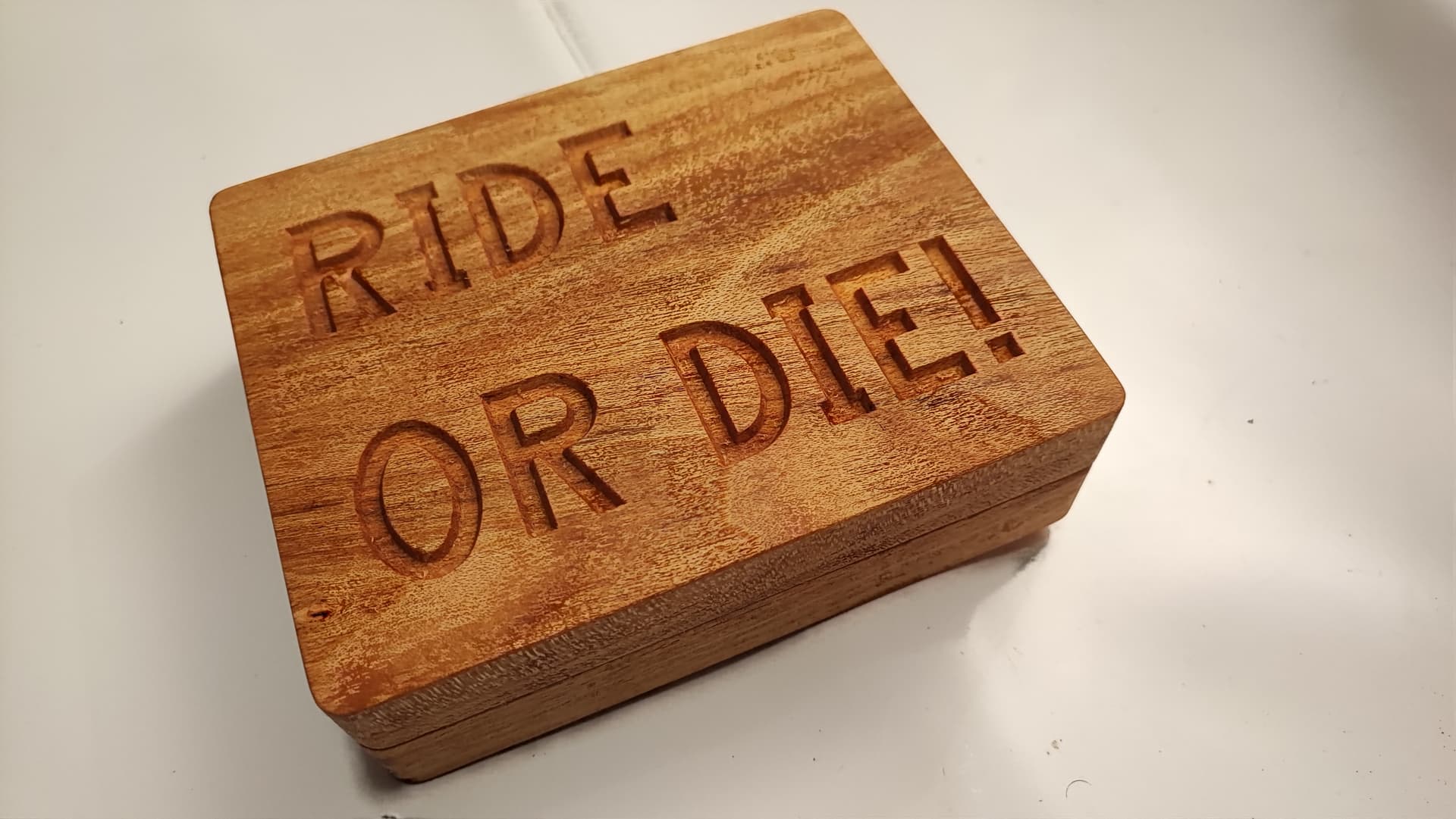

A few more…

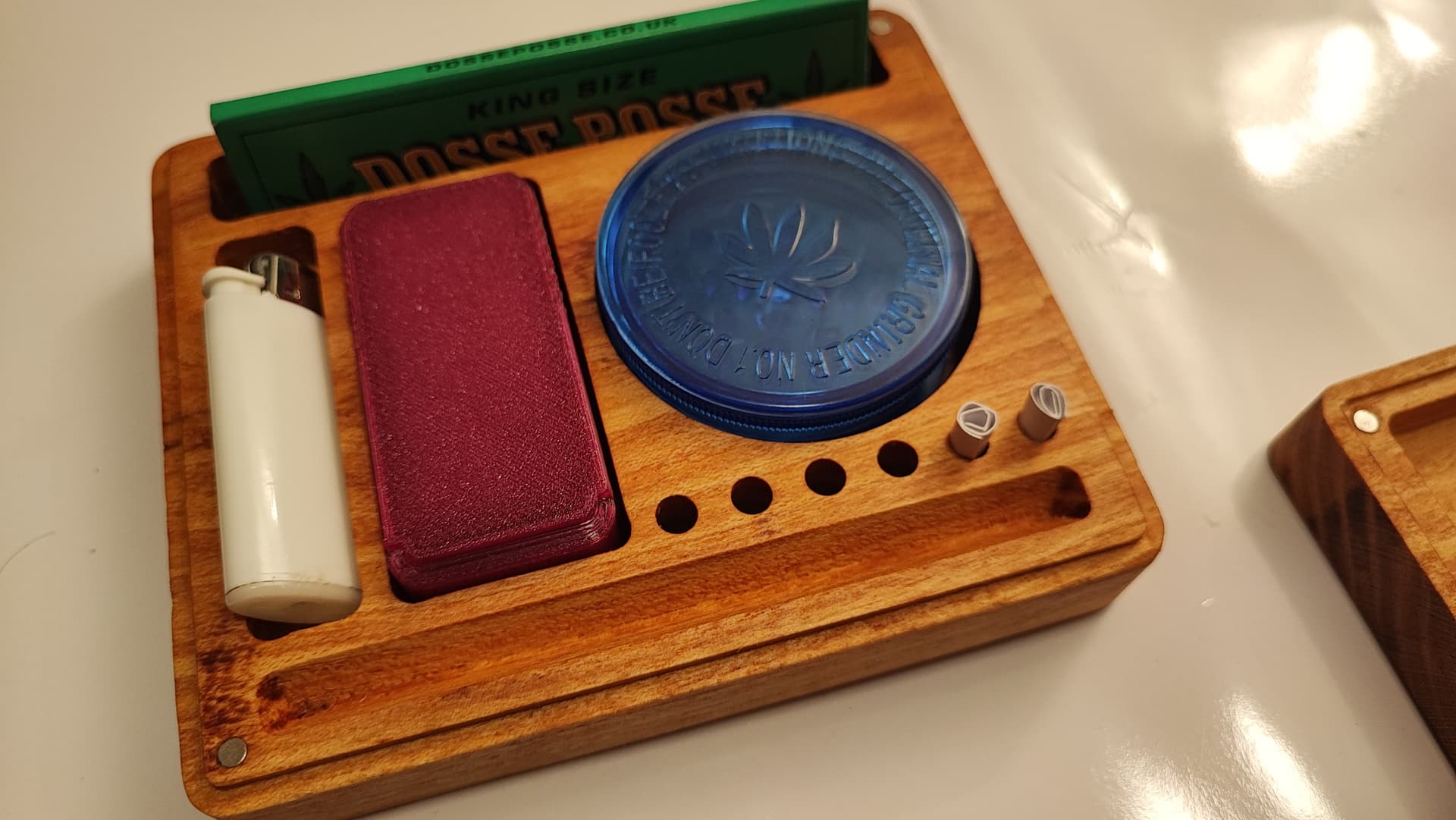

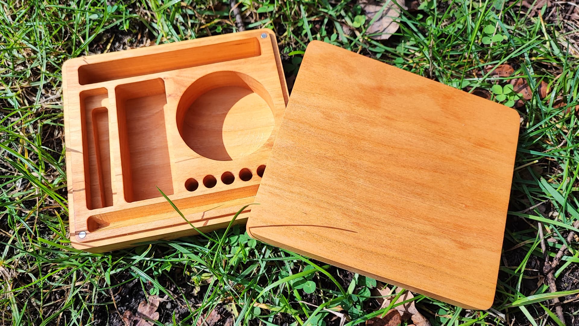

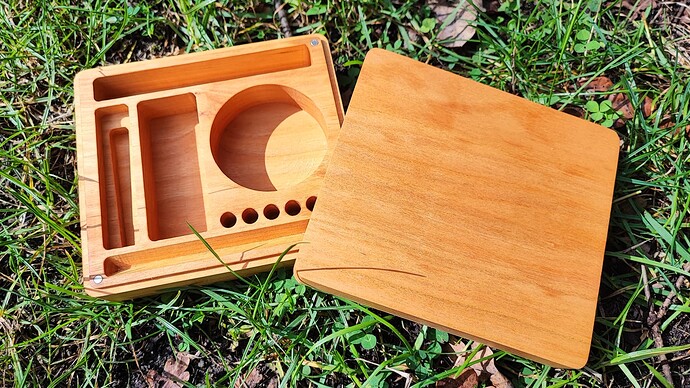

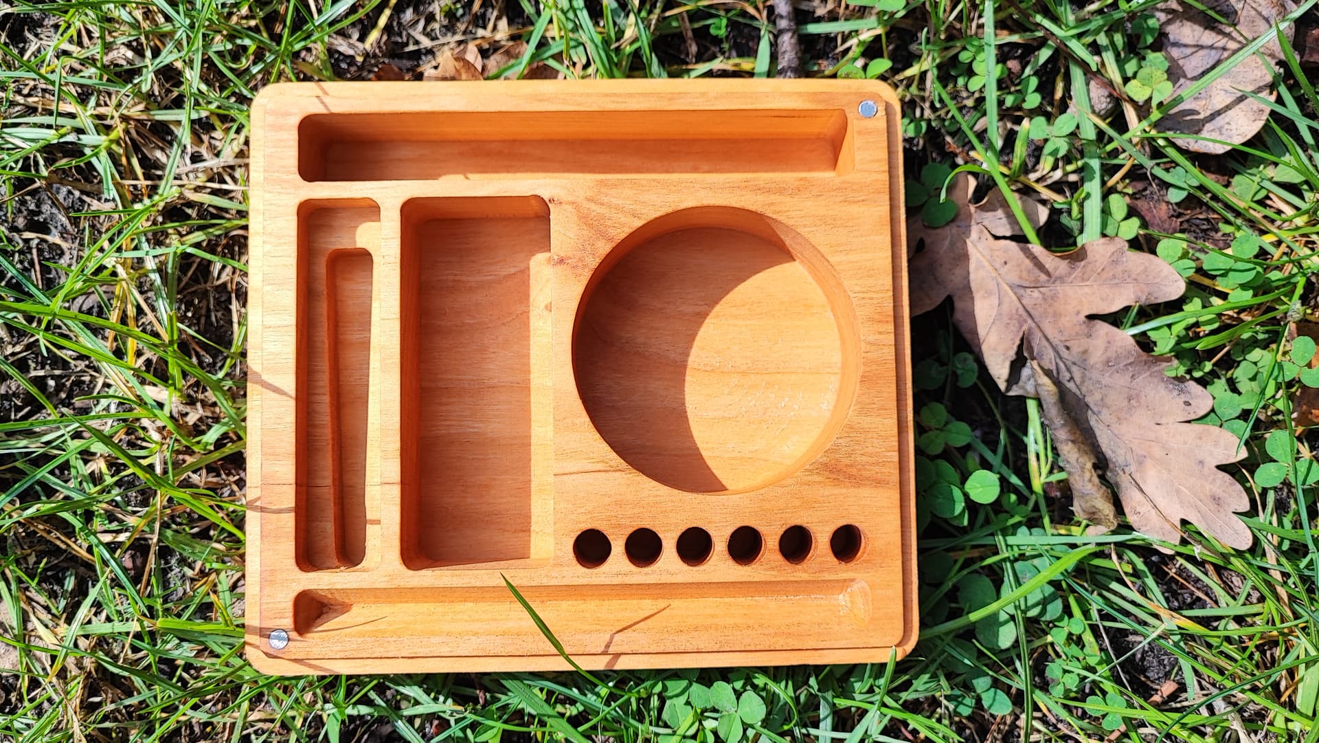

I made a new version out of cherry. Now fits a normal sized Clipper and the way it is now, the picture always faces up. :stuck_out_tongue:
The local headshop has sold 2 as of now and I have sold 3 myself. So not too much, but not too shabby either. :smiley:
Great work!! And kudos for making the Clipper compatible version, that was the first thing I thought of in the first pic :joy:

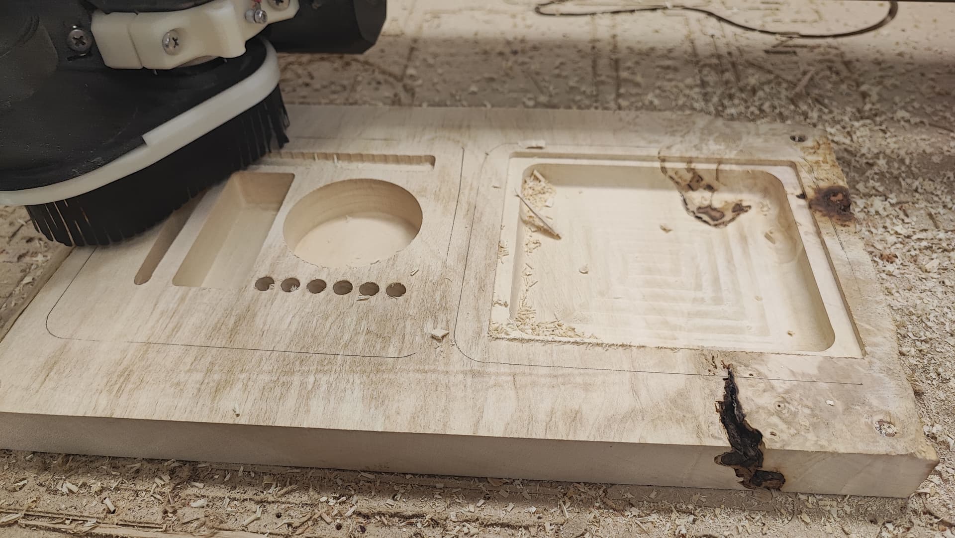

Next upgrade for the tray. The bowl endmill I used for the ashtrays to cut the lid so you can scoop your weed out more easily. :sweat_smile:

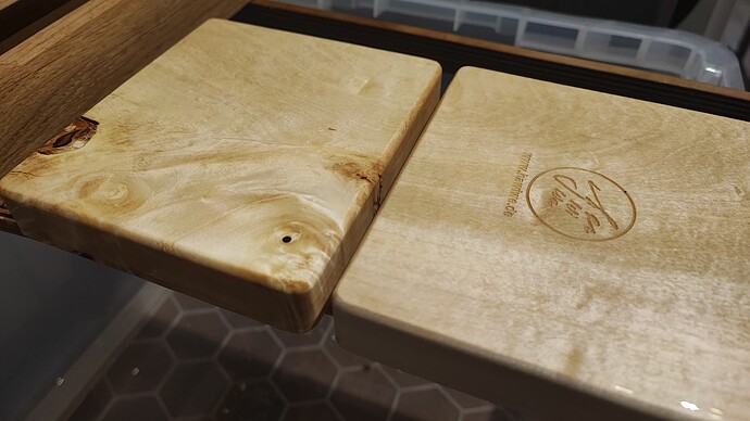

This time in chestnut. Looks great, waaaaaay more easy to machine than purple heart, takes less than 2/3 of the time…
Isn’t that knot gorgeous? The area around is called Wimmerwuchs in German, that’s where the wood really sparkles. :grinning_face_with_smiling_eyes:
If we’re talking the same thing, we call that “burl”.
The actual branch wood is so small and offsets the color. The disruption in the grain is so wonderful and spreading throughout the piece. It is amazing what you find as you work through nature. It
