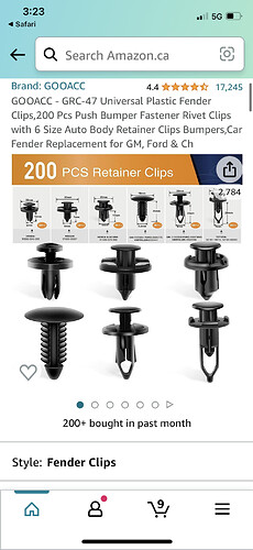

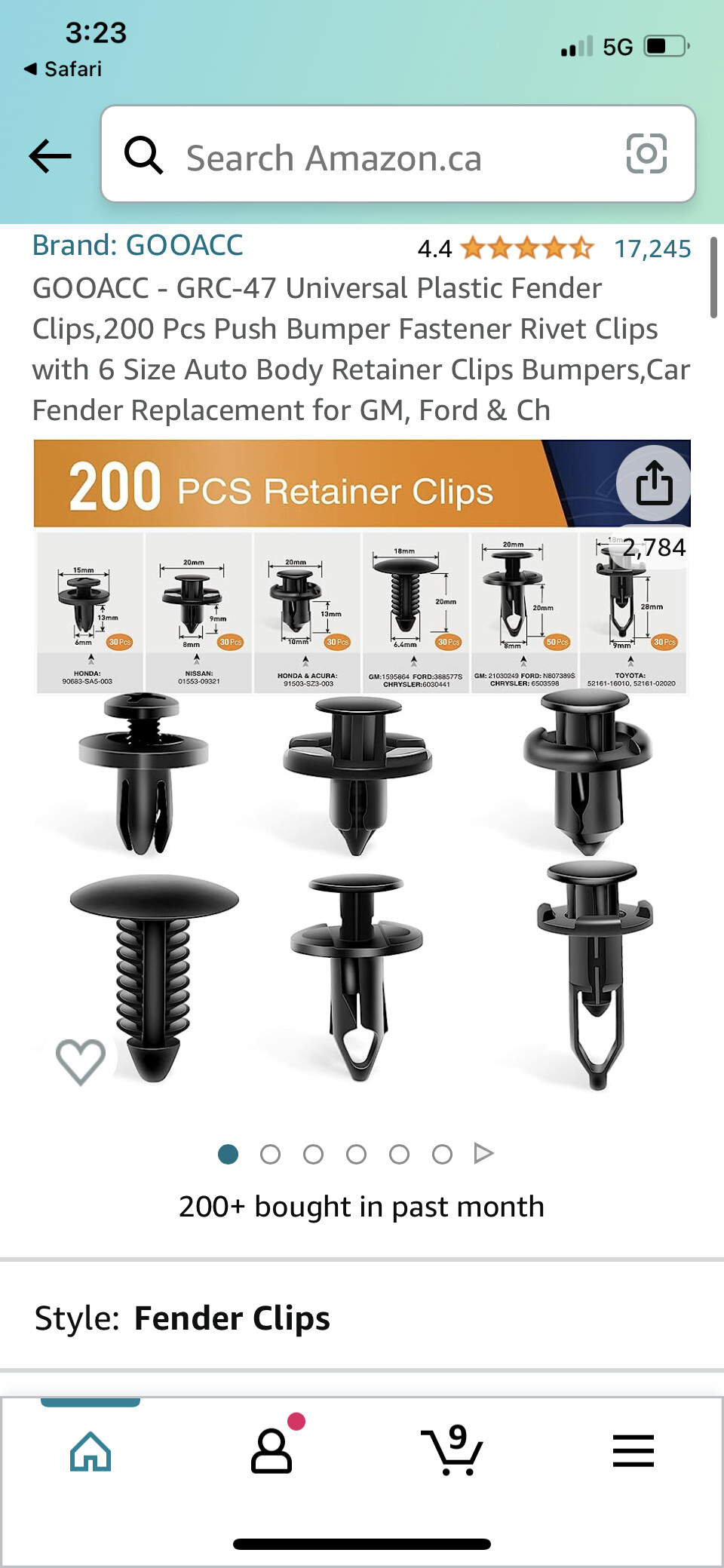

I wonder about using larger plastic printed screws or the auto snaps like the ones with the middle insert.
Or plastic prrnted ones that have the threads in the supports.
