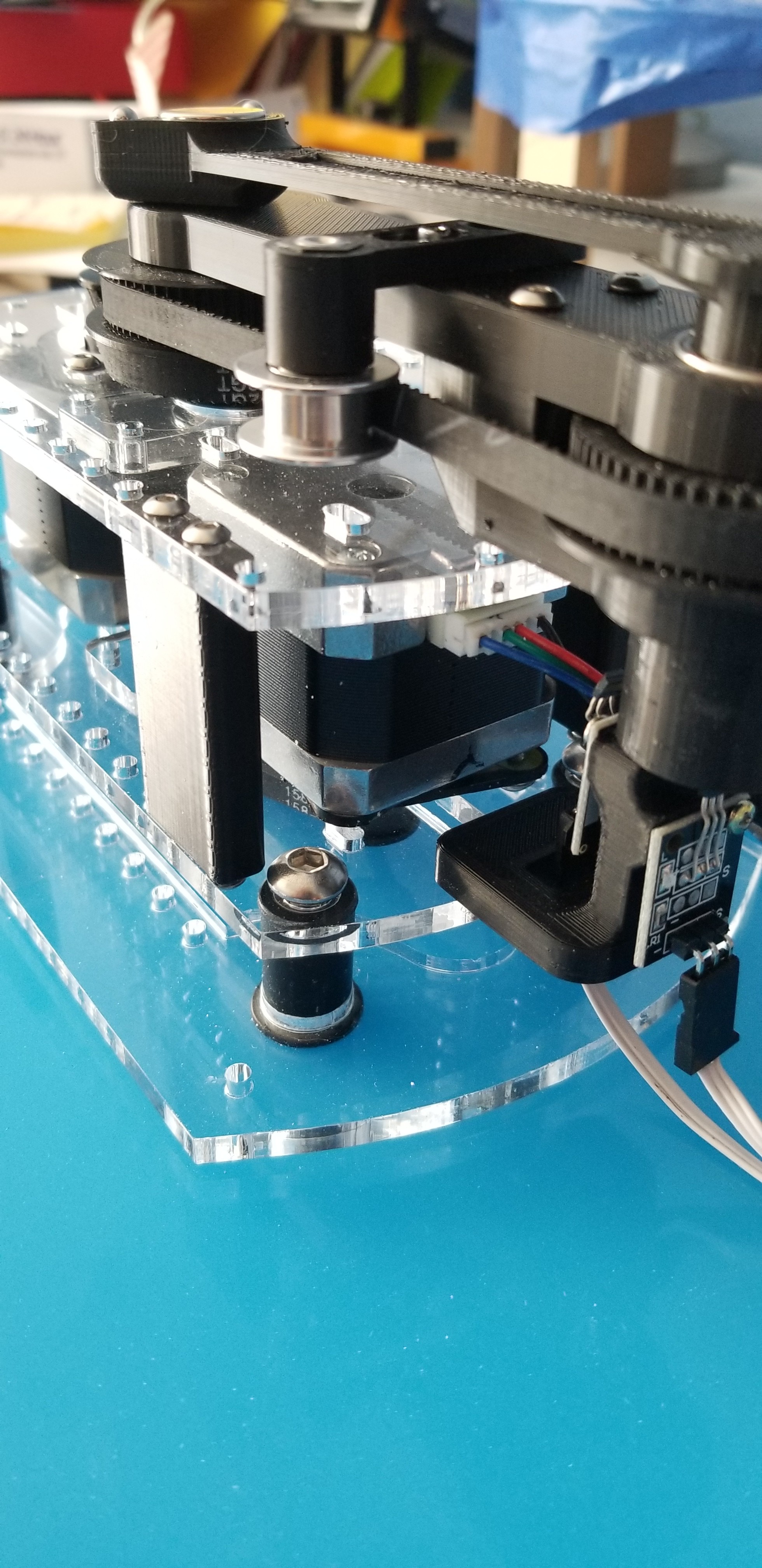

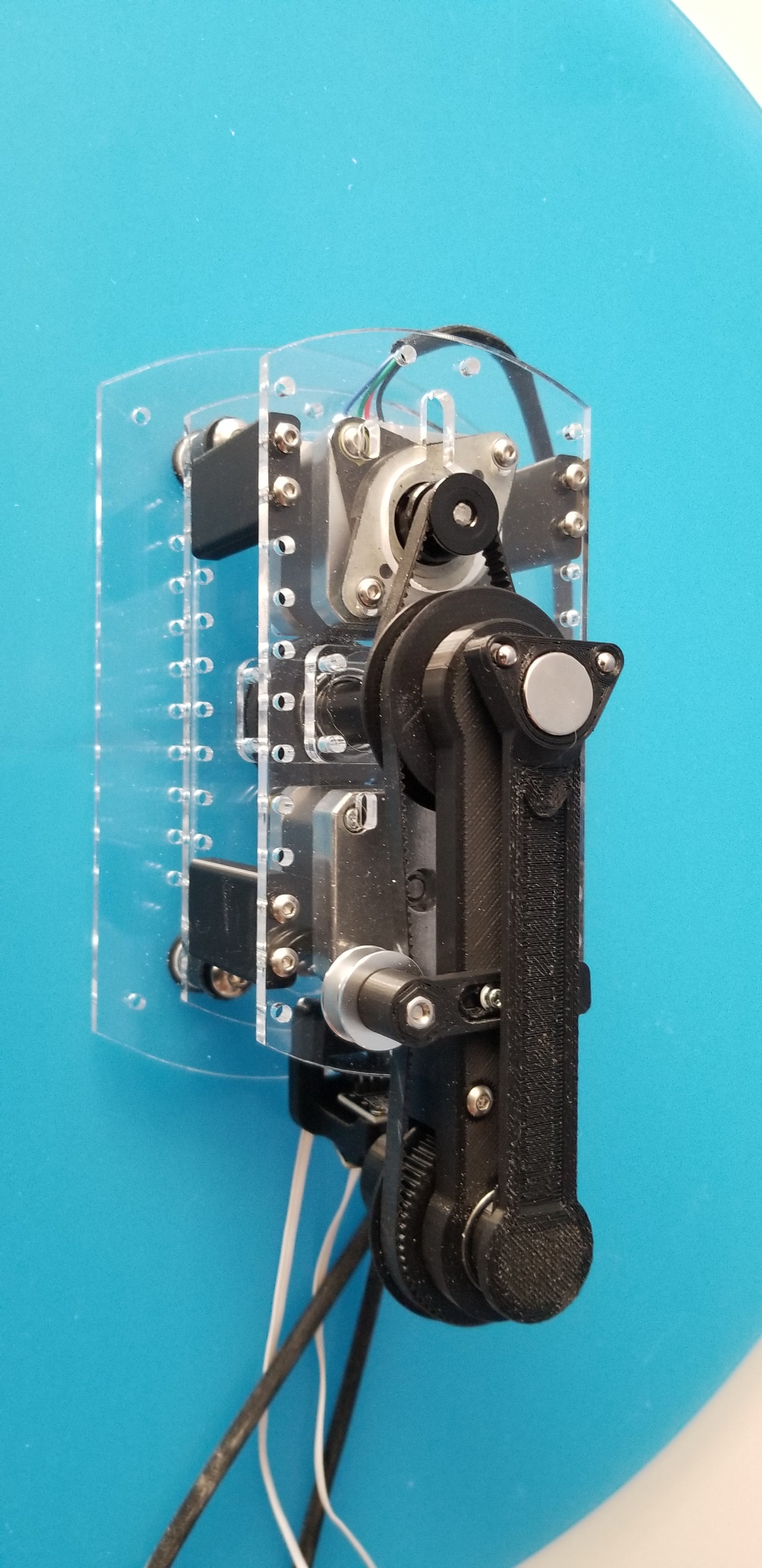

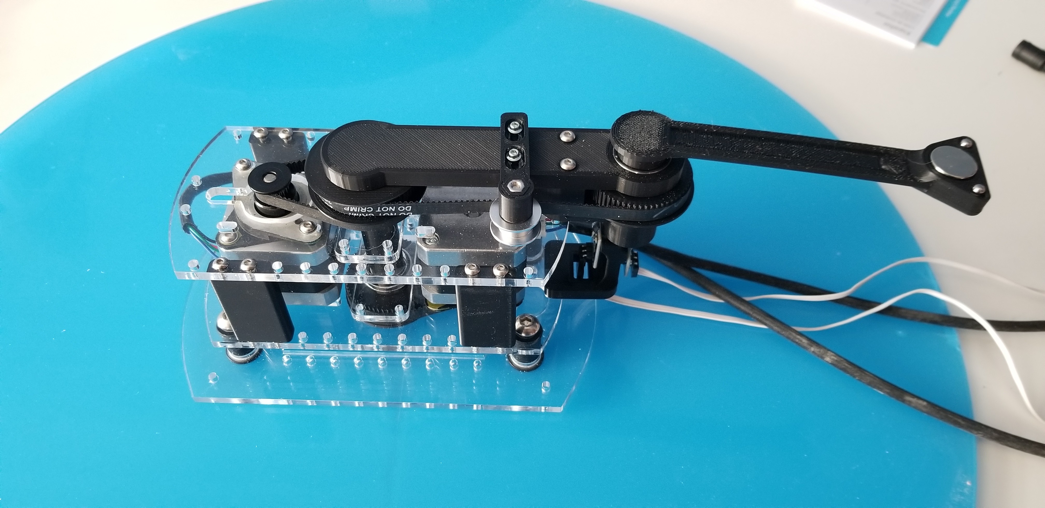

I made a few adjustments before I make the table.
I’m going to try and document and put this in it own thread with parts…
Hi. Very nice project. Good to know if you can document it👍
Just one question about you homing. Is it true the homing of the upper arm (y) is done only when the homing of the lower arm (x) is done?
Yes. The X has to be home before it seaches for the Y.
I moved end stops off gears and put them at elbow.

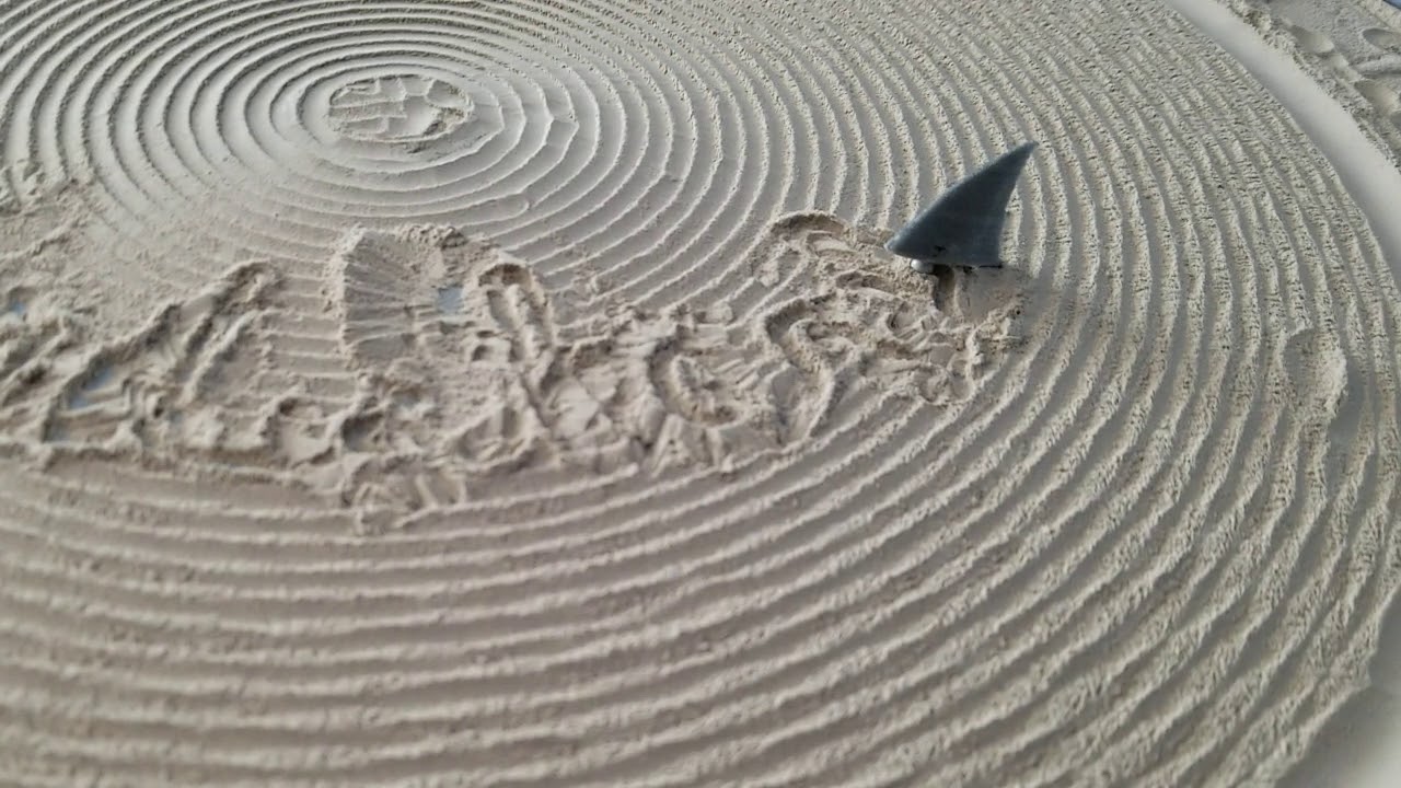

HaHa… it Kinda works!?
They sell it in their shop. Underneath the sand is fabric on a stiff board (maybe ACM?). The sand is fine sand, but not as fine as baking soda. It is a little tan, not perfectly white.
I definitely need to try that. Did you print the fin?
Yes. Printed with a pocket to recess a 5x3mm magnet and it was riding on a 4mm bearing.
I am going to test a few shapes that plow through the sand…

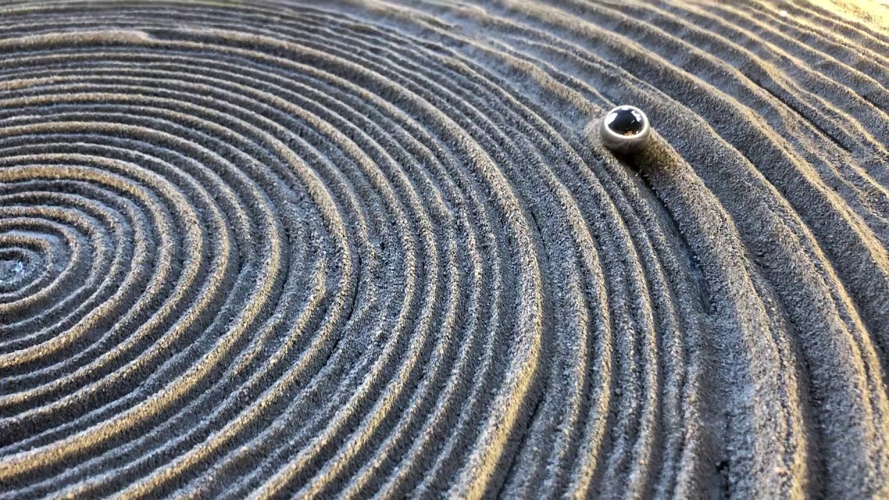

My Sandbot is now functioning very well. After redesigning the arms of the robot it works great.
I’m still trying different types of sand like the one you can see in the video.
The ball is sometimes slipping over the surface instead of rolling.
I’m planning to cover up the mirror with some kind of fabric for example velvet.

Hi. Very nice. Congratulations! What is under the sand. Glass or wood?
What sand do you use currently ? And what de particule size?
I have see that your ball is going right and left. I have use under tablecloth to put under the sand and it fix that!
IMHO, the biggest reason the ball slides instead of rolls is because of the depth of sand. If it is over 1/4-1/3 height of the ball, it would rather push than roll.
There is a big mirror under the sand.
In the video, I used a special kind of chinchilla bathing sand which is a bit rougher than the normal one.
I also tested with normal chinchilla sand and it works even better.
I don’t really know what grain size it is but really small :slight_smile:
I’m going to try to put the tablecloth under the sand and look how it turns out.
I agree with you that there was too much sand on the table in the video.
It was the first test and I need to find the right amount of sand. :sweat_smile:
I’m going to try to get that 1/3 to 1/4 in height.
Do you think putting some kind of fabric on the table is an idea to try?

I tried to spell out “Land Shark”…
means something if you watched old Saturday Night Live!
