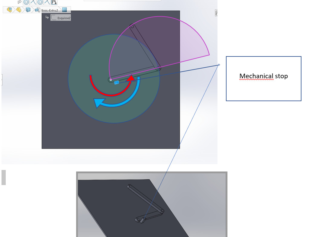

What do you thing about my option 5:?
The 2 arms run always in the same direction (counter clockwise) right? so if I first home the shoulder clockwise and I add a mechanical stop on the shoulder so the elbow will hit the mechanical stop when it is in the same axis of shoulder. Then the shoulder will take with the elbow with him until the endstop. and thats all!
In case of the should hit the endstop before the elbow hit the mechanical stop, I can make a homing counter clockwise of the elbow!
I thing this can work well but I have a small issue. when the X (shoulder) is homing, the y motor (elbow) is in feed hold status and the elbow stop the moving of the shoulder.

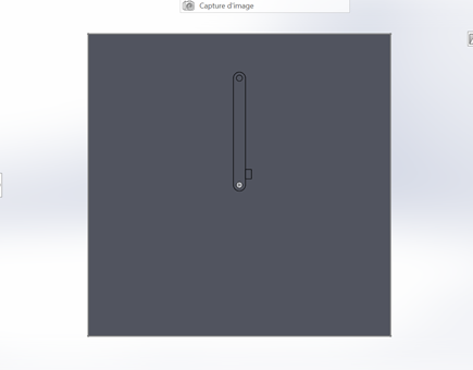

So I have made some picture and a video for better understanding
Let start with a square table. It’s same issue that rectangulare but easier to test!
We assume the following position to be the homing position:
And with assume this is the position of both arms before doing the homing. Let see the 3 surface where both arm can move. Cercle for the lower arm and 0 to Pi for the upper arm. Red arrow is the running direction. Blue arrow is the homing direction:
And now we do the homing in video:
This must work in all case but my problem now is I don’t know how to disable motor hold of the upper arm during homing of the moteur of the lower arm any help
