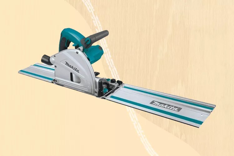

Looking at getting a plunge saw with a guide rail. To cut mdf that eventually will be made into garage cabinets.
So should I get a plunge saw, if yes, with or without battery?. If no, circular saw or table saw?

Yes, I am looking at a Makita Track (plunge?) saw. The model I am leaning towards is the SP6000J.
I have the WEN track saw. Cheap and works awesome. I did get the little more expensive powertech track for it though. Mine is older with a cord but a friend has the one with the batteries. Honestly if I had to do it again, I would get the battery one. The cord is just a pain

I have 2 that hook together. It works really well. Have never had a hang up or even notice when I am passing the joint
It’s the easiest to do if you don’t have the space for a big table saw.
For cutting large sheet goods, a table saw requires good out-feed support, especially if you’re working solo. I’ve had table saw for 40+ years and have gotten pretty good at using it but, I think most people would find a track saw more convenient and easier to use.

I bought it to replace a tablesaw. There are a couple of people in our group that I don’t trust with a tablesaw. I’m pretty handy and quick at stitching wounds, but reattaching fingers is a step too far for me. It would be quite a challenge to saw your fingers with a track saw.
So I vote for the tracksaw!
I have a table saw but don’t use it often. I’ve considered replacing it with a track saw. A table saw takes up a lot of space and requires more respect to use safely.

What about number of teeth on the blade? There are 48 teeth, 56 teeth and 60 teeth? I want to cut 19mm plywood.
EDIT: Blade dimensions is 165mm x 20.
48 teeth will be fine , just take it slowly, i generally use a diablo 40 tooth on ply
60 is your finishing blade , i dont like using them on ply they heat up to much
do you already have a skill saw take a look at the Kreg rip cut , since i brought mine only use my table saw for ripping small pieces
60 teeth on a 165mm sawblade is waaaay too many.

I have both a track saw and a table saw. They’re different tools. Both have advantages and disadvantages. With an MFT table a track saw can do many of the same things a miter saw can do as well. And it does many things a crosscut sled does.
I primarily use my track saw to break down sheet goods, or for some awkward cuts that would take a lot of setup on the table saw.
If you are going to use the track saw instead of a table saw, I’d strongly recommend parallel guides, if you’re going to use it for crosscuts, an MFT table with a fence would be a great addition.
