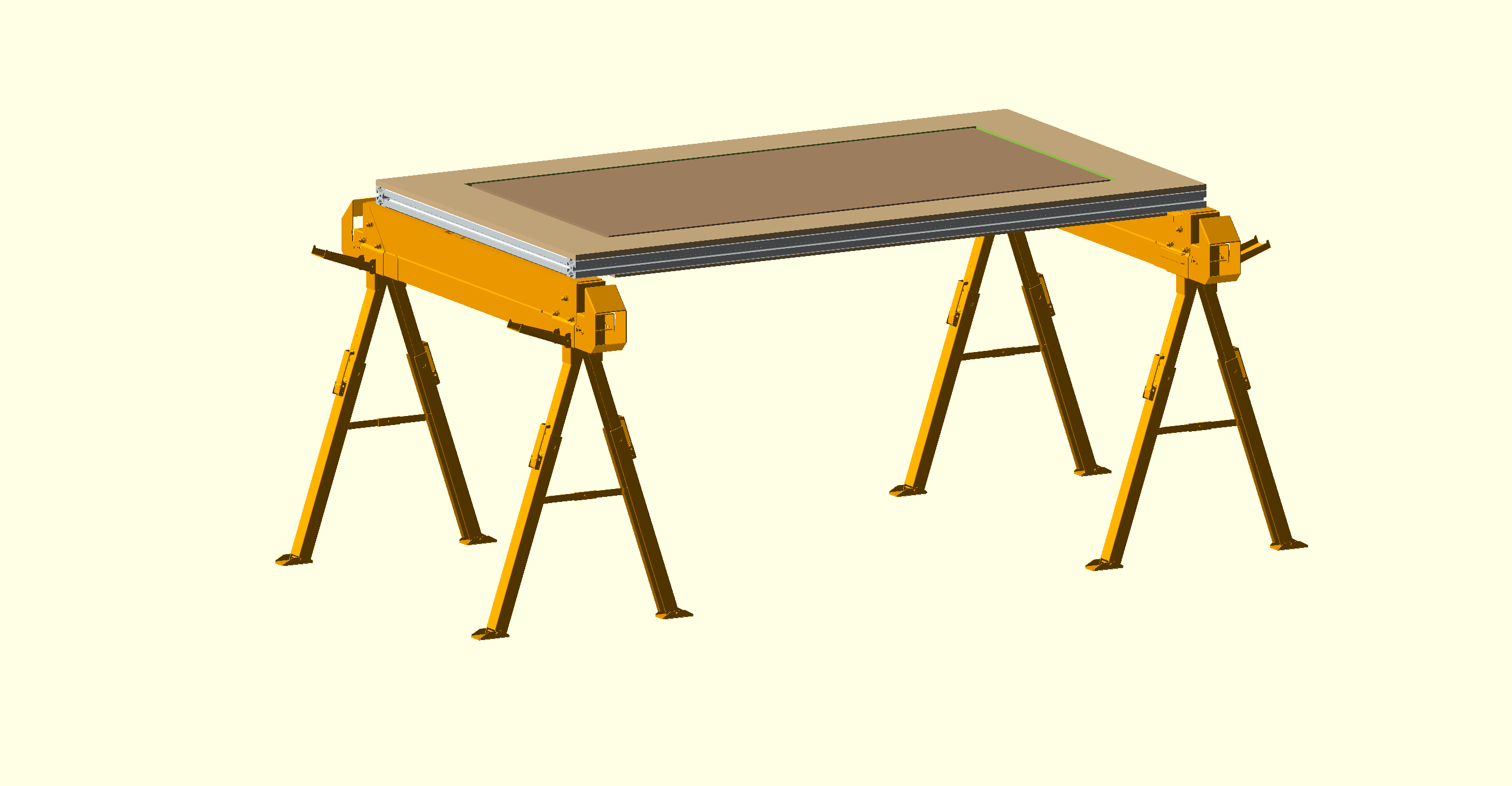

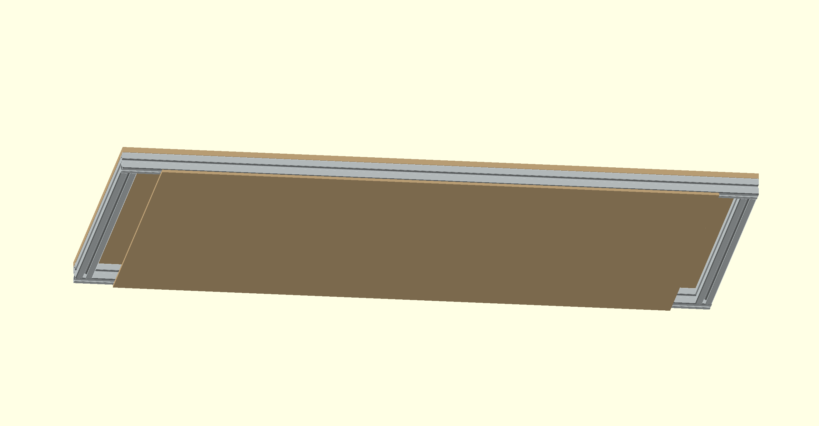

Please critique my table design
I’m champing at the bit to build a LowRider and to begin the obsession!

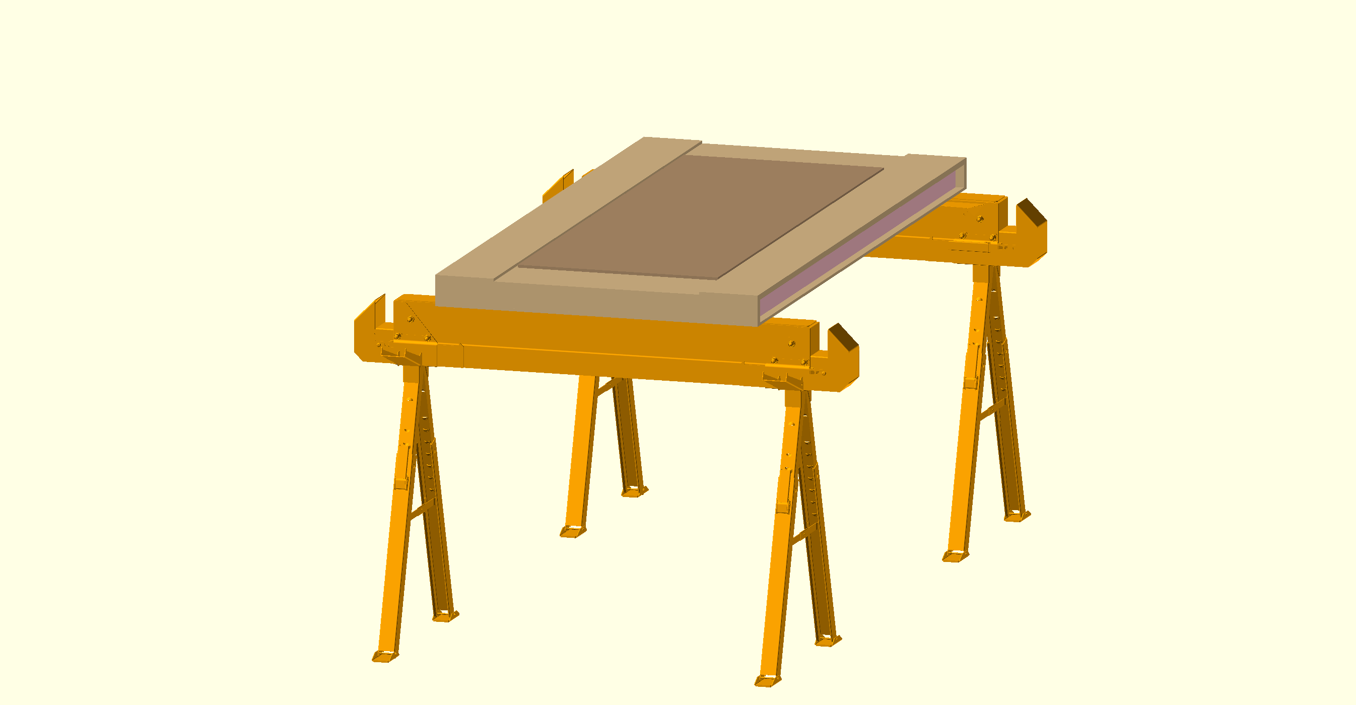

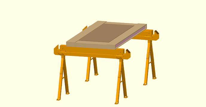

I have unique requirements and so had to come up with my own table design. Since I’ve never done anything like this before I’d like you please to give me feedback and criticism.
I live in a dense apartment building and running a CNC machine at home is a no-go. I’ve decided to build a 2’ x 4’ LowRider and keep it disassembled in two parts in my car: the table with the rail will go in the roof cargo box and the gantry will live in the trunk.
When I want to use it I’ll drive to a vacant lot in my town that’s under a loud freeway overpass, assemble the LowRider, and keep an eye on it while sitting in my car’s passenger seat doing other work on my laptop.
The table has to be lightweight because I’ll be lifting it overhead into my car’s roof cargo box. To achive this I intend to build the frame out of 4040 extruded aluminum. I’ll attach 1/4” plywood for the bottom skin and 1/2” plywood for the top surface with a hole in the middle for a 1/2” MDF spoilboard.
The table will be supported by two sawhorses which I will bolt to the frame every time I assemble it.
As a new user the forum will let me attach only one image per post so I’ll put the first one here and then add two more in follow-up posts.
Without Spoilboard
With Spoilboard
Bottom View without Sawhorses
What do you think?

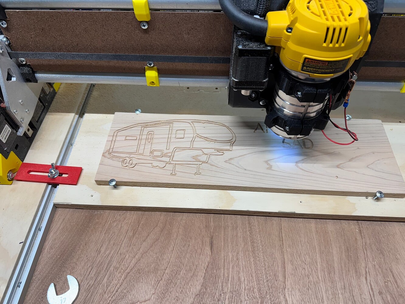

Earlier this year, I helped a friend build a very similar surface for LR4 sized to cut 2’ x 4’ materials. We used 5/8" plywood, 2020 extrusion, and 1/4" plywood underneath. The panel fits in his truck bed, but… it’s heavy and bulky, time consuming to haul and setup. One strong person can move it, but 2 people’s ideal (to avoid accidentally knocking belt holders off). Finding ways to minimize setup/teardown time and friction will help increase probability of getting use and joy out of your CNC.
Do you have enough space in your apartment building to create a significantly noise dampening enclosure? This forum has projects and people here that could share ideas/experience if you want to try that. Maybe store stuff above and below the enclosure to maximize space.
Alternatively, got family/friend that would be interested in learning CNC too, and could help make space for your setup?
Depending on projects you’re doing, one “no table” CNC option is Maslow 4.1, there’s pros, cons and different capabilities. Am mentioning incase it’s a good fit for your projects and situation. Cheers!

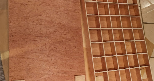

My first instinct is that you could easily build a light, rigid torsion box for the table by cutting down a cheap hollow core door and gluing a length of packing in the open end.
That would save the cost and mucking around with the aluminium.
My second question though, is “how do you intend to power it”?
I’ve spent rather a lot of time working on picnic tables beside rivers while living on our boat, and we only have a 700W inverter, so all of my power tools for that purpose are chosen based on their max wattage! These days I guess portable power packs are readily available.

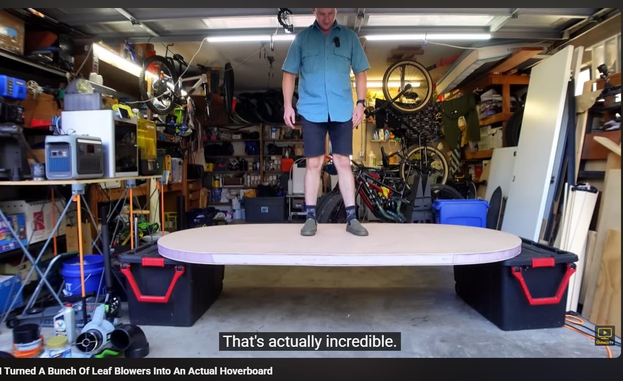

Another option… I have no idea about deflection, hopefully someone that knows Mech stuff will chime in. But, this guy seemed to get unexpectedly great rigidity with sandwich made of 1/4" plywood, 2" XPS foam, and lots of Polyurethane Construction Adhesive (solvent-free)…
Roof rack rails as Y axis rail would be spectacular.
Your table looks like a table… perhaps if you gave us an idea of what you intend to create with your portable Lowrider, people could provide you with the more detailed feedback you seek.
This is my question as well. The trim router is ballpark of .7 kilowatt, the machine otherwise another 40-60 watts.
A battery powered trim router gets you about 15 minutes of assured runtime.
How big of what kind of jobs?
The variables with foam are the adhesive and the foam. Sounds logical I know, but it’s just another version of a torsion box at the end of the day, if foam and glue are cheaper than air where you live go for it! :grin:
Seriously - I have built super lightweight cupboards on boat with normal benchtop laminate as the outer skin, but the foam was proper core foam and the glue in those cases was epoxy.
Coolroom bonded panels are another example.
Actually your big box hardware stores probably have a kitchen bench panel or table top (Ikea certainly does) which would do the job without any mucking around.

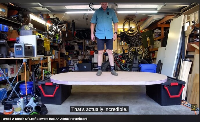

This is one of the options that I have thought about doing for my table when I get to it. I was thinking about 4 inch foam with 1/2 inch ply, which would be significantly stronger than what this guy built. However, his results look like 2 inch and 1/4 inch are strong enough.
The other option I have been mulling is using a steel or fiberglass exterior door as the table. I plan on starting with a 4x2 ish build.
I’m keeping an eye on craigslist hoping a nice 36 inch exterior door shows up.
It really doesn’t need to be heavy - as long as it’s flat (ish) it will be fine.

I dug into this idea a bit and learned that hollow-core doors are designed for economy and lightness but not rigidity.

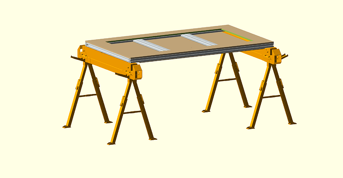

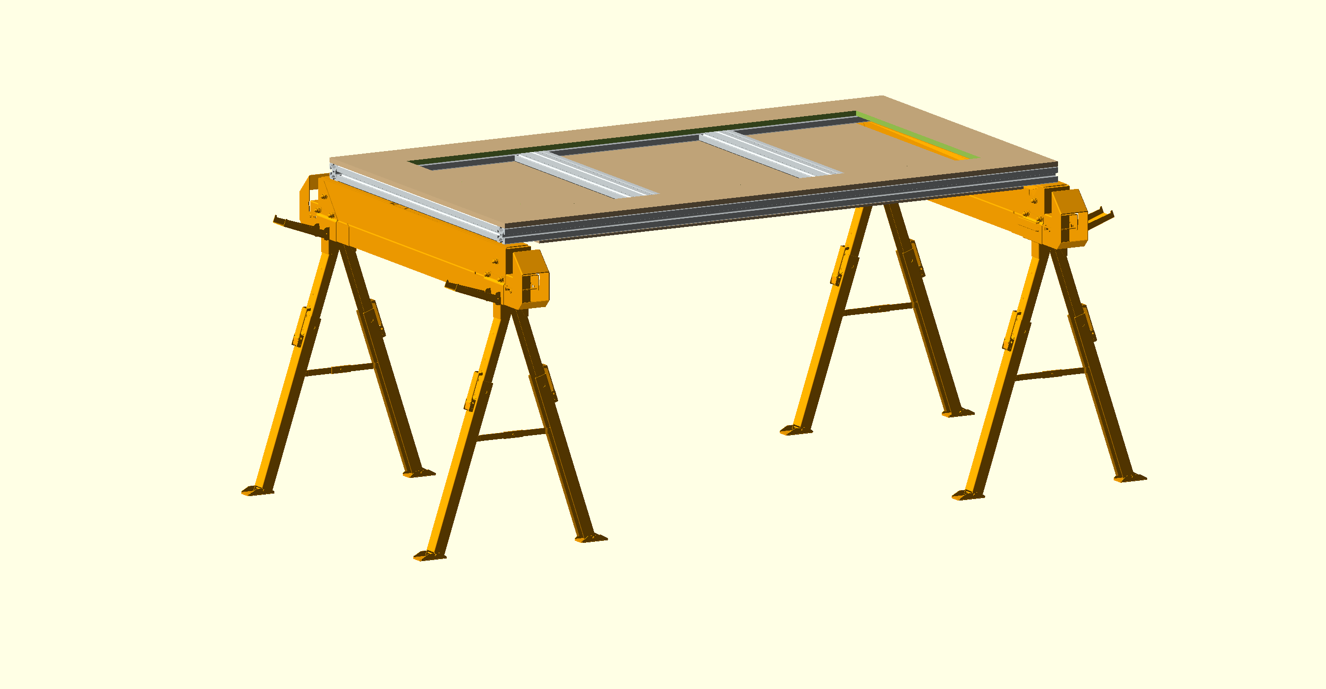

Here’s v2 of my design:

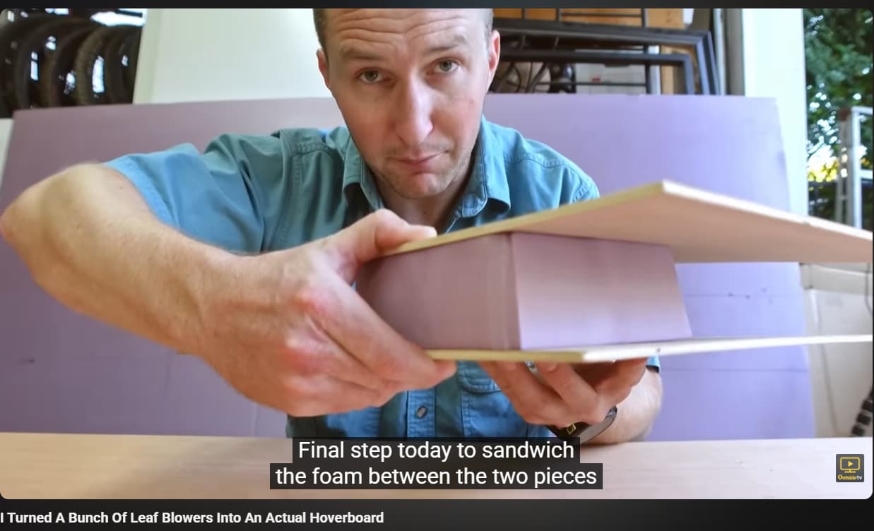

The aluminum extrusion has been replaced with 2” of foam board sandwiched between two 1/4” pieces of plywood (just like in the YouTube video). For a torsion box we also need structure on the sides so I will fill those in with 3/4” plywood strips that go between the top and bottom skins (the right side in the render is omitted to show the foam).
In addition to the 1/4” plywood on top I’ll add 1/2” plywood strips for rail support similar to @marks ‘s design:
I’ll also try securing the spoilboard the same way he did:
The table will no longer be bolted to the sawhorses and instead will be resting on top of them. Will that be OK?

ChatGPT is of the opinion that 2 inches is ideal and any more would provide only diminishing returns.

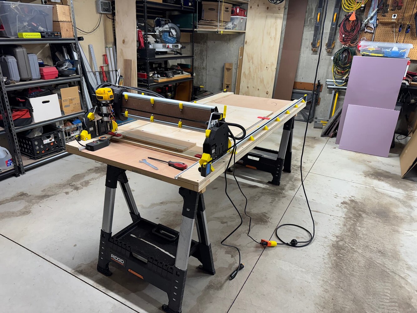

Personally want to run my CNC from truck bed using a lighter surface than my existing plywood+ 2"x4" torsion’sh box. So, am curious if Plywood-XPS sandwich works out for you, am still hoping mech engineers chime in about deflection, and/or suggestions on how to get secure fixture and mounting to the Plywood-XPS sandwich. Bolts and fender washers maybe to avoid crushing? :man_shrugging:

I made a Portable Primo MPCNC, and it is mounted on a very stiff, light torsion box. Below i link a photo album of the making of the torsion box base. Be sure to look at the info captions.
I used 9mm plywood. If I wanted to lift it into a roof box, I would use even thinner plywood, like 6mm or even 3mm laser birch plywood.
Another idea is to look at how surfboards are made. They are very stiff and light: dense foam coated with crossed layers of fiberglass.

ChatGPT thinks a plywood-XPS sandwich would be outstanding for handling deflection.
Regarding the mounting I think the challenge will be similar to the one faced and solved by @marks in his hollow-core door build (LR4 Build in Golden, CO) so I plan to replicate his solution.
