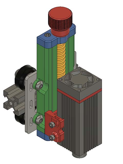

Thought I would start a separate thread for this rather than cluttering up @dkj4linux thread. I started reworking @dkj4linux Manual Z-mechanism to use on the $79 laser engraver. After Amazon messed up my order, I decided to play with this design further to see if it would work better than my current solution of using a short V-Slot 2020 for the Z-axis adjustment on my other projects.
I really like the threading on this as I can use tolerances within Fusion 360 whereas using tolerances with normal threading has been a bit of pain for me. I tend to use openscad for any projects that need threading as thread tolerances are very easy with that. As many folks that use Fusion 360 for plastic 3d printed parts, I still haven’t understood where Autodesk does not have an option for this.

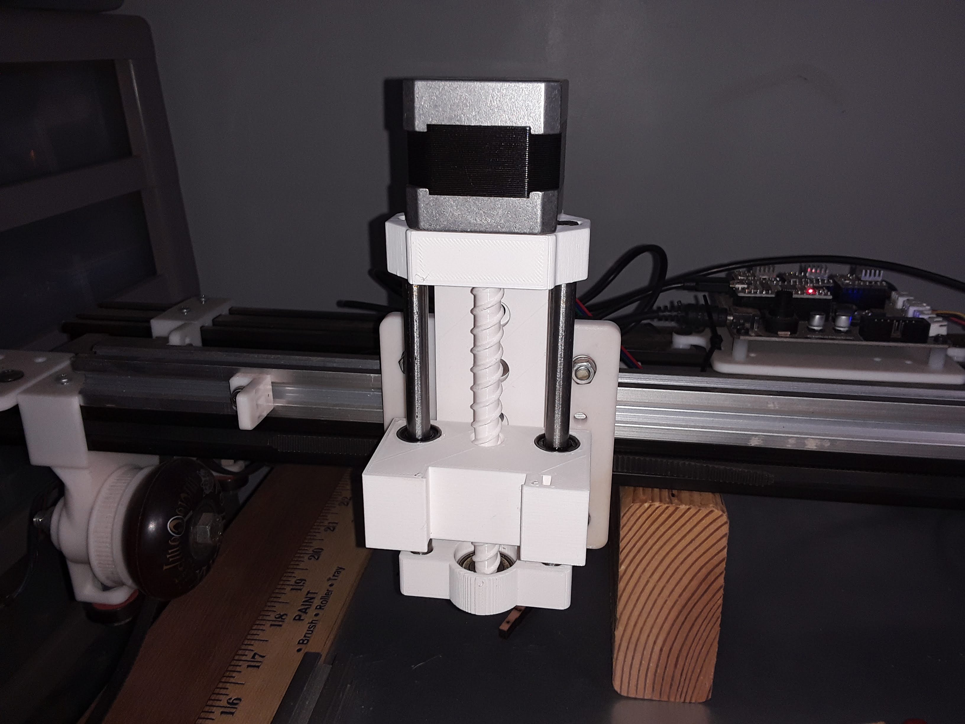

I think there was a previous iteration of this design using a nema17 for a real Z-axis. That might be where I want to go with this design but will probably need to beef it up a little & add some smooth rods. I am mounting it to this V-Slot Gantry Plate - 20mm - OpenBuilds Part Store

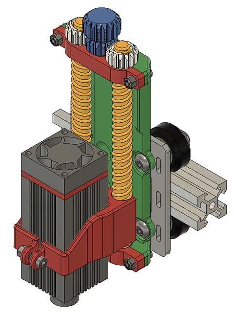

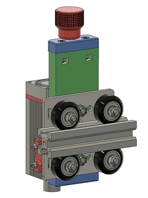

Here is what the design looks like so far. I had to move the laser mount out a couple mms or so for the wire connection. I added nut traps for M3 nuts on the side M3 screws to clamp against the laser. I am not sure I like that method as it seems like it might scar the finish of the laser, but not sure I can mount it from the back as I did before. I will try it like this to start with. I want to take a little more off the bottom of the green part as I loose 8mm Z clearance with that bottom plate. Looks like I have room to move it up some.
I appreciate any thoughts on improving this design.
You may be talking of this one. I did a series of Z-axis mechanisms that started with a motorized version and then “morphed” into the version you’ve been playing with here. It went “manual” when I simply replaced the motor with a printed knob and then started making it as thin as possible…
– David

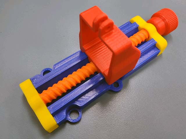

I printed out the parts yesterday. I used different colors for most of the parts mostly to use up the end of some rolls of filament. It came out pretty good but do have a little slop in the 2 side rails. I did test prints on this & was too tight if I used a closer tolerance. My printer does not seem to print as good a tolerance as it used to.

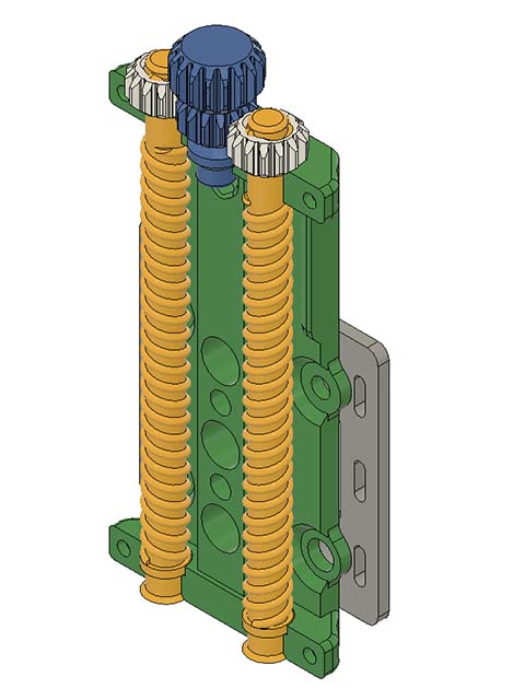

Since the threading on this really feels snug, but moves easily, I am looking at using 2 threaded rods with a gear driving both in the middle like this design. Yet ANOTHER Machine Vise by TheGoofy - Thingiverse

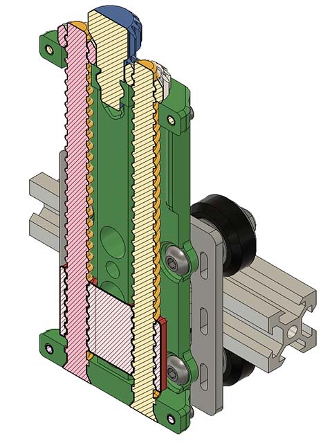

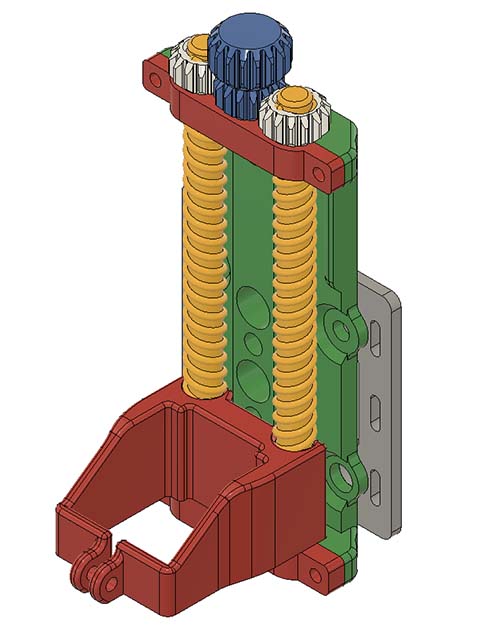

Making some progress on this. I have a little more tweaking before I will be ready to print it. I am trying to get as big a bottom footprint for the threaded shaft as possible, so I want to adjust that a little more. I also had to cut the threading out of the 8mm top bracket, but looking at it again, I should have enough room to cut a bigger hole in there to allow for the treading to go thru it.

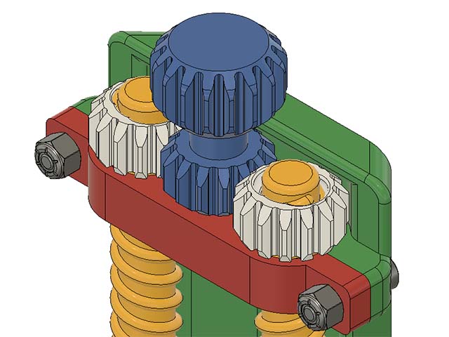

I have it close to test print time. The mount is only 2mm below the metal Gantry now. I opened up holes at top so the threads can be continuous. I originally was putting threads int the top part & then realized it would not turn if I did that. At least I figured that out before printing. I am trying to decide whether I need to constrain those gears at the top. While editing this message, I added a little channel at the top of the green part so at least they won’t pop out easily.
2Gear_Z-Axis_V5b
It looks like you have the threads mirrored for the adjustment mechanism, but with the center gear like that, both screws will rotate in the same direction, so it will not be possible for it to move.
You either need to have the gears on the screws directly mesh with each other, or have both screws the same direction thread.
Of the two, I would probably choose the former, as it simplifies construction, eliminating one rotating axis, and just put the hand knob on top of one of the screws.
Thanks for the comment. I missed the mirroring, luckily that is only on the assembly & not the original print file but will correct that in the assembly.
