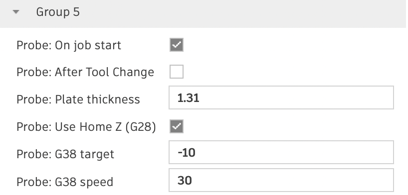

These are my settings in the PP in Fusion 360:
This procedure runs, but the touch plate doesn’t stop the steppers.
The dual LR firmware doesn’t use G28 for the probe. I don’t use fusion, so I don’t know if you can convince it to use G38.2 or not.
IIRC, the command is G38.2 Z0 to make it probe with the Z probe. Otherwise G28 Z goes up and uses the Z endstops, not the probe plugged into zmin
Aha, okey. And this is something that is different from the regular firmware? Because this worked well before I switched to the dual endstop firmware.
Is this how the procedure should look like for dual endstops firmware?
M0 Attach ZProbe
G38.2 Z0 (was G28 Z)
G92 Z1.31
G0 Z40 F300
M400
M0 Detach ZProbe
EDIT: If I run G38.2 Z0 the Z axis goes upwards. Is that correct?
Yes. Because the LR has dual Z and homes up.
It looks about right to me. I haven’t actually done it myself. If you search for G38.2, you will see a bunch of topics on it.
Nope. Does a positive Z move raise the bit? Are you using firmware without editing it? It sounds like you just have the Z motors on backwards.
Yes. If I move the Z axis positive it moves up.
EDIT: Aaah, but sir, maybe I need to seek like this:
G38.2 Z-50 F100
And that way I get the bit to move downward instead. Maybe I had my Z0 above when running it pure like G38.2 Z0. That must be it.
Ok. I think it is common to do a G28 first, which sets the Z to +200mm (the hard coded bed size). So a Z0 should try to point it down. If changing that to Z-50 makes more sense, I will start using that.
