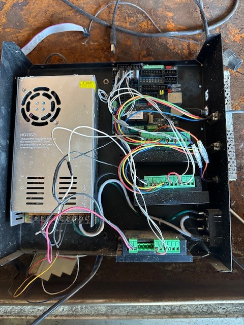

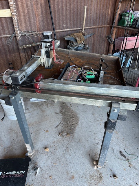

I hope you all can offer me some advice. I apologize in advance if I ask any silly questions; perhaps someone else has encountered similar issues. Here’s my situation: I have an old Langmuir Crossfire CNC table machine that I purchased several years ago from an individual. Unfortunately, he sold it due to software issues. I was able to get it running using Mach3, but it didn’t have a Z-axis.
Recently, I upgraded the machine and added a Z-axis, but I do not want to use the Crossfire controller. The company is local, but I find their software messy and problematic. I’m looking for an open-source alternative that might work better. I noticed that Doug has created a plasma machine with the LR4 CNC, and I would appreciate any advice you might have.

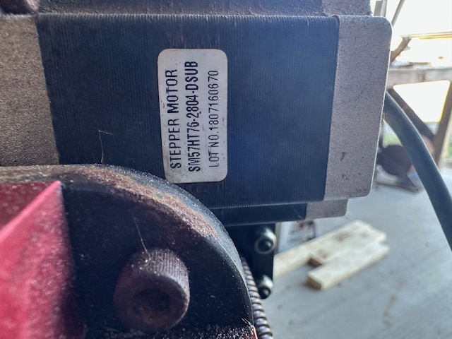

It looks like that machine uses NEMA 23 stepper motors.
I’d be looking at the 6x CNC Controller and some external stepper drivers if FluidNC can be made to work with a plasma setup.

Do you think I will have to replace the controller?
You don’t have to, but if you want to run something other than Mach3/Mach4 (or whatever you’ve got now) you’ll have to.
Personally I’d use it as it works now. It’s going to take a lot of work and knowledge to replace the controller and get back to as much functionality as it has now.

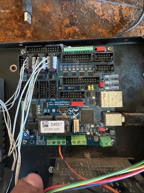

You should be able to get your Z axis working with the PoKeys57CNC controller that it has now. Apparently it supports 8 stepper drivers.
Yes thats what I rather do, I like to run something different will be using open source software and Linux computer etc. I feel that it would be a better choice. I used Mach3, but i was looking at QT plasma C, which is on Linux world if you know what I mean.
I like to completly upgrade this and get away from Mach3 the pokeys57cnc controller
Well, if software is driving your decision, pick your software and then select an appropriate controller that the software supports.

Well I really hope I can find a simple solution for this machine, I want the simplest controller, software etc. and I don’t want to depend on this company anymore, I want my owe open source etc, yall can relate
Plasma control is simple (only hitch is managing electrical interference and plasma on off control) …until you add a Z axis with Torch Height Control, then it gets very complicated fast.
