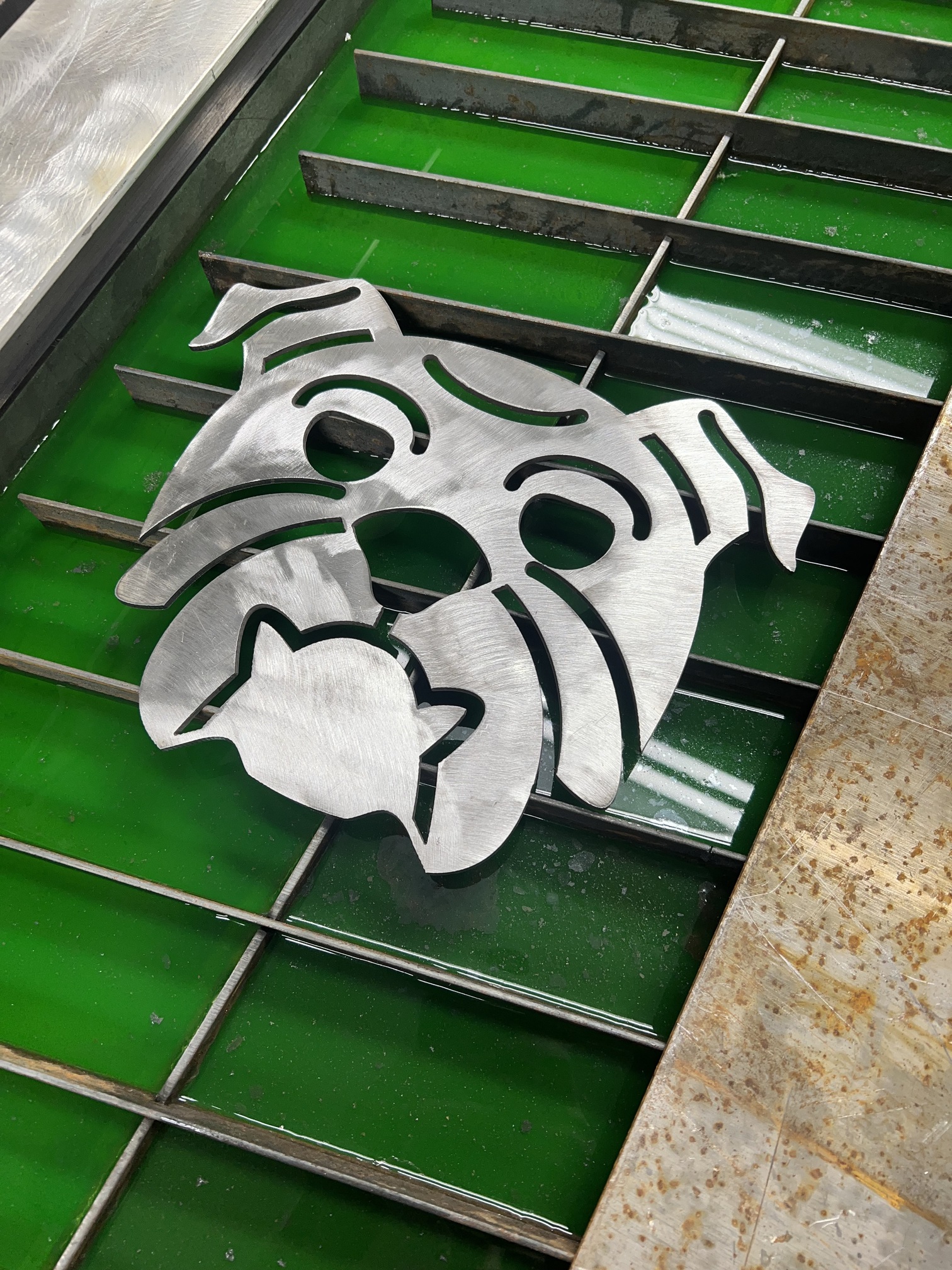

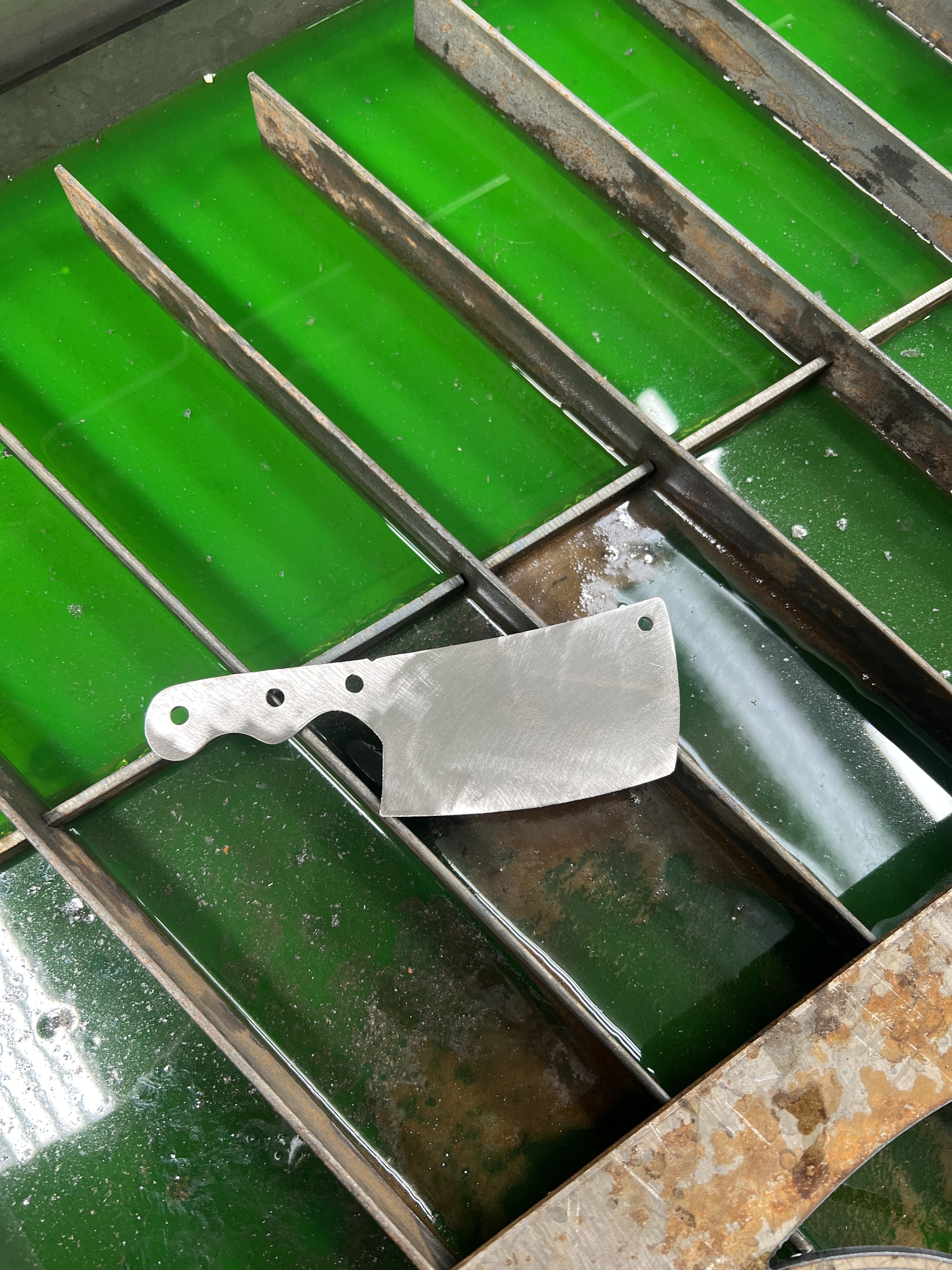

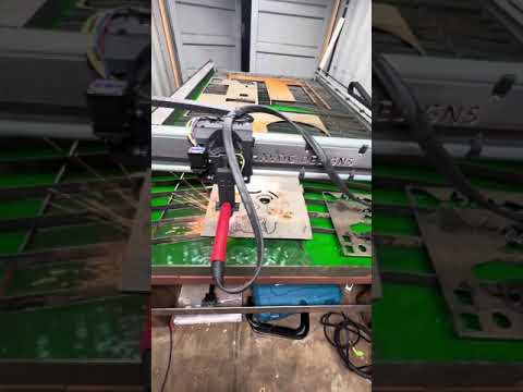

Plasma LR4 in action
Got some time tonight to video some initial testing on 10ga hr steel plate but can’t figure out how to upload video check the v1 engineering Facebook group to see the video

What controller, software stack you using?
Man, that thing is fast. Luckily I don’t have any more space or I’d be tempted. :yum:
Myplasm cnc with thc… stepperonline dm542ts x and y set to 1amp 1600 z axis both motors go to one driver set to 2 amps 400 ms powered by 24v 350 meanwell with
