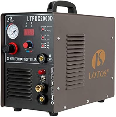

Amazon has a 3 in one right now, pilot arc plasma, stick and tig. I understand that this sort of tig welding isn’t ideal but I think I might give it a try with this machine. It is inexpensive and for the amount of times I will use it in any given year I am sure it will be good enough. The only “bad” thing I can find is its consumables are kind of proprietary and it goes through them quickly, but if I switch out the “gun” for a pen style plasma torch I hope that will help both of those. Add a foot pedal and maybe have a decent functional scrape start tig welder?
I’ve had my eye on that unit after seeing it in another thread. If only I wasn’t a college student. The plasma cutter I use at school is the biggest Lincoln Electric model you can get before making a huge step up to industrial stuff (well, as of a few years ago). It is total overkill though. The only real benefit is that it can cut 3/4" steel and the duty cycle is pretty long. The only cut that I’ve done that exceeded the duty cycle was a sign that was nearly a half hour of straight cutting. Getting that unit and switching to a different torch, even a cheap Chinese one with more common consumables, isn’t a bad idea. One thing to keep in mind is that the Hypertherm units have drag cutting so the tip can directly touch the material and not be a dead short.
No idea on what to say about the welding functionality since I have no experience in welding. I’ve tried to learn a lot online so that I might have better luck when the time comes to try it out. We just got a Square Wave TIG 200 and it is supposed to be an absolute dream to work with but the guys on the baja team stick to their trusty old Miller.
That Lotos is a decent machine as far as the China made ones go. The torch model is a PCON40 EDIT: SG-55 (just some conflicting reports) and the consumables are sold in sets of 40 for around $100 EDIT: 80 pcs for ~$50. They are nickel or nickel plated, so they should last quite a bit longer. LOTOS is the brand that all of the other copycat Chinese machines are based off of, so they are at least leader of the pack. The only thing I remember hearing about them is that they are MOSFET driven and not IGBT, which isn’t optimal, but if you aren’t running it for 6+ hours every day, it shouldn’t matter… unless it puts out the blue smoke on the first few uses lol

The accepted industry term is scratch start. If you aren’t using a pedal, you’re doing scratch start (you strike the tungsten tip like a match to start the arc, or just like you were starting an arc for a stick welder) TIG welding, if you do have a pedal, it’s lift start (tungsten tip to the work piece with no juice and as you depress the pedal, you lift the electrode to create an arc). I believe that unit does have a connection for a foot pedal but doesn’t come with one. I’d suggest making a foot pedal so that you can do lift start if you want to learn to TIG without HF. This welding discussion is probably better served in a different topic on the forum though because there is a ton of stuff you can do with these cheap welders. I added an adjustable frequency PWM flip-flop circuit to mine almost immediately after I got it so that I could weld copper.
