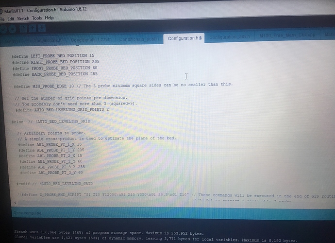

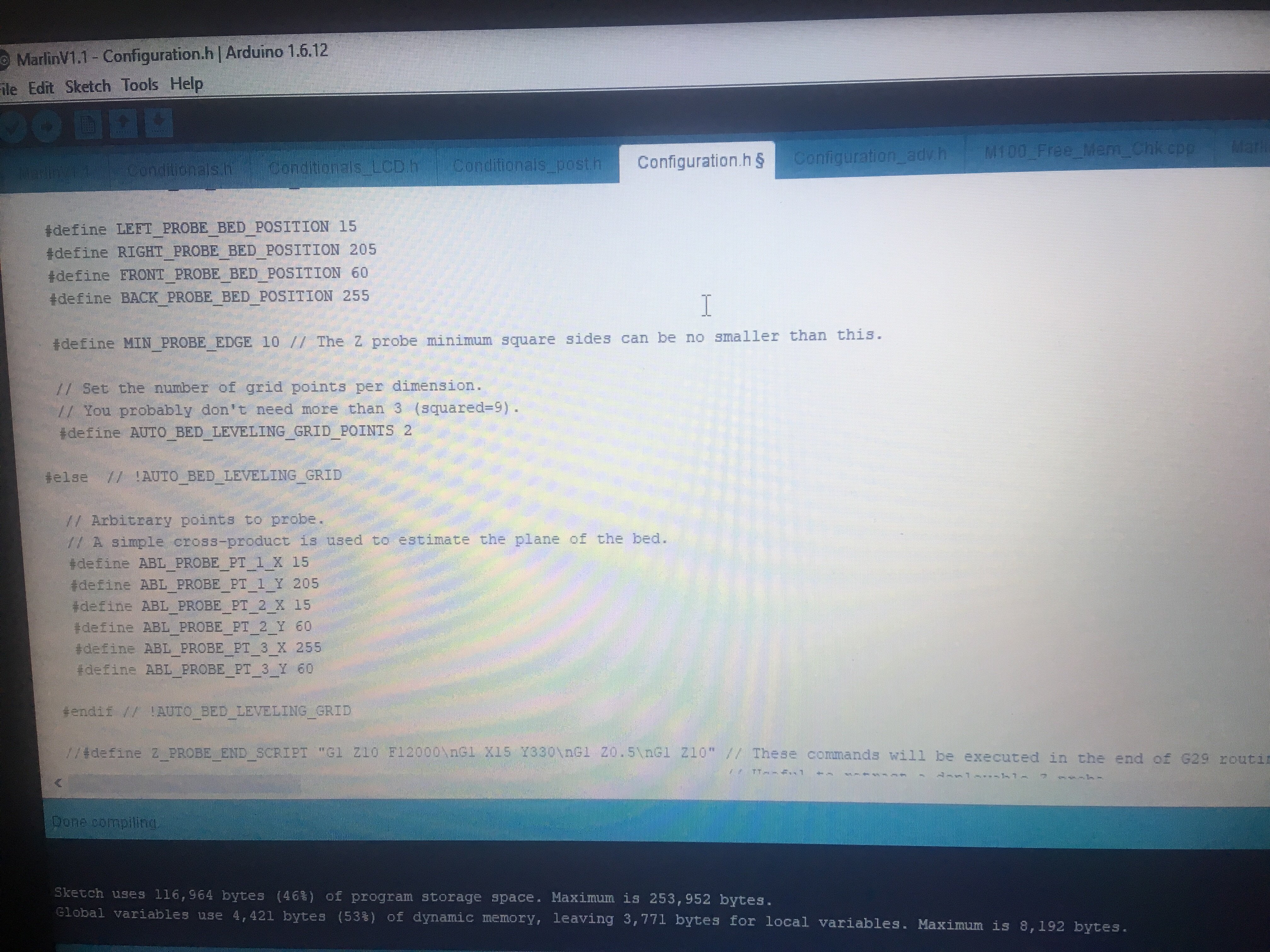

How accurate does my printer need to be for these parts. BYW, I’m not great at figuring out code and this was my first flash of Marlin RC7, since I’ve flashed a few more times with different z offsets trying to get it to print the first layer right. I wrote some measurements into the bed leveling of Marlin that I may have gotten the wrong.

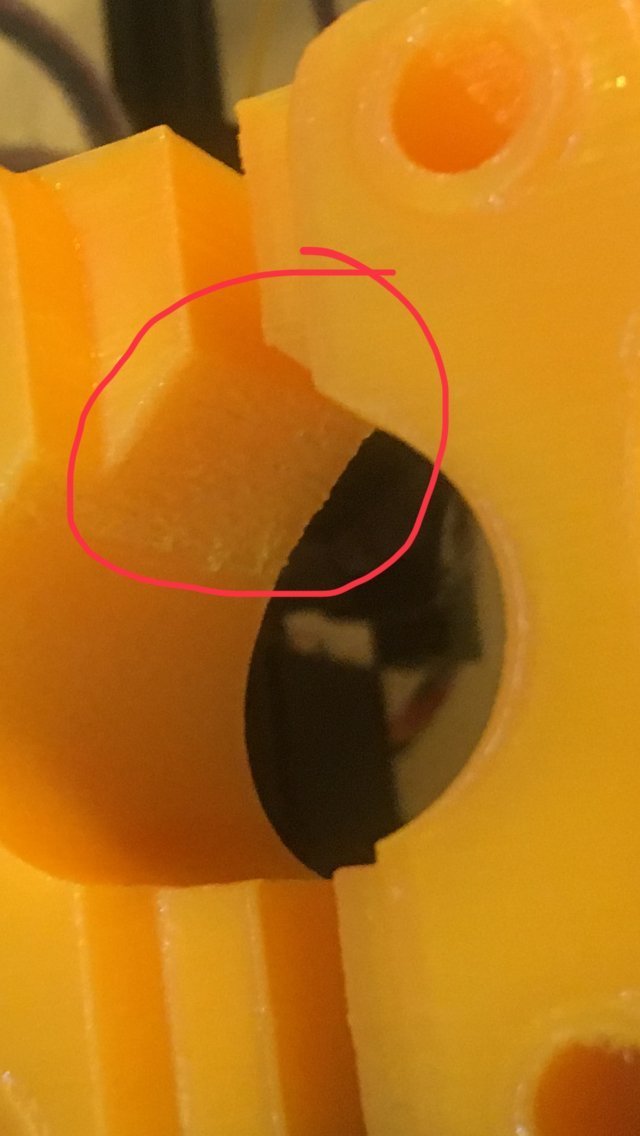

Overall dimensions are close, just a little off. One way or another, not consistently larger or smaller. So I think my mm per steps are on. Microsteping seems to me to be inaccurate. Anyway I started printing mpcnc parts. I seem to have some problems with overhangs curling up. Only on the right side though. I added more cooling fan, that seemed to make it worse. If anybody has a good easy to follow guide on how to calibrate your printer I’d be interested. Now that I am ready to start putting it together, the kit has gone oos. I searched for when it would be back in stock, and saw your replies that. Shipments were held up with no definitive date. I was thinking of going with the achiem board, am I correct that it will do the Dual Endstop/firmware? I’ll want to go to that later. And are you just oos on the steppers for the kits. If so what would it cost me for a Archim board in a kit with dual and series wiring, without the steppers and anything else oos?
While printing PLA? What temperature are you printing at?
But last time I was printing with 220°C, I had the fan on. I was still having the curling a problem in fact it was worse. Last night I was printing a pair of the rollers and I was watching and I thought it looked like it printed significantly better this time. I also have a enclosure around it this time to increase the ambient temperature.

I’d stop trying with ABS (I hope you weren’t trying that at 220C). At this point, that’s an advanced filament (because you need to really dial everything in. feed rate, nozzle temp, ambient temperature). PLA is much, much easier. Get those right first.
And then 220C is really a bit too hot for PLA, try 210 with some cooling after the first couple layers and keep your heat bed around 60C and. If your printer is in a cold place… you need room temperature for PLA to print nicely. I’m running my Prusa mk3 in a semi enclosure, ambient temperature in the enclosure is about 35-40C. This yields strong, good looking parts.
This print curled too, I just can’t see that kind of detail in the enclosure. I’ll probably be lowering the print temp next to see if that works. I am using PLA here. It is the first time I’ve been running this filament, it is supposed to be a better filiment. I do run it hot. My old filament would have layer adhesion issues running below 210°C , I’m just used to running hot. I’ll run a test at 210.
Thank you for the picture. Keep posting them. Because that looks over-extruded (using too much plastic). 210C and start by lowering the amount of plastic you’re using. Either by lowering the extrusion multiplier (try 0.95 for 95%) or measuring your filament diameter and adjusting that in the slicer or adjusting the extruder mm per step.

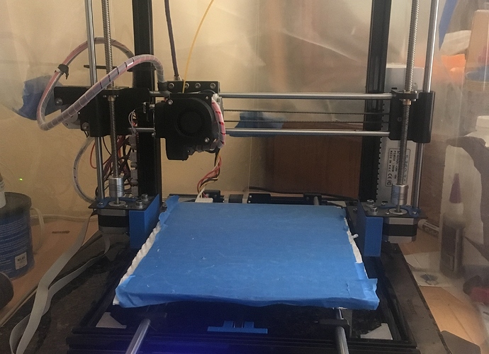

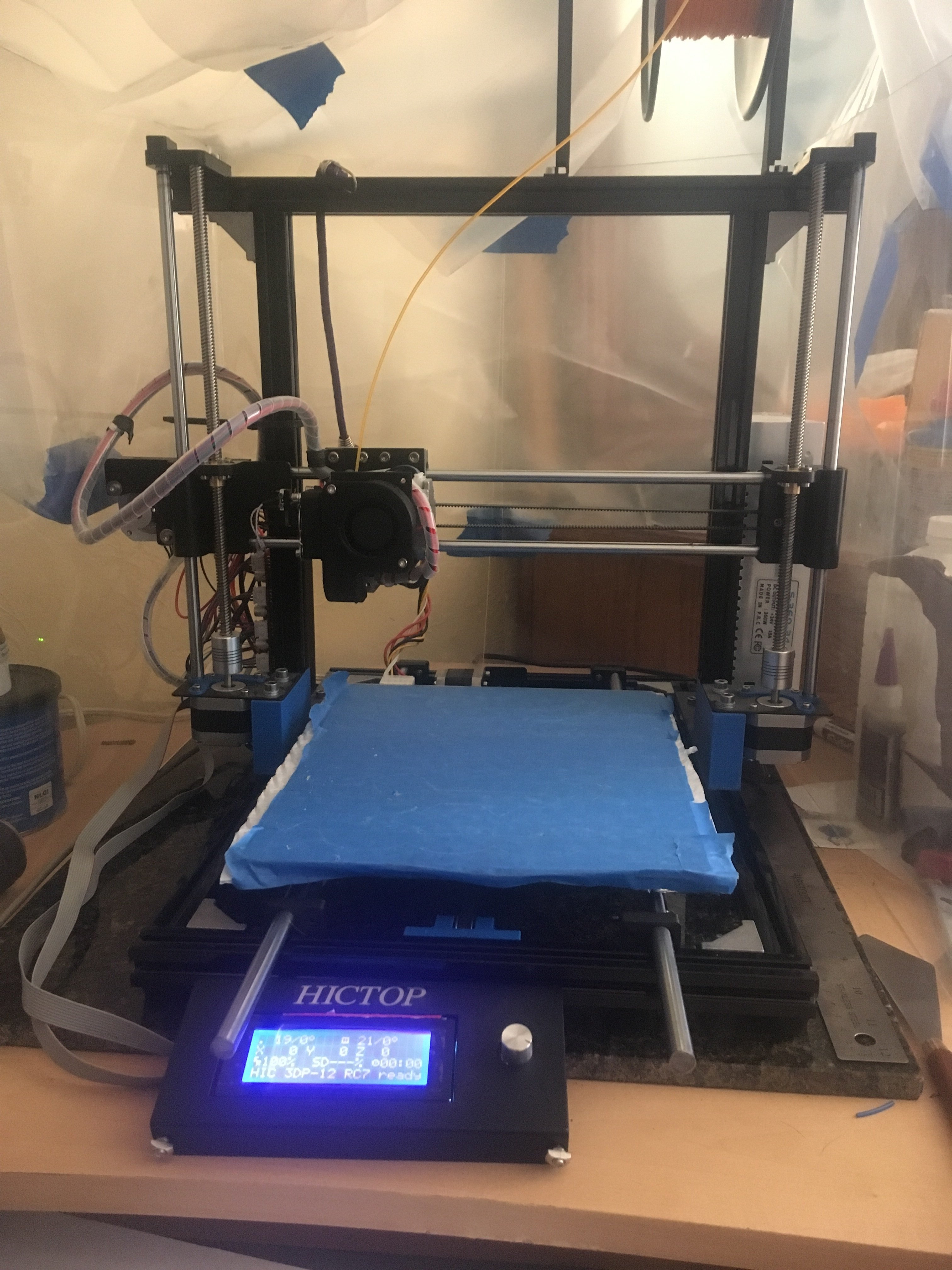

What printer do you have?
I know you just want to build, but do yourself the favour of getting your 3D prints really nice. Print benchy http://www.3dbenchy.com until you get it to look nice and clean. Measure it until the dimensions are spot on. That way, there will be very, very little to adjust to square your MPCNC. Without adjustment, my 70x90 cm frame was square to within 1.5 mm, my middle assembly XY came out at about 1 or 2 degrees of perpendicular. I had trouble measuring them. My prints are very clean.
“I do have a hictop 3dp-12, I built and that I have recently flashed with Marlin RC7, (I had to check). I’ve only printed PLA and ABS so far.” I have checked my filiment and it was 1.75 in enough spots, I just left that alone, I’ll check again at lunch. This is new filiment.
I got 1.74, 1.74,1.73 & 1.74 E steps per mm are at 94.4, I run 55*C bed temp. It’s some kind of Prusa clone, I’m not sure which, ramps 1.4, 24v PS, modified w 10mm y rods and 50 mm of z lift for that much more z height.
