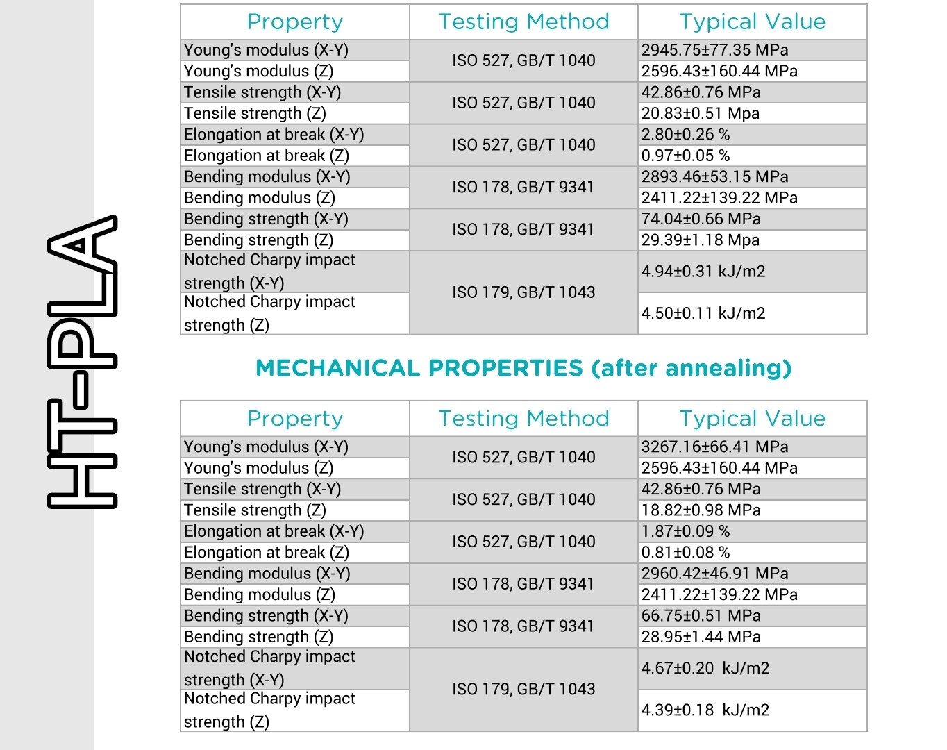

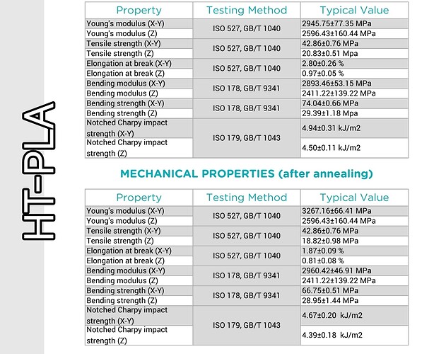

Hi
Polymaker offering HT-PLA now, it’s seems to be quite a good choice for my Lowrider Built.
Can anyone recommend it, somebody who already used it?
Or should I go for PLA+?
Just normal PLA. Do not use PLA+. If you want it fancy, PET-CF (not PETG-CF).
Agreed. PLA is ~48MPa in tesile strength in XY, VS ~43 MPa for this stuff.
Aside this, doesn’t HT-PLA shrink when you anneal it?
I’d avoid it like the plague.
If you need heat resistance, PET-CF.
I wanna thank you guys very much.
PLA it will be.
Watching out for ~48MPa+ Tensile Strength…
