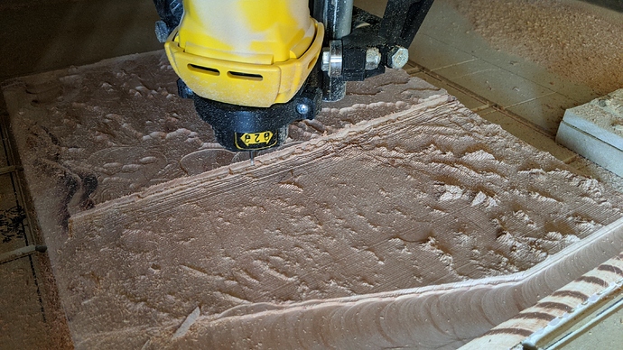

Hi there Friends, I’m sure many of you already know that PLA can heat deform , but I have fun proof of that from here in sunny Phoenix. I’ve been itching to take on a major project but the heat here is so oppressive. I pushed on anyways. Wrong Choice.
the project is full topography carve of Arizona. I already did a smaller proof of concept in MDF, but was ready to create the larger model in cherry. After a successful surface plane, rough cut, and semi-detail cut, I was ready for the 1/16" final cut.

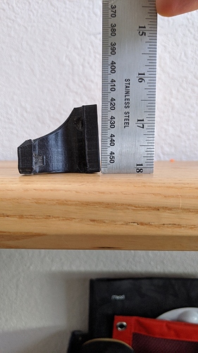

this was a 4 hour job, and even though I started in the morning, the heat grew and grew. I ended up with Stepper motors reading at 165… I later learned that PLA can deform at 140… oops.
this caused same pretty major leaning/bending on the stepper mounts, but they continued to work.

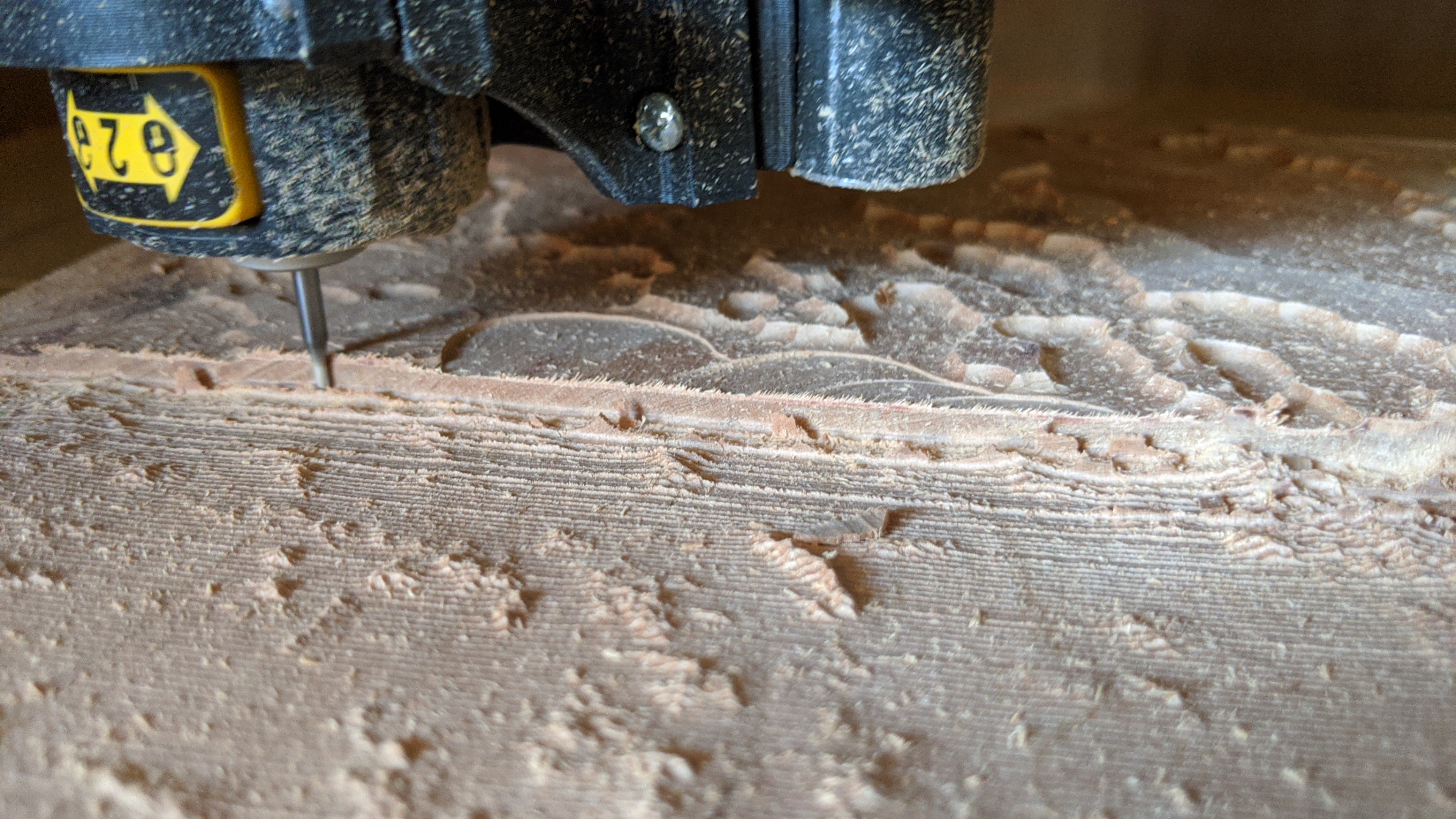

However, the Z-axis carriage started to sag, and it really changed the accuracy of the toolhead. It began dipping farther and farther into the wood and exceeding the recommended chip-load. Cuts got wonky, the project was ruined…
So now I’m trying to upgrade to Primo, but 23.5 isn’t out yet, so I’m reprinting these parts in PETG to see how they do.
