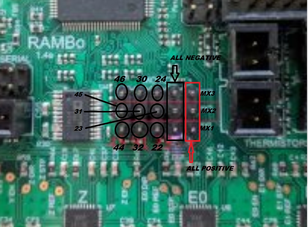

Pins for rambo 1.4 cnc coolant
I just finished my build and it’s working great! I searched a lot (here and elsewhere) to find the pins for coolant and flood (which i’m using for vacuum and air) but, in the end, just traced them myself. I updated the pic from here with the additional pins labeled. Sorry if my searching ability sucks and this is already posted here somewhere. you can edit which pins do what in the rambo_pins.h
can’t attach a link so i guess just pm me for the link
Here is the image that @redghost1997 was not able to post:
And thank you redghost1997.
