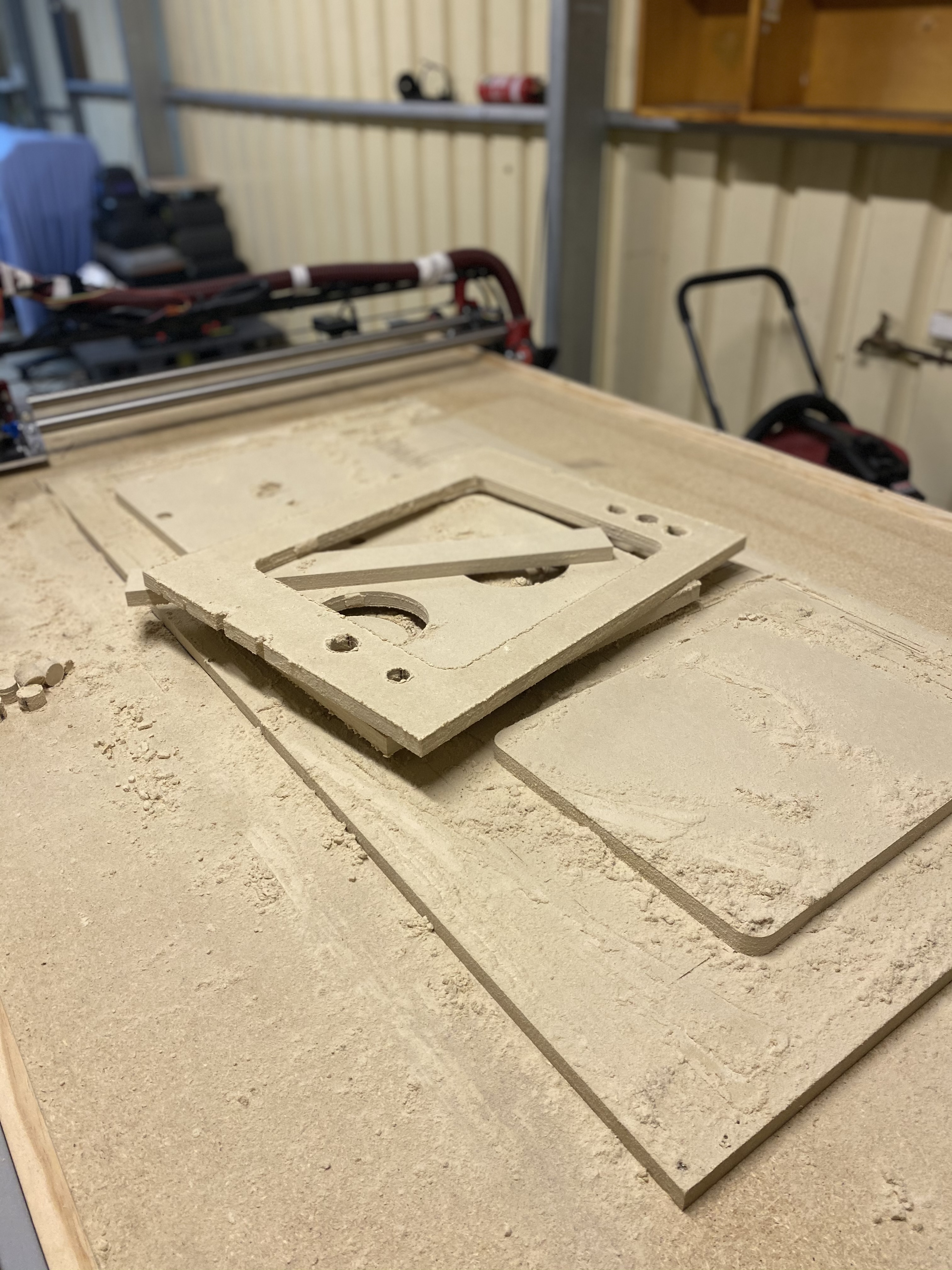

Next up is a pinball I designed using cam and locks for flat pack style furniture. Pockets and what not, a lot of precision and accuracy required. My build is on a unistrut style table and it’s quite flat plus hard stops on each end and no end stops at the moment. My workflow currently enjoys simplicity :joy:

To give an idea of precision achieved. Look at the cam lock placements. They can’t be out by a mm and pockets have to be exact z depth as well. In this render they look through profiles but they are actually pockets.
Ok this finished one for a mate is based on fan art. Cut using the low rider. 7 hours of cutting including pocketed screens that neatly fit. Most time as you would have figured are these large pockets.
