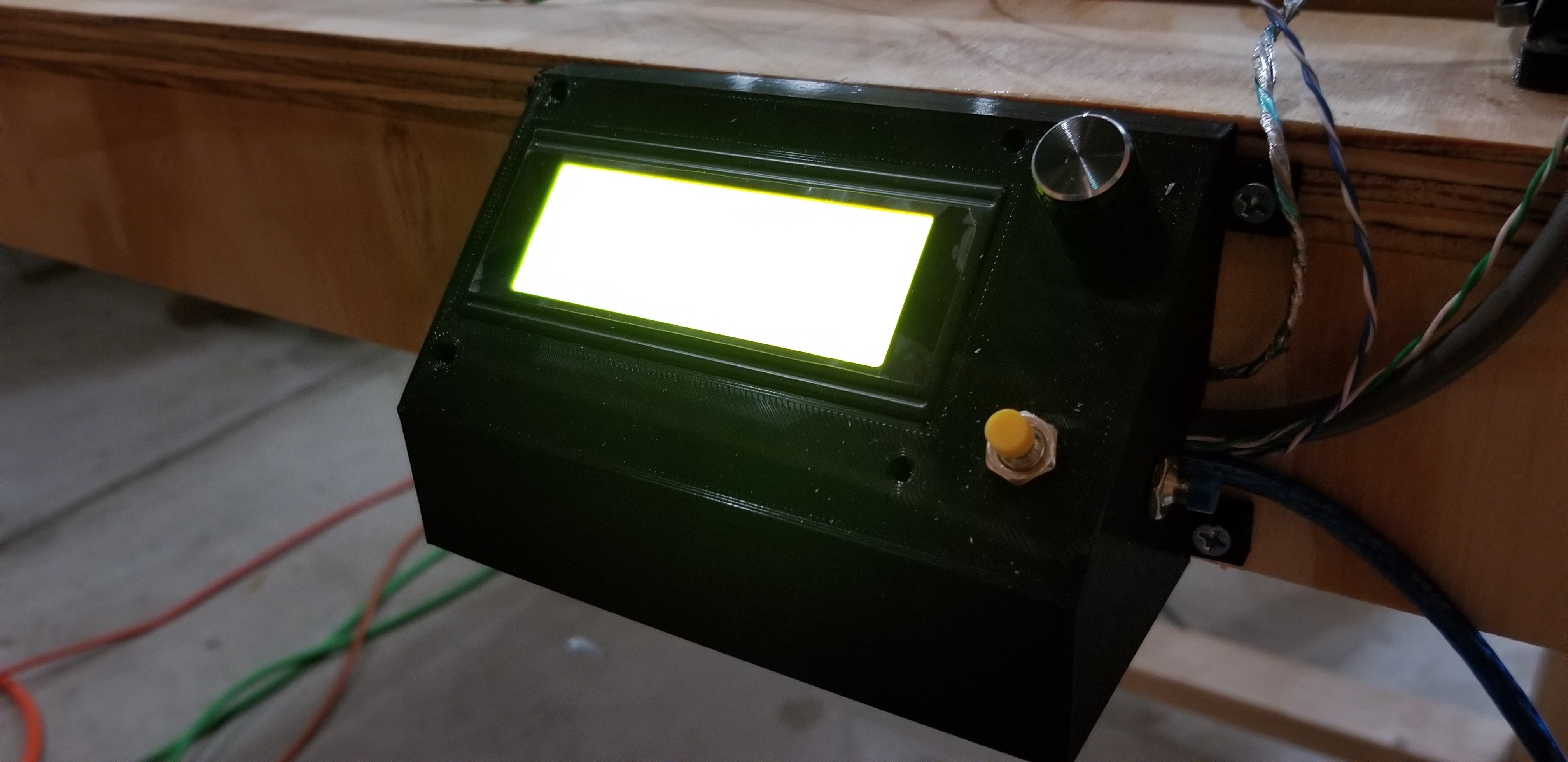

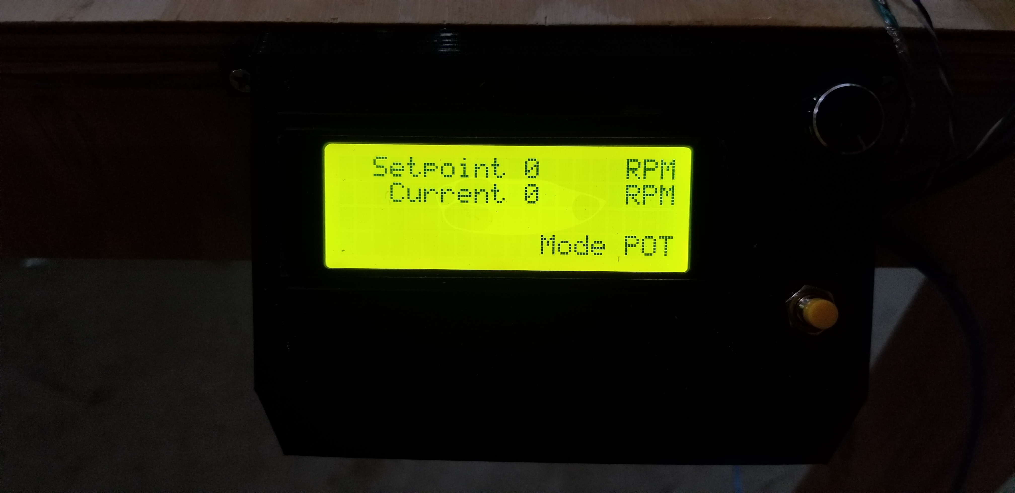

Would just like to share progress on my PID install!
Having a lot of fun with this thing. Added ability to switch from Off, to Potentiometer input, to Marlin input. Still a work in progress, especially with finishing up the look of the LCD.
Side button will switch input modes.
Front button will read and update potentiometer reading. This way you can accidentally turn the knob and eliminates any noise issues.
Heck yes!
Are you using the nano circuit board yhats no longer available in the V1 store? Ive just received the developer kit and wondering if i should get one made.
I made one on perf board. I needed additional inputs for the buttons and the POT anyhow.
Thanks.
Are you posting the software somewhere? Looks great.
Thanks!
I was planning to finish tweaking and working out any bugs but I can share it as is if you’d like. I’m far from a professional coder so its definitely not pretty.
Sounds good to me. Just don’t forget. I frequently think, ā€œI’ll just do one more thingā€ and them lose track and never share. Someone has to be really rude to criticize open software (they will be rude, but you can ignore them).
How critical is it to include a screen in the PID itself? I’m planning to use a grbl cnc shield and the V1pi image to run the MPCNC. Will that allow me to display actual rpms through the browser interface?
Not the actual rpms, but I think it shows the set point.
