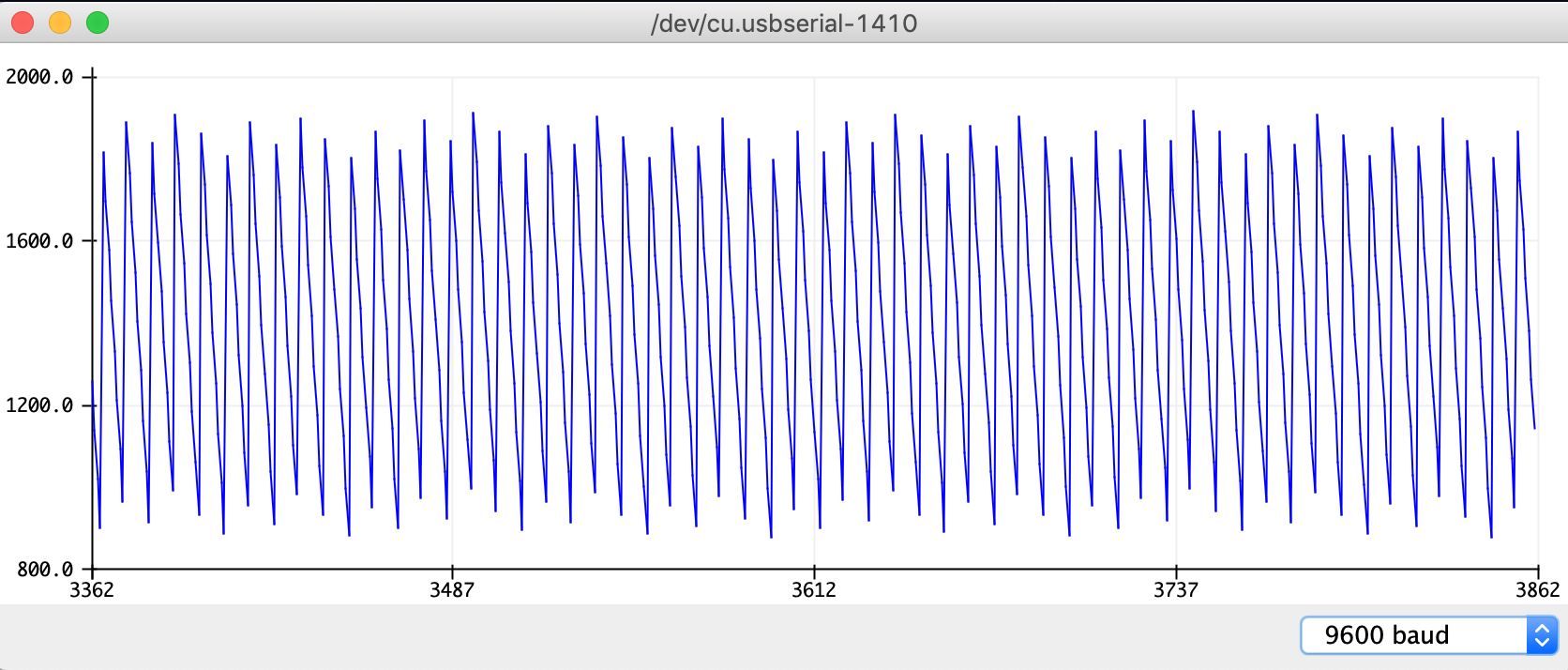

Hey guys,
Diving into this stuff as someone who was completely clueless about electronics/controllers/etc… going into it. AAAnd lost too much sleep the past few nights trying to figure it all out. :slight_smile:
I’ve had success doing ā€œdumbā€ AC dimmer control just using an Arduino sketch to control the PWM output values. Now trying to get the communication with the rambo board working properly before adding in the sensor/PID. I enabled everything in the Rambo firmware and have combed through that over and over and I’m pretty sure everything there is right.

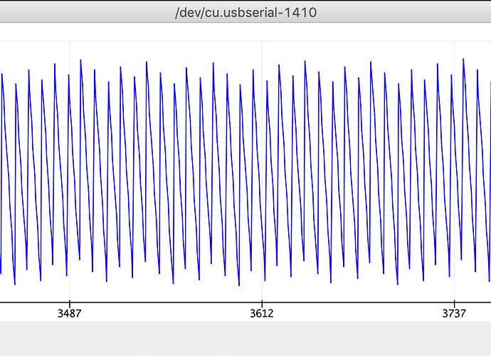

I have mine wired just as Ryan has shown in some of the forum posts (albeit this is just hooked up on a breadboard for now). Using the 45 Pin for PWM and 31 for enable to Nano pins 3 and 5, respectively. My enable pin is working as expected with M3/M5 commands, but for some reason, the input signal doesn’t seem to be working correctly. I get the same response to my Nano regardless of the spindle value I enter (ie M3 S10000/S20000/S30000). I attached a screenshot of the serial plotter using the debug line in the Github code:
Serial.println(pwm_value); // For debugging the PWM MAP
I’m basically just running the code off of the Github but disabled the PID portion for now, and am not even worrying about outputs until I’m convinced that I have a good input signal.
One thing also that may or may not be affecting this: should I be ā€œbridgingā€ grounds between my Rambo and Nano circuits? Not sure if that matters or not. Is that what the 3rd wire is in Ryan’s picture on pg. 6 of this thread?
Ā
Thanks in advance! This project is trying so far to say the least but still a lot of fun
Minor update:
Tried simplifying it down to just use a pulseIn to read the Rambo input and figured out that if I issue:
ā€œM3 Oxxxā€ where xxx = value 0-255, the signal works perfectly.
No success whatsoever with using M3 Sxxxxx commands. It just automatically sets it at a PWM value corresponding to ~213 (of 255).
I’ve been reading through the Marlin code trying to figure out what might be causing this, but I think it’s a bit over my head…I guess for now I’ll just use the O command. Would really appreciate some feedback if anyone has had a similar issue.
A few pages in you can see the part of marlin that gets edited, you input your routers max RPM and then just use the RPM you desire not the PWM value,
