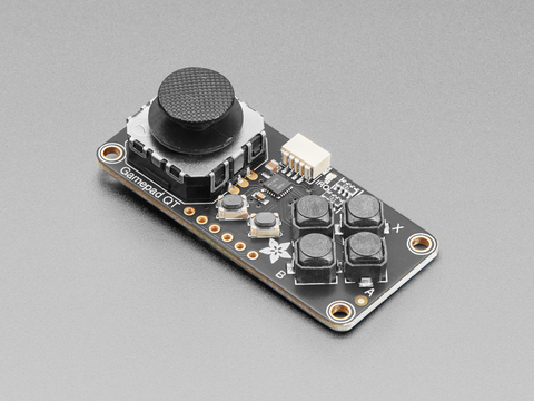

Adafruit do a product of the week Livestream with 50% discount for a specific product (Tues 1pm - ~1:45pm PST). This week’s stream starts in ~20mins and features an I2C based game pad inspired board with 2 axis analog and 6 buttons. You’ll pay more for shipping than the $3.75 this’ll cost, but people usually end up adding other stuff to their cart, e.g. ESP32 QT Py, stemma qt cable, maybe a rotary dial even…
Edit: Bought a couple, together with simple I2C Hub, and a multiplexer hub. Have a few projects these will be helpful for, just need the time to use them… Already have Adafruit ANO Rotary Navigation Encoder Breakout PCB and ANO Directional Navigation and Scroll Wheel Rotary Encoder from an earlier product stream (2022-5-24). Planning to connect up to ESP32…
That gamepad could maybe potentially fit on the I2C lines in place of the OLED, if 19 buttons were not enough. And then just software to use it.

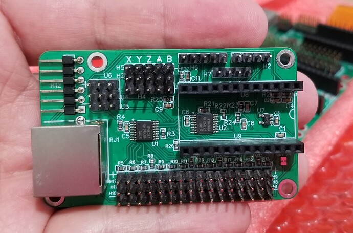

My custom pendant boards from JLCPCB are supposed to arrive the day after tomorrow (Thursday)! :tada:
And then starting Saturday and through next week I’m taking some time off, and theoretically I will have extra time to work on my projects.
I have in my hands a joystick, handwheel, buttons, toggle switches, analog knobs, rotary switches, and OLED (all from Amazon) ready to go.
I don’t have a FluidNC board yet, but still plenty to do.
What’s your limitation with using a gamepad and the OLED together?
I have a few to spare.
It’s the crossover episode we all want to see!
No limitation except that I hadn’t thought of it. The gamepads have up to 4 configurable addresses so I suppose that means 4 game pads and an OLED can all be connected at the same time.
It’s also just a microcontroller acting as an I2C slave so could easily be expanded on to change the addressing or add additional ways of signaling address values if you wanted to go beyond 4 gamepads for some reason while keeping it compatible with the other Adafruit messaging stuff etc.

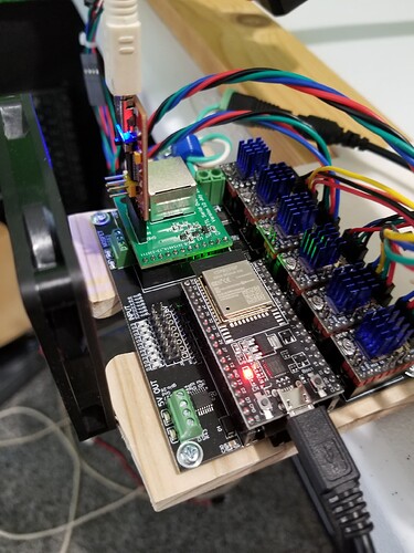

Expansion board in place with usb-serial ftdi installed.
Slight update to yaml file:
uart2:
  txd_pin: gpio.13
  rxd_pin: gpio.14
  rts_pin: NO_PIN
  baud: 115200
  mode: 8N1
uart_channel1:
  uart_num: 2

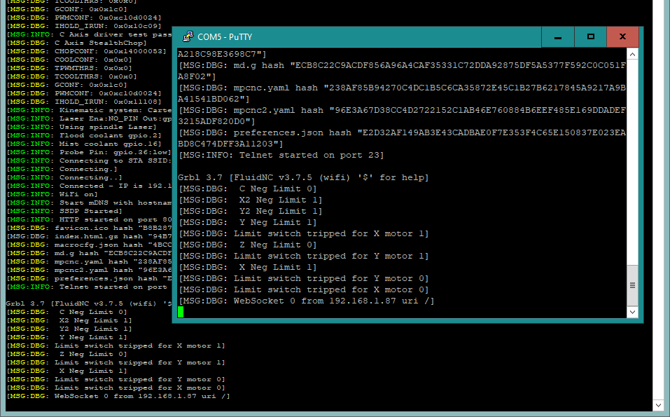

And now on boot COM5 is showing the same outputs as FluidTerm:
Also I can type commands on COM5 and it responds like the console should.
There is no reason this shouldn’t work, except for all the unknown unknowns (for me). Maybe a small victory but I’ll take it!

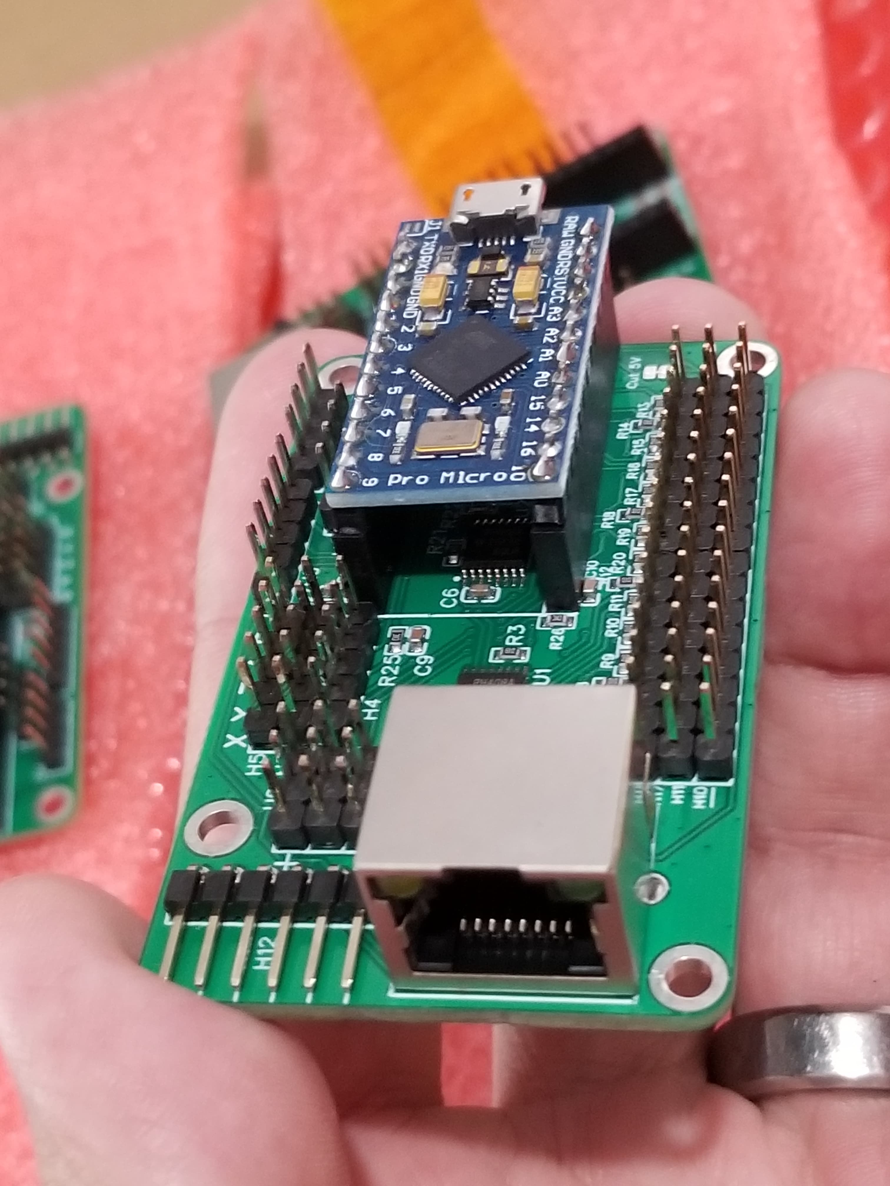

This should answer @SupraGuy 's question. My board is translating 3.3v from the ESP32 to 5V logic.
I can’t figure out if the TFT35 is expecting 5V or 3.3V over the RX and TX lines. Maybe it is 5V tolerant and sends back 3.3V, in which case a little pigtail would be all that’s needed hardware-wise to connect the TFT into the expansion port. The bigger problem is that the TFT firmware is not going to speak the right flavor of gcode so there will be a fair bit of software work to get the screen to work with FluidNC.
