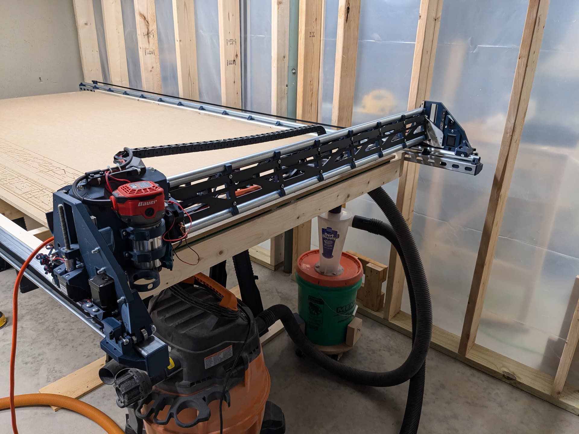

I’ve gotten 2 struts cut so far and they measure as close to the right dimensions as I can measure with just a tape measure. Seems like it’s just a slight inaccuracy cause by the cut. I am using conventional milling for now. I figured it’s working well enough, don’t change anything and just cut the struts. I’ll reassess after reassembly.
All the strut plates were cut, painted, and installed. I did have some trouble getting the struts on. I had to loosen the whole system to get the holes all aligned with the bolt holes. I tried my best to avoid any twist when putting things on and I think I managed ok.

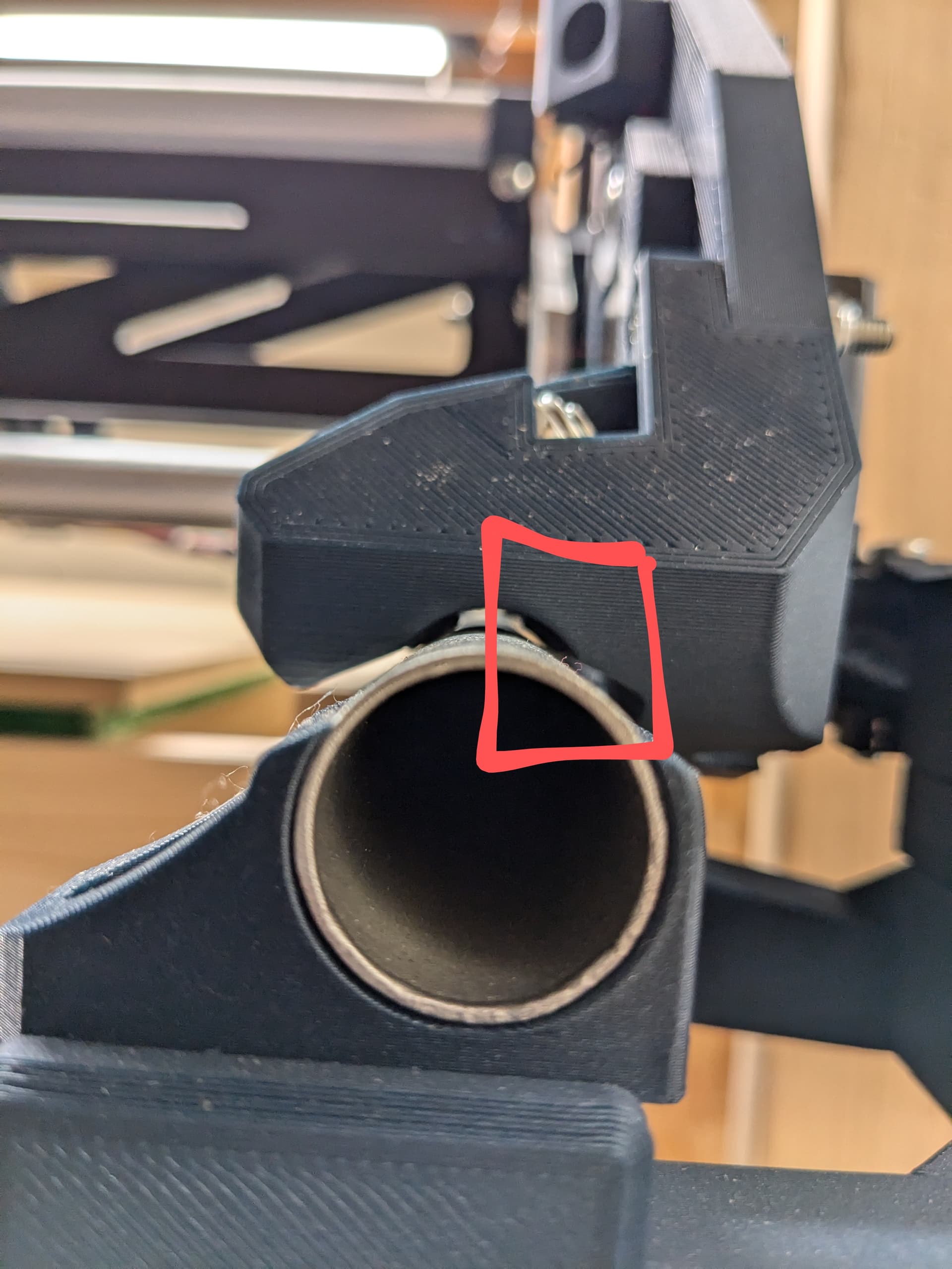

I put the system back on the rails and measured heel/toe distances before putting the y belt tensioners on and everything looked good. Once I put the belts back on and homed everything the rail side was not sitting correctly on the conduit. There is a small gap where one bearing isn’t making contact.
I haven’t done a squareness test yet so I’m hoping that reveals the pull back is a little bit off and then that hopefully fixes it. If not, I suppose I’ll be back here asking about it.
